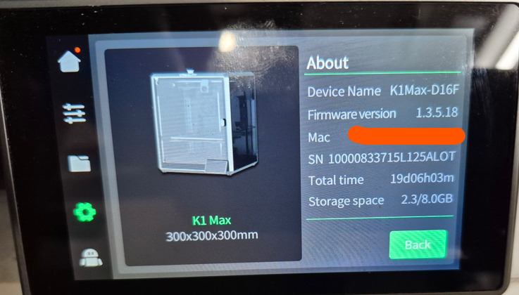

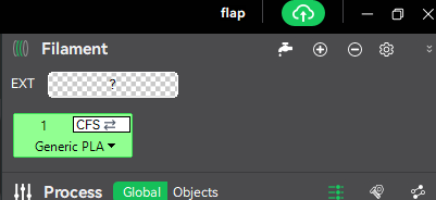

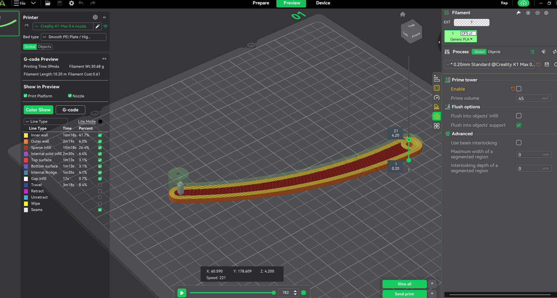

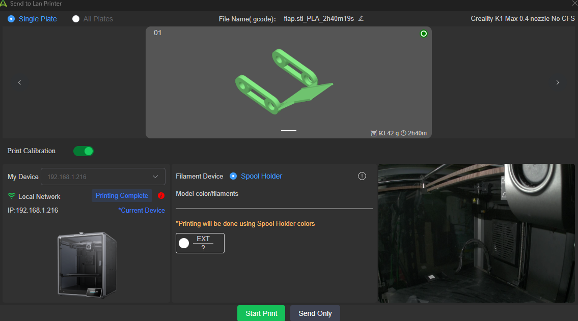

I updated my pinter software (on printer). Now Creality Print thinks I have a CFS. The Filement selection only shows CFS. In “Multifilament” even with Prime Tower disabled still does not change filement CFS. Then, even going with that and slicing, then whn you export there is no option with Filement Device…and yes it says “Spool Hoder” but because the filement before sslicing was CFS it runs with “Printing will be done using Spool Holder Colors” meaning not “External Spool Holder” but CFS…

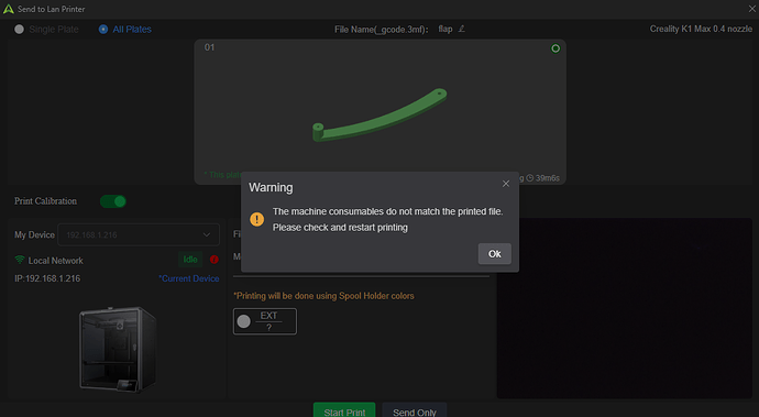

Then when you try to go ahead it comes up with a Warning: “ The machine consumables do not match the print file. Please check and restart printing”.

Hi. I had exactly the same issue when I accepted an update to my K1 Max profile in Creality Print. I fixed it by uninstalling the Creality Print app and reinstalling. Hope this helps.
