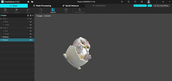

Hi Again, this is the screen of the scanning software and how i am trying to export it, I use the little small blue round button to export direct to creality print,
