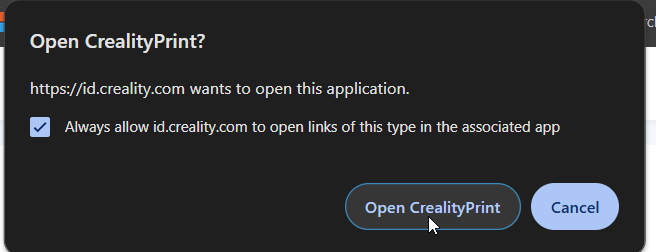

This time, when I logged into my account online, I received a pop-up advising that the website wanted to open the Creality Print 6 app.
Initially, it took so long to connect that I thought I had failed. However, it had logged me in.
