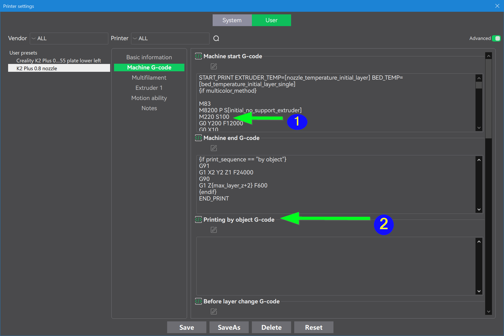

I haven’t experimented in a while but I did have marginal success with modifying the machine G-code and inserting the m220 override there and save the machine profile as your default. I changed it to M220 S50which is 50% speed. But truth be told, upon upgrading my Orca, it seems to work randomly but in fairness, I did not do a lot of testing.
Note: G-code edits can mess up your machine if you’re not comfortable with G-code editing but this is a simple experiment. You may also have to place it again in the “Printing by object” section if the firmware is ignoring the command.

Thanks so much for this reply. My K1C started having regular layer shifts after I installed the CFS mod package and hooked up my CFS. I don’t necessarily think that means this caused it to start happening. But the ONLY thing that reliably stops it now is using that Stable 50% button, so I think this is definitely a speed related causation for the layer shifts.
I think I’m going to try your G-Code modifications just to see what happens. I don’t want to got with the Stable 50% as a default, but I hate having to waste time setting and waiting for the printer to go through necessary prep steps prior to starting a print before I can select the setting. I assume I can set the Speed to any % amount using the G-Code command, so it might be worthwhile to see if I can get stability at a little higher than 50% speed. Just wanted to thank you for giving me another way to work on getting rid of layer shifts.
Just to let you know, I created a new user printer profile with the G-code you suggested and it working fantastically. Totally solved the problem so far. Now, when the printer is preparing to print is shows speed at 100% then switches to Stable 50% automatically when the print starts. Easy fix, now I’m going to take a closer look at the default g-code and what is actually going into the g-code I’m sending to the printer.
