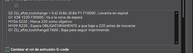

BUG #1: CFS TOOLCHANGE TEMPERATURE OVERRIDE (PETG → PLA / PLA → PETG)
Observed Behavior:
PETG configured: 220°C (slicer filament profile + printer filament settings)
PLA configured: 220°C (support interface)
During T[next_extruder] / CFS toolchange sequence:
User G-code: M104 S220 / M109 S220 executed (nozzle reaches 220°C)
CFS firmware macro IMMEDIATELY overrides to 250°C target during purge/extrusion
PLA filament extruded at 250°C → heat creep in heatbreak → consistent clogs
Root Cause (suspected):
CFS CHANGE_TOOL or PURGE macro in gcode_macro.cfg contains hardcoded
PETG temperature:
{% set extruder_temp = 250%} ; Ignores slicer settings
M109 S{extruder_temp} ; Overrides user M109 S220
Slicer variables {nozzle_temperature[next_extruder]} are ignored.
Impact: PLA softens in heatbreak (Tg ~60°C) before extrusion, causing
recurrent clogs.

BUG #3: ASYMMETRIC THERMAL RAMPING IN BIDIRECTIONAL TOOLCHANGE
PETG → PLA (250°C → 220°C):
250°C → M109 S220 executed → CFS macro re-targets 250°C → PLA extruded
at 250°C (FAIL)
PLA → PETG (220°C → 250°C):
220°C → toolchange → immediate re-target 250°C → PETG extruded correctly (OK)
Problem: Thermal ramp DOWN (PETG→PLA) interrupted by ascending
override. Ramp UP (PLA→PETG) respected.
TECHNICAL SOLUTION PROPOSED (Klipper Macro Code)
Fix CFS CHANGE_TOOL macro:
[gcode_macro CFS_CHANGE_TOOL]
gcode:
{% set next_temp = printer.extruders[params.NEXT_EXTRUDER].target|float %}
{% set next_bed_temp = printer.heater_bed.target|float %}
T{params.NEXT_EXTRUDER}
M109 S{next_temp} ; RESPECT slicer temperature
; … rest of toolchange sequence
