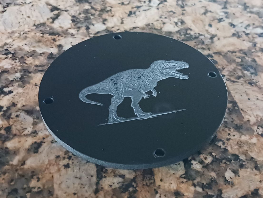

Cutting 6mm Black Cast Acrylic
Just thought I share my first cut with the Falcon 2 22W. I read it should take multiple passes but I tried 120mm/min x 100% and it went thru on the first pass, Etch was done at 6000x40. Blankoff shown below is 5 inches in diameter.
