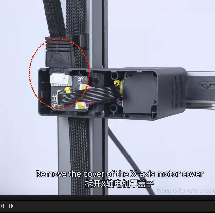

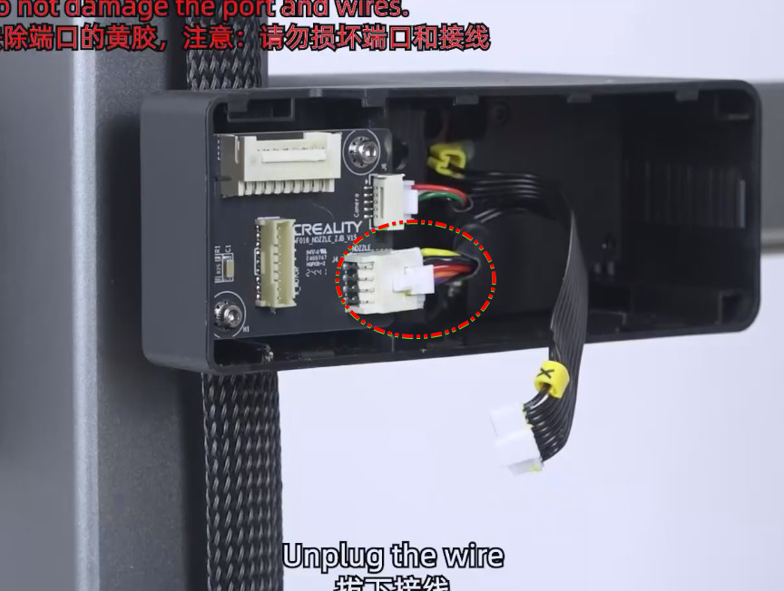

This cable, from the end connecting with the nozzle to the end connecting with the back box
a guide of how to change it can be found on https://youtu.be/iGGE2F8KRso will help you to identify.
Be sure the cable is not broken using the multimeter and is full seated on booth connectors

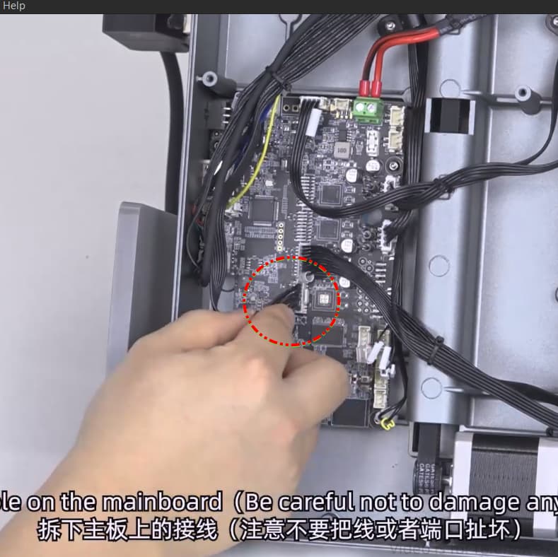

also test the main cable from the back box to the main board:
again, test for continuity of each wire and what they are full settled on the connectors.
This is excellent, I really appreciate it. I will give it a shot, but I will get enough funds to the side to order a new printer, just in case :slight_smile: . I know my limits :slight_smile: . Joke aside, I removed the cable from the front motherboard, reconnected it, and now the only error I get is that there is filament in the extruder. I know there’s nothing in the extruder; however, I just noticed that the plastic part for the cutter is not moving in. I will remove and reinstall the extruder; maybe I installed it wrong previously, preventing the cutter from moving in and out. Will post more. Thank you so much for your assistance!!
