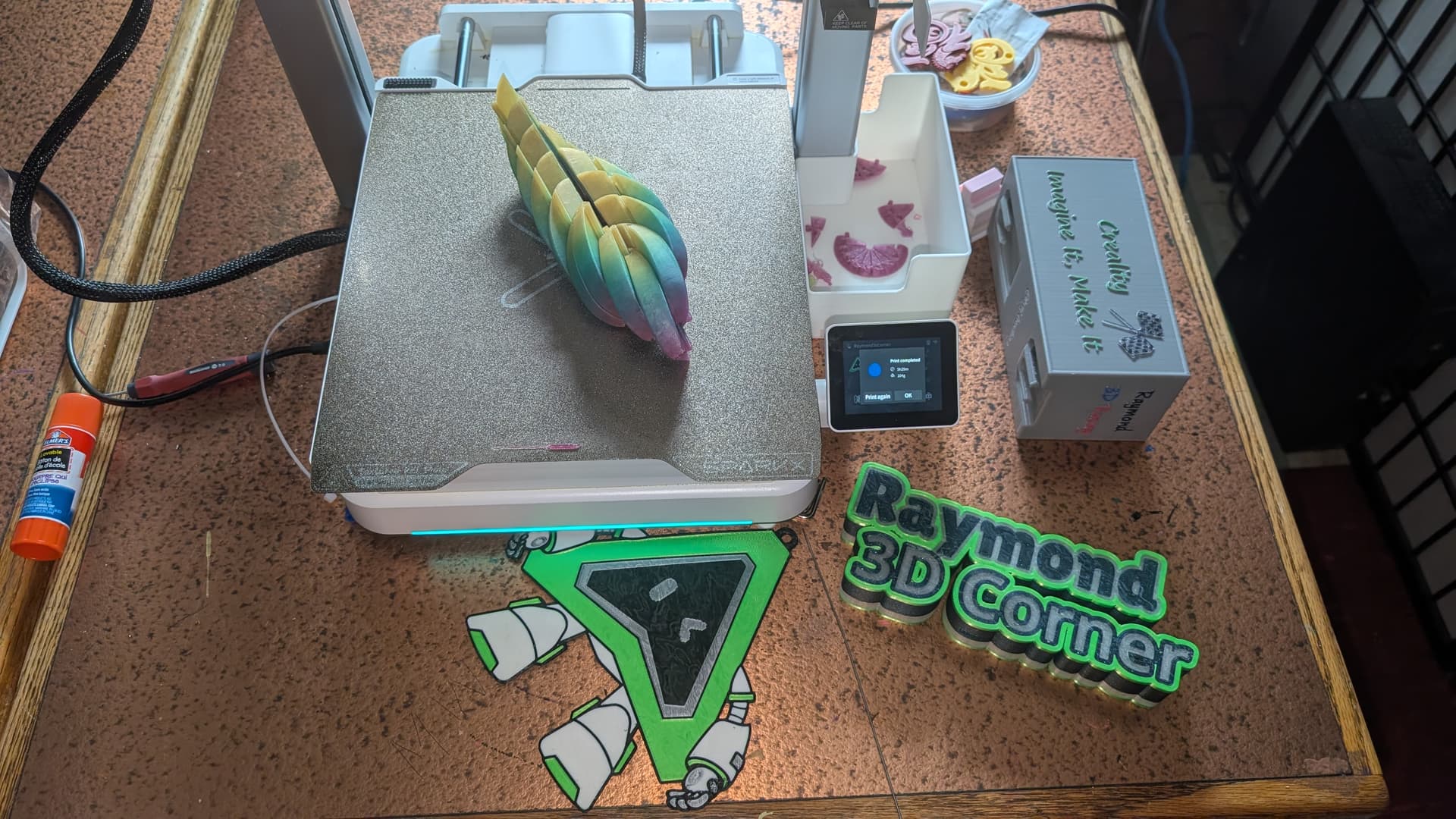

Fidget Easter Egg

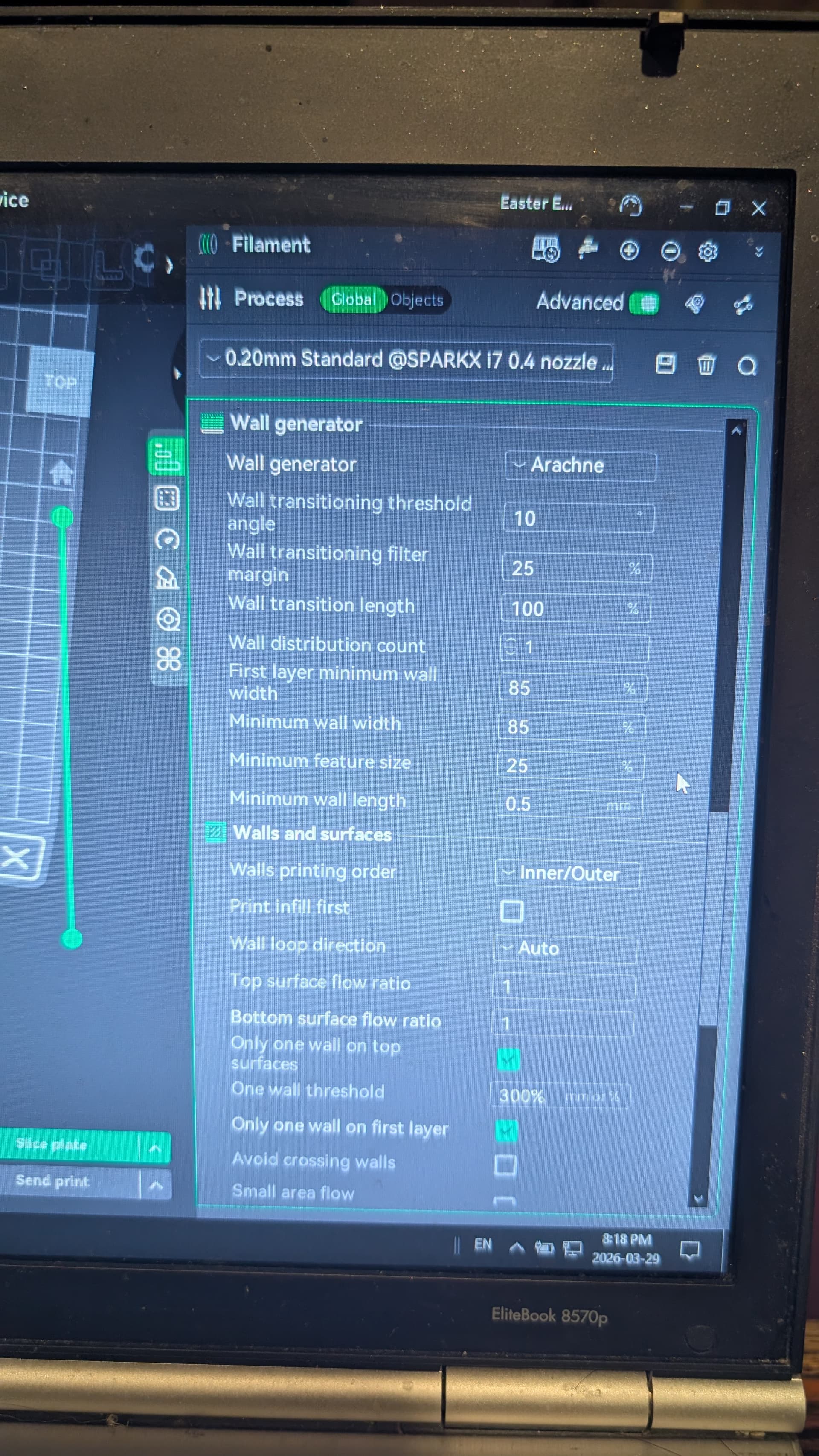

I was having some trouble with the fidget toy it seize at the bottom few layers. I have to adjust a few of the setting to get it working properly. Now it’s easy to loose up and able to move it freely
This is my profile for the fidget toys.
I attached the screen shots for my settings.
I will try to upload the profile to Creality Cloud
Precision and Quality Setting
Enable : Precision Wall
Enable : Precision Z height
Elephant foot compensation : 0.25
Elephant foot compensation layers: 1 or 3 depends on the model
Wall Generate - Arachne
Enable : Only one wall on top surface
Enable : Only one wall on first layer
Hope those setting helps.
