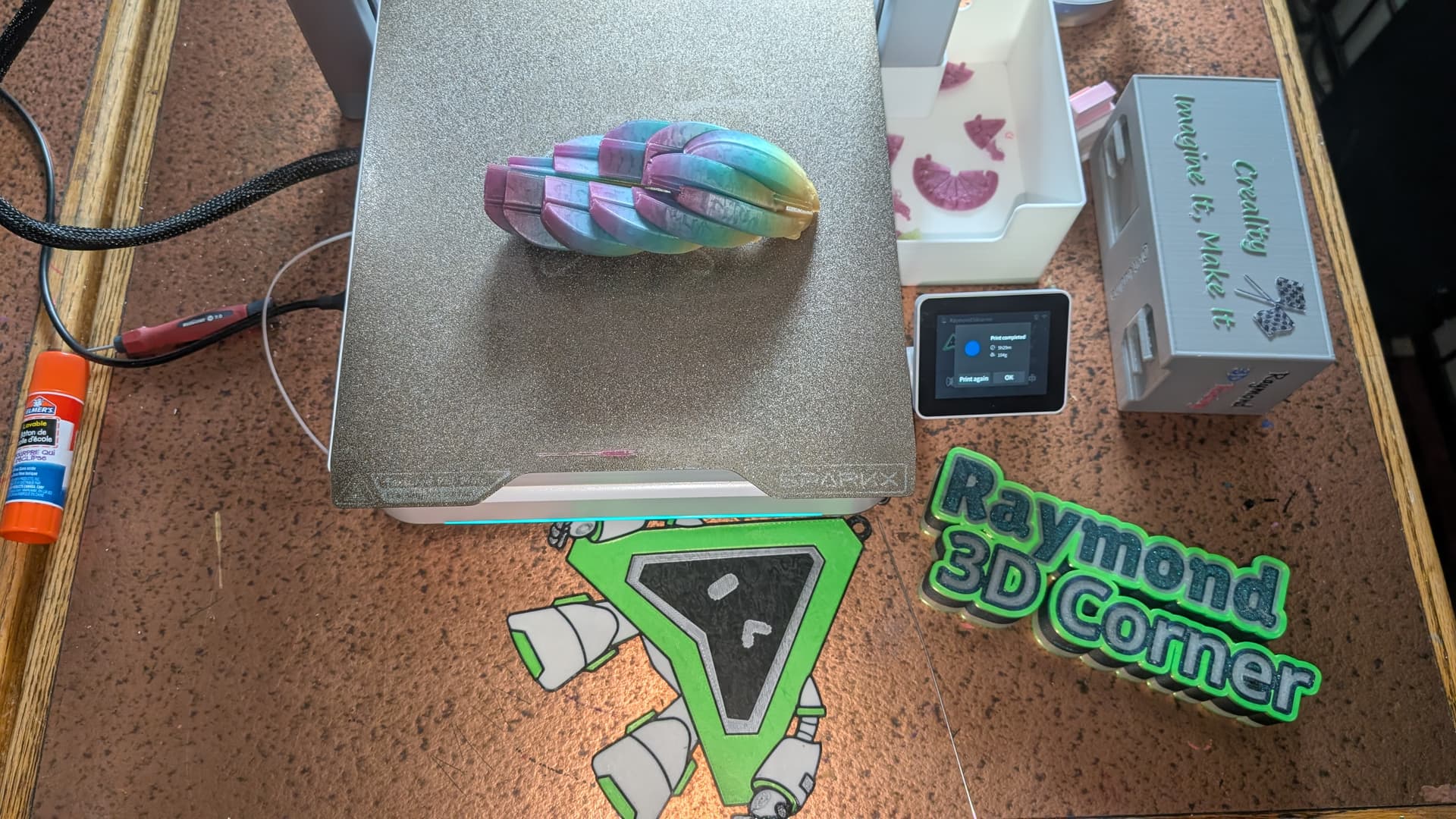

Day 7 of Creality Spark X i7 Solution for seized fidget toys
Twisted Easter Bunny + Fidget Easter Egg

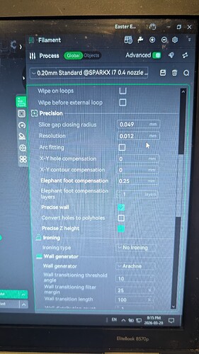

I attached my fidget toys setting. This avoid the moving parts seized together. It works very well for me on the i7.

Appreciate the posts! I’ve had issues with printing these in the past and will definitely try these settings. :blush:
