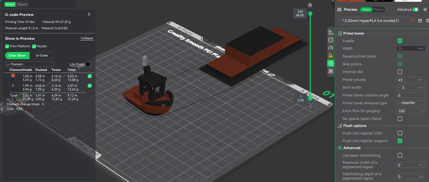

Issue: Extremely Large Purge Tower
  • The purge tower was massive, and to add a surprise, it’s even extending beyond the build plate
  • I was unable to modify it initially (settings were greyed out)
Eventually, I managed to reduce it by:
  • Adjusting flush volume

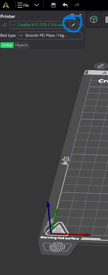

  • Importing previous K1C settings using the “Transfer” option

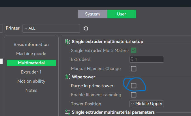

I successfully reduced purge tower size to a reasonable level (via printer settings), and uncheck the “Purge in prime tower” - then you can make changes to prime tower.

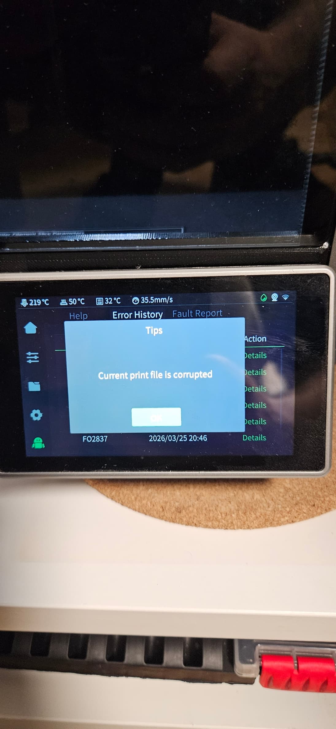

I restarted the print, and after it’s startup procedure, the print finally started, and went alright up until the first color change (about 12 minutes in), when the print stopped, resulting an “Print file corrupt” error.
I thought, maybe because I fiddled with prime tower settings, and I got back to it and re-adjust it a bit more.
Send print - print started - approx 12 minutes in, first color change - same error!
Later I found online that by downgrading to Creality Print 6.3 solves this issue, so I give it a shot.
Result:
  • Warning about newer project version
  • Loss of some settings (including purge tower options)
  • BUT: Print completed successfully (~1h 50min)
This strongly suggests a slicer-related bug
