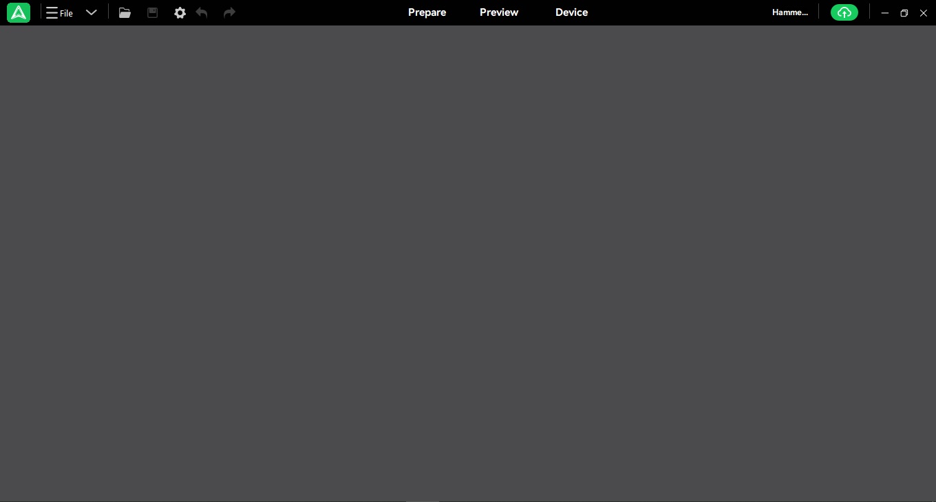

Hi guys,
I can not see device page in Creality Print software.
Any one had same issue?! how to solve?

No issues here with 3203. I see all my printers.
Try to scroll down on that page.
Maybe reinstall…?
See if you are logged in. Click on the Creality logo far left.
actually i uninstalled/reinstalled but nothing.
also the that page is empty too!
also went back to old version: CrealityPrint_6.2.0.2827_Release. but it did not work too!!! It was working …
resolved!
nothing related to creality print app. it happens after some gpu dirver update or graphical app installation like photoshop or even windows updates!
just run this line of command in windows powershell:
winget install --id Microsoft.EdgeWebView2Runtime -e
I have a similar issue - but on my Intel Mac…
for me, as explained, it was not a Creality Print issue but an issue from OS(windows). there are solutions for MAC in Github. Better to have a look there.
Tried them. They did not work. C’mon Creality - investigate and resolve this please.
try to find issue in your OS. specifically things related to graphical drivers. if you updated them recently rollback them. or if you did not updated for last months do update them.
