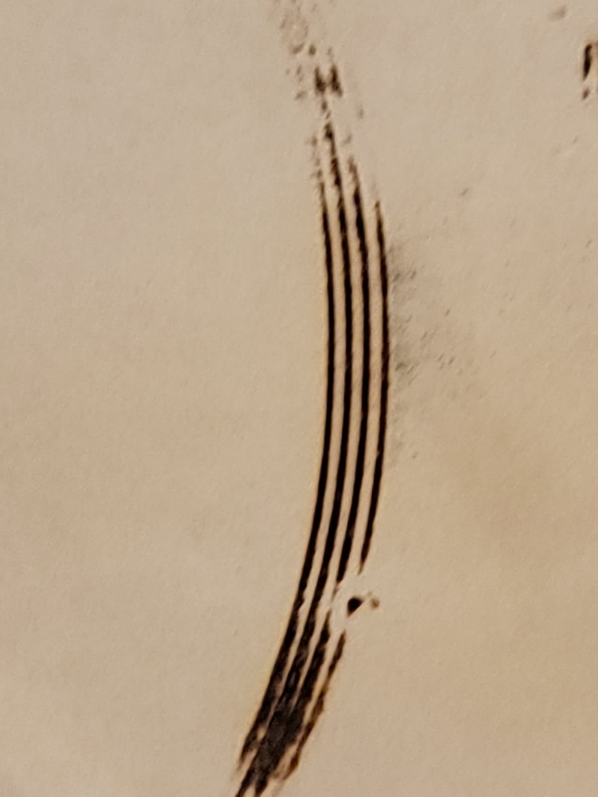

I was working on my falcon-2 and at one point I moved the laser module to the back of the machine so I could load a new piece of material. I then typed home, and it moved to the far left and started grinding, so I hit the emergency button and moved the laser module by hand away from the corner. After that, the home worked, but now I get 4 lines when I go to cut some paper (see attached). Did the laser module get misaligned or something? Any suggestions appreciated.
Sorry. I raised the laser module as high as it would go so I could reinstall the honeycomb, and forgot to lower back down. So this was a common case of Dumb User Error…
