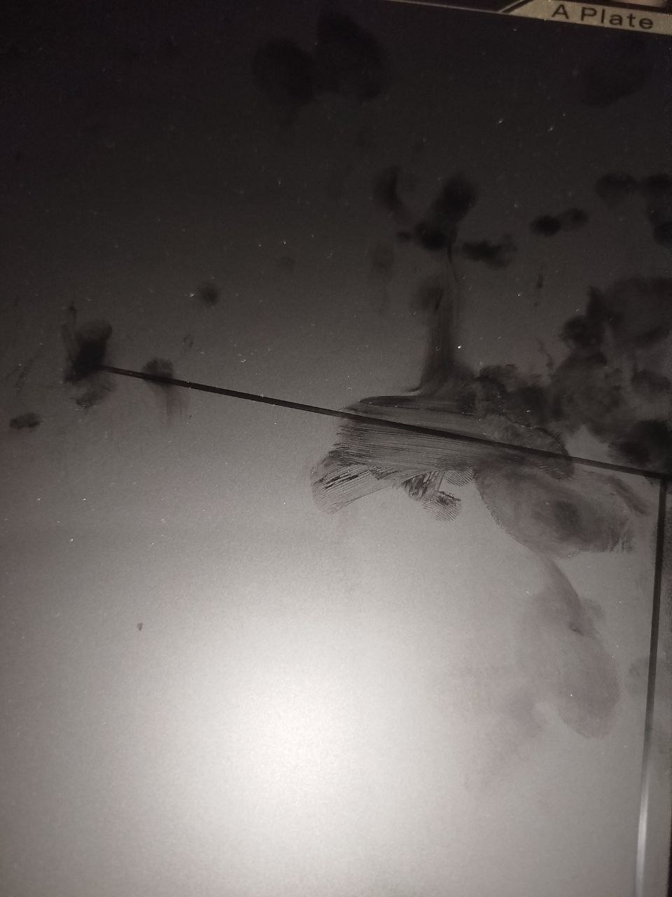

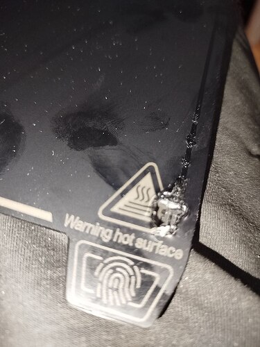

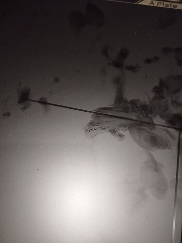

  6. Restart Klipper: Restart the Klipper service for the changes to take effect.
Thank you so much for your excellent, figuratively speaking, guide. After thoroughly examining it, I thought that I should tune the printer so as not to waste time cleaning the nozzle, because I do not have a brush. I ditched the table and it’s all thanks to you! I don’t recommend repeating it)
