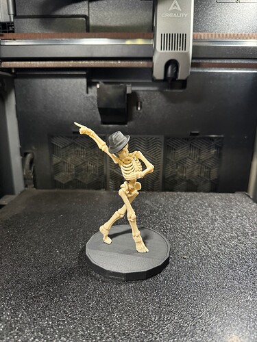

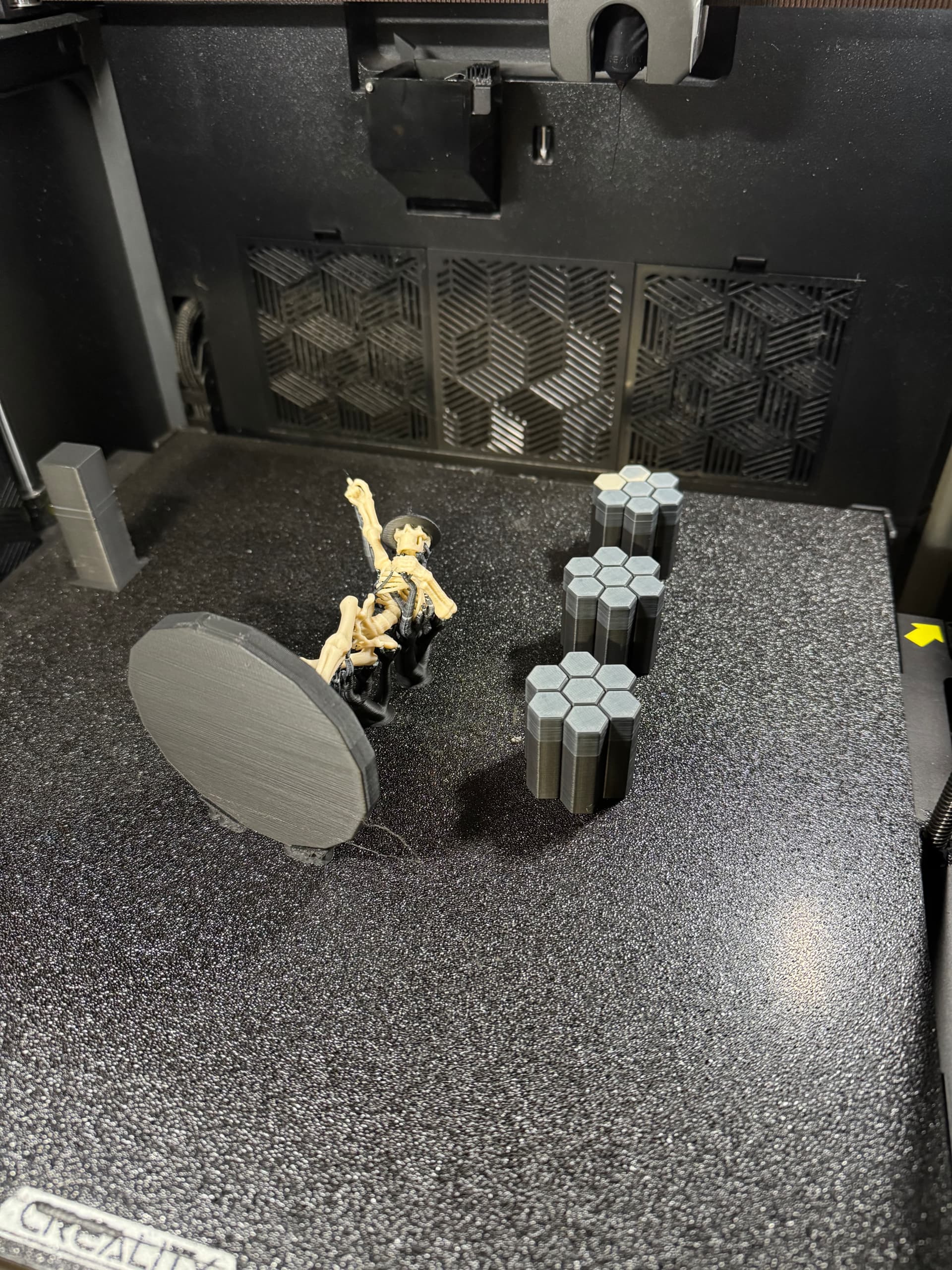

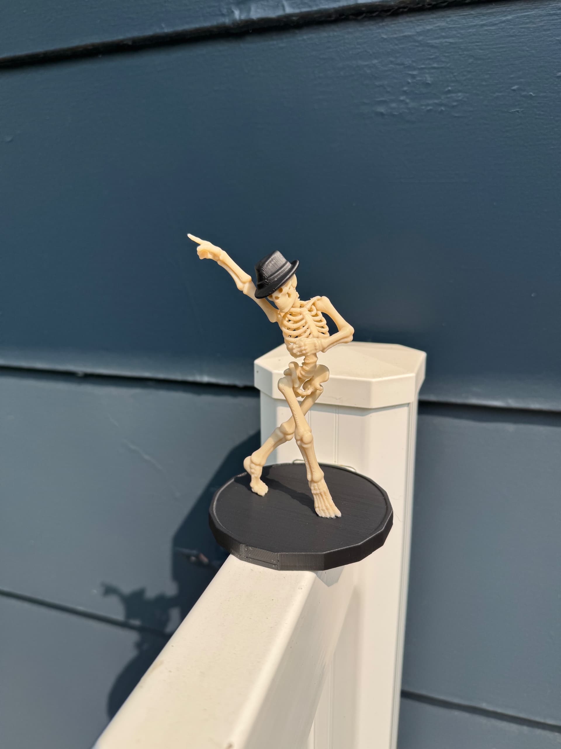

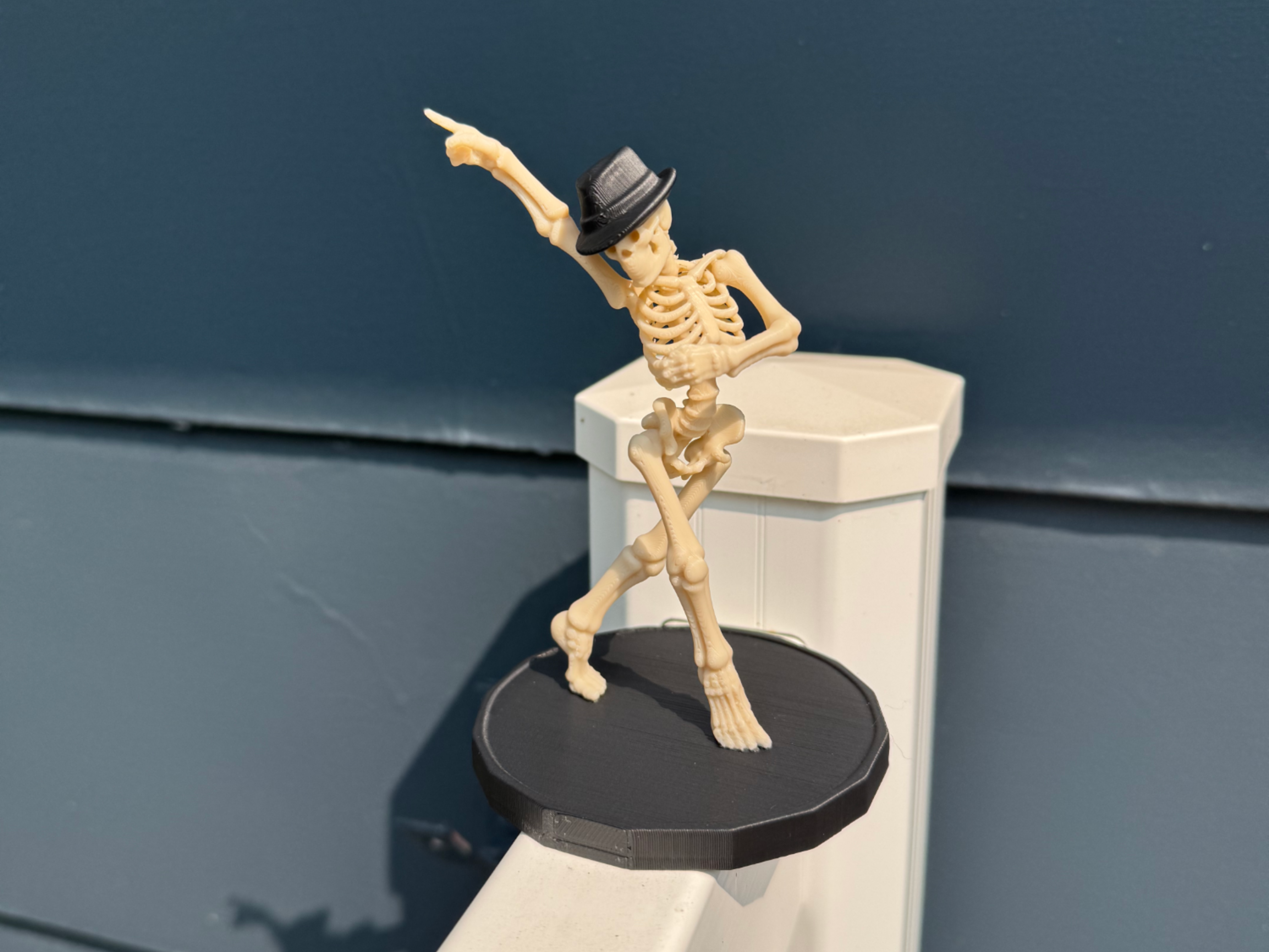

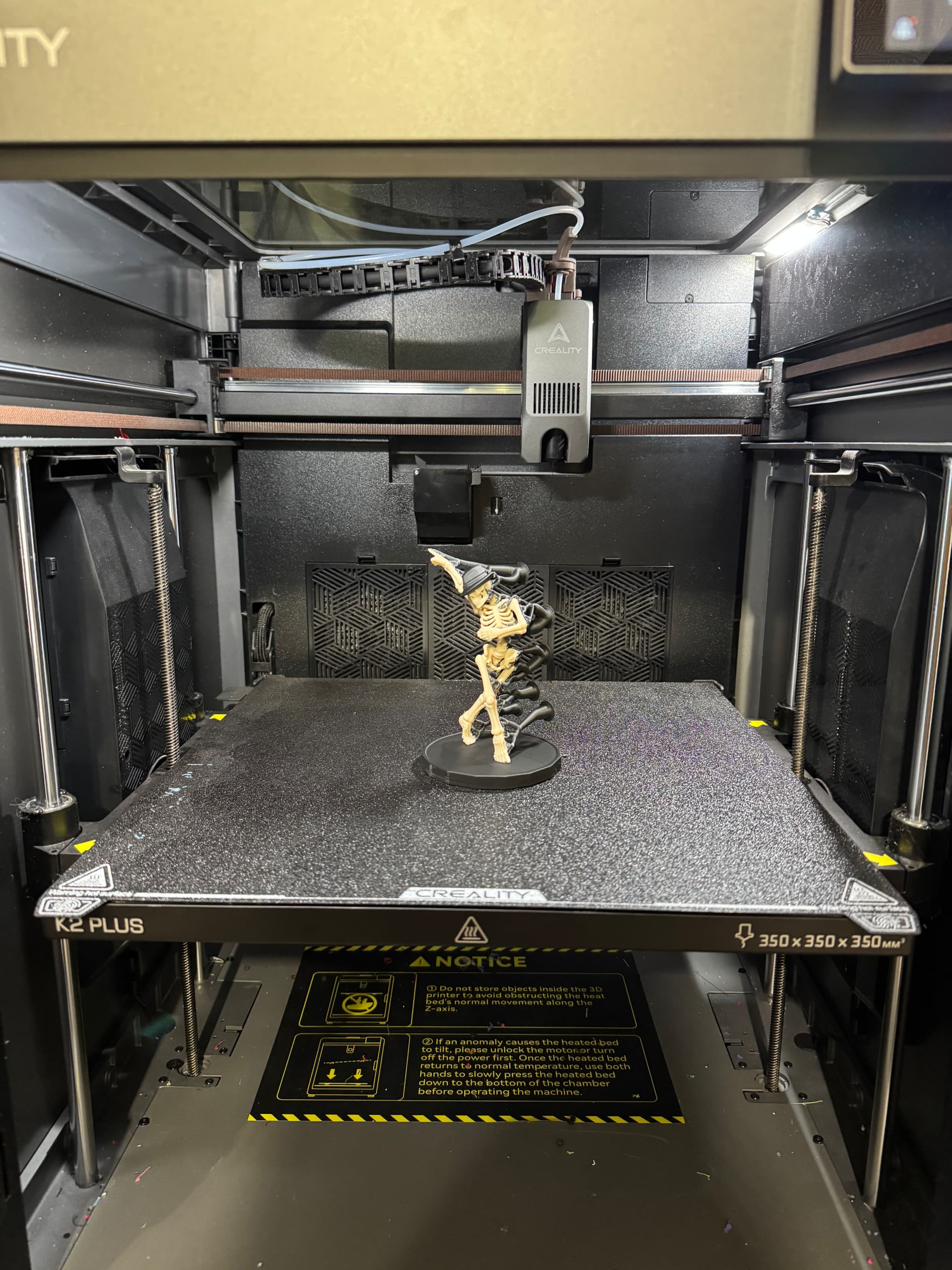

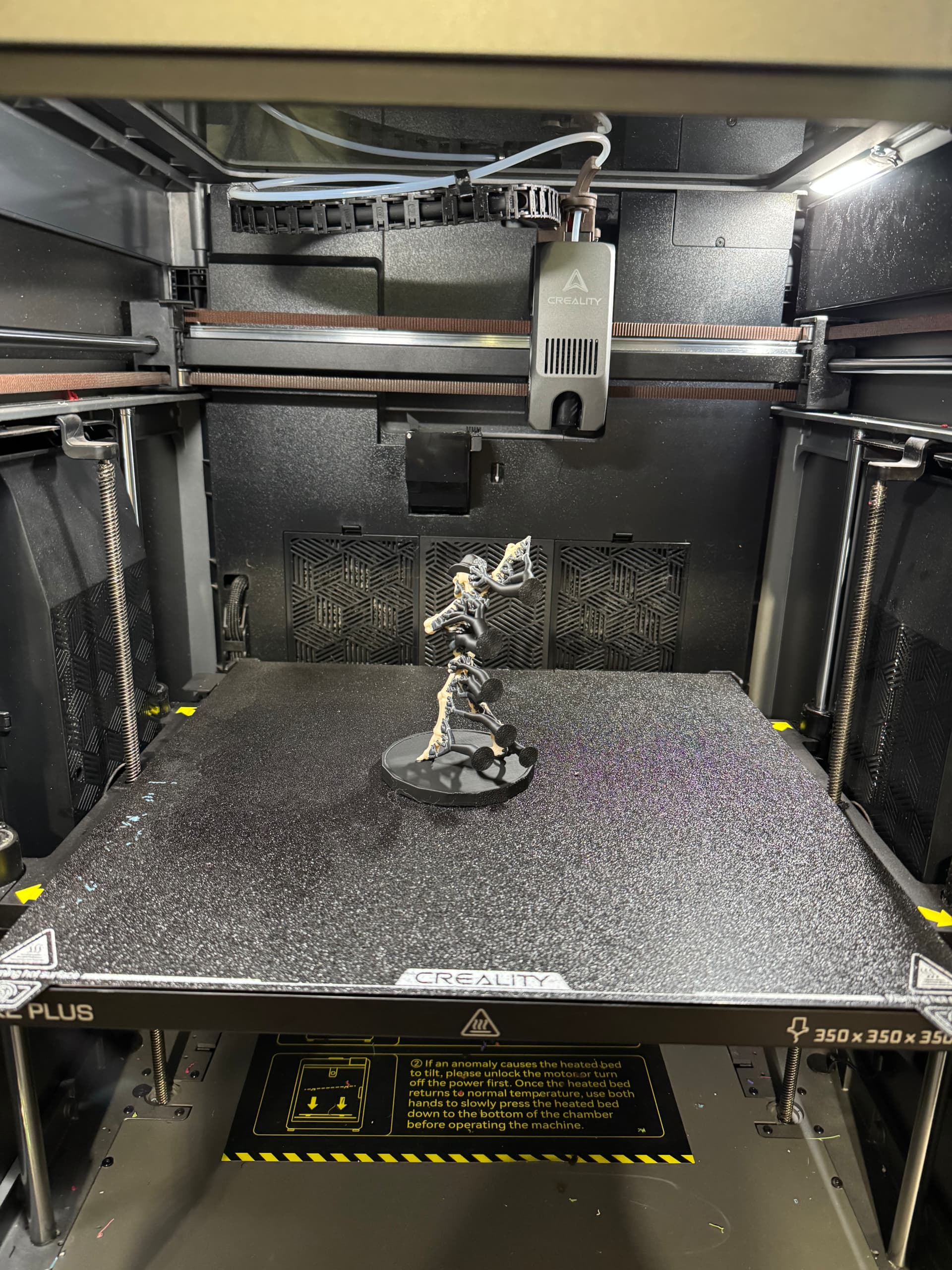

Here is my Michael Jackson inspired dance pose skeleton for the skeleton design contest. Printed on its “back” on my K2 plus with Soleyin Matt black PLA and hyper PLA peach fuzz at 0.16 mm layer height, 10% gyroid infill, with tree supports with 0.21 mm top Z distance.
