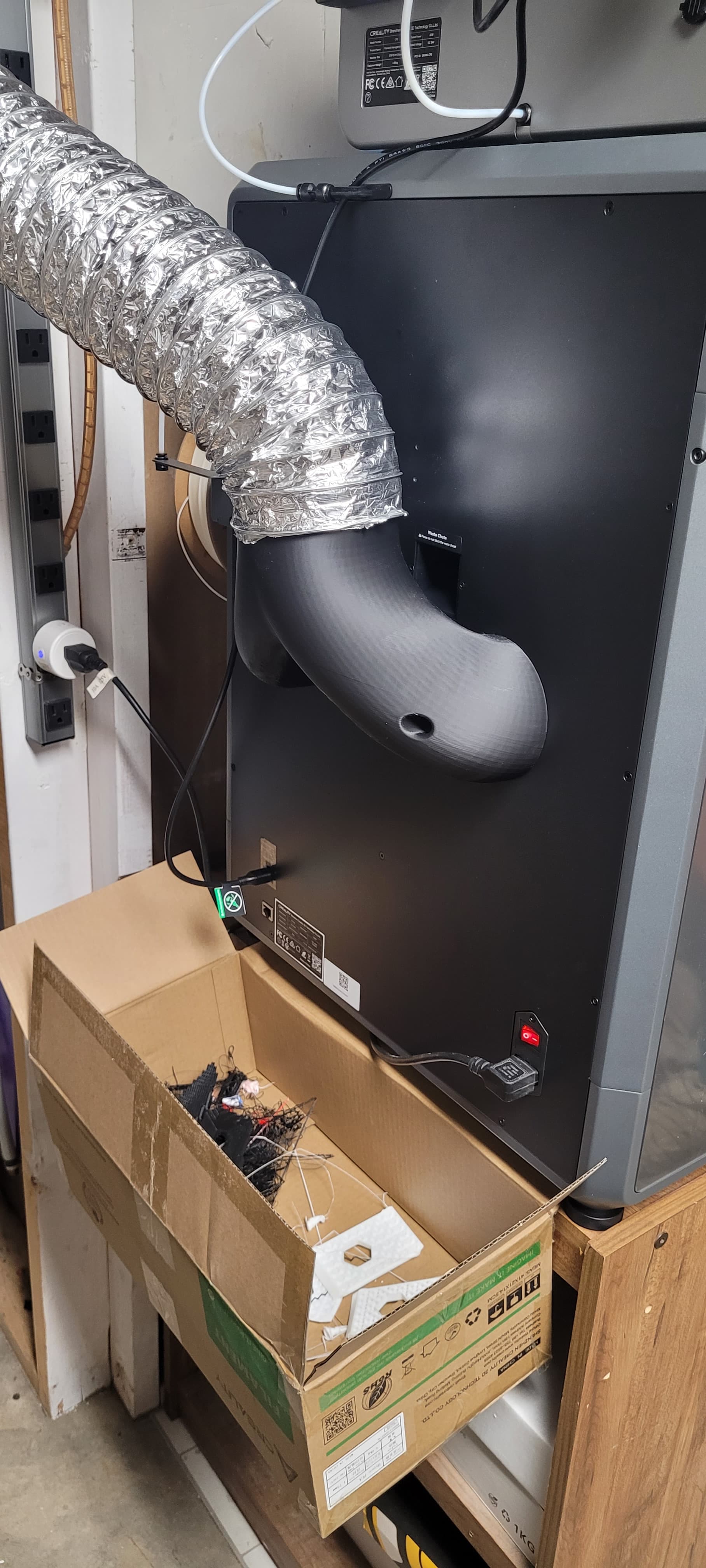

Thank you so much for getting back to me. This was not making sense with the side fans running so hard. I am a complete Noob to pla but have been printing abs for 12 years on a modified bedslinger and wind was always the enemy. It is a hurricane inside but most of the tempest does not impinge on printing objects. I think the left side suction caused faiures on that side. The print failed as the bed lowered into its proximity, I may design up a suction baffle for those inlets. Just finishing a 24 hr + print and will do a short test without fans, door closed. I have island mounted the K2 on a ridgid anchored platform and being an abs guy, on of my initial prints was a custom designed exhaust manifold with a low draw, no vibration connection to an HRV (pic). No exhaust recirculation here for sure. I am in the same boat (or benchy) with the fans. As you noted, no heat rejection, if anything the side fans blow heat from the heated bed and necessitate door opening to keep things cool on long prints.
