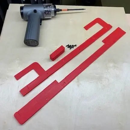

What is the best Glue to re glue the door hinges back on? I have 6 K2 Plus units, and when I open the doors, the hinges are coming off the glass.
You can use a Glass glue
or B700 glue
https://www.amazon.com/Rhinestone-Jewelry-Adhesive-Viscosity-Clothes/dp/B09SL5LT8W
A UV curing glue is good idea.
Also is recommended to use this to align the hinges.
my door was off when I received it and I just used the same glue as you would to replace review mirror in your cat. been over a year and been printing ABS and has not even come lose at all.
