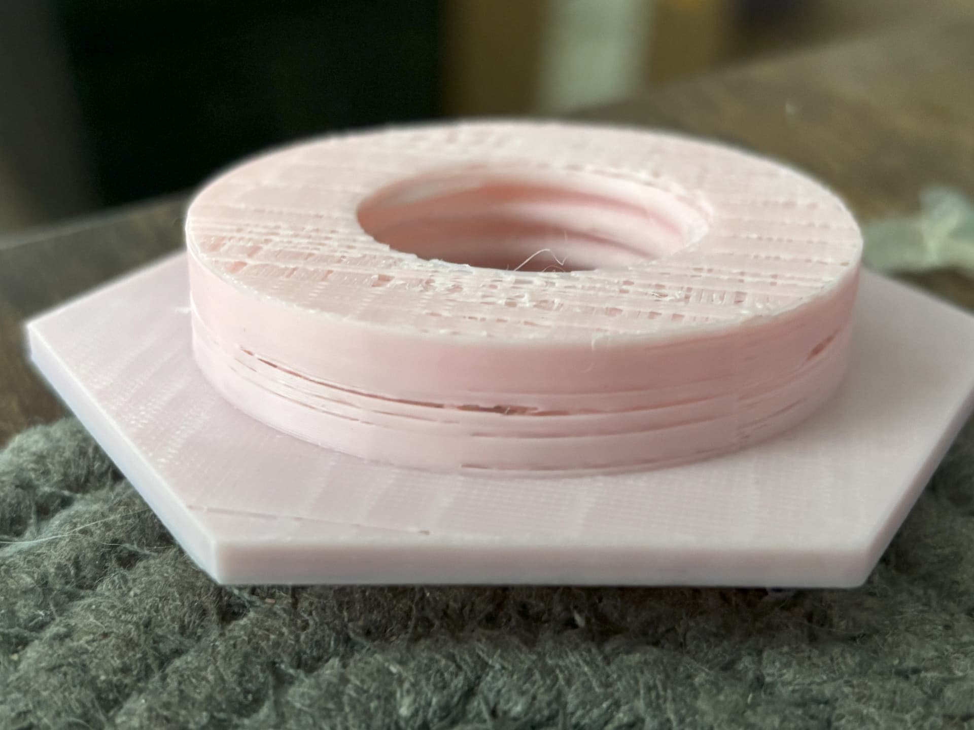

I bought the Creality filament dryer that holds 2 spools. I am trying to dry Hyper PLA Spring and it doesn’t seem to work. I read up and have it cracked open to help with the RH%. Lowest I can get it is 22. I let my filament dry for 8 hours and it couldn’t even run one layer of the inside squares for the print. I then let it dry for 12 hours and the same problem. Am I doing something wrong? It doesn’t list Hyper PLA as an option so I am using the PLA - CF. I am leaving the filament in the dryer as I print in order to keep it dry since it is spring and we have a lot of rain and humidity right now
So I dryed it for 18 hours and than did a 22min print and this is what I got
Looks more like a partial nozzle clog than a humidity issue
