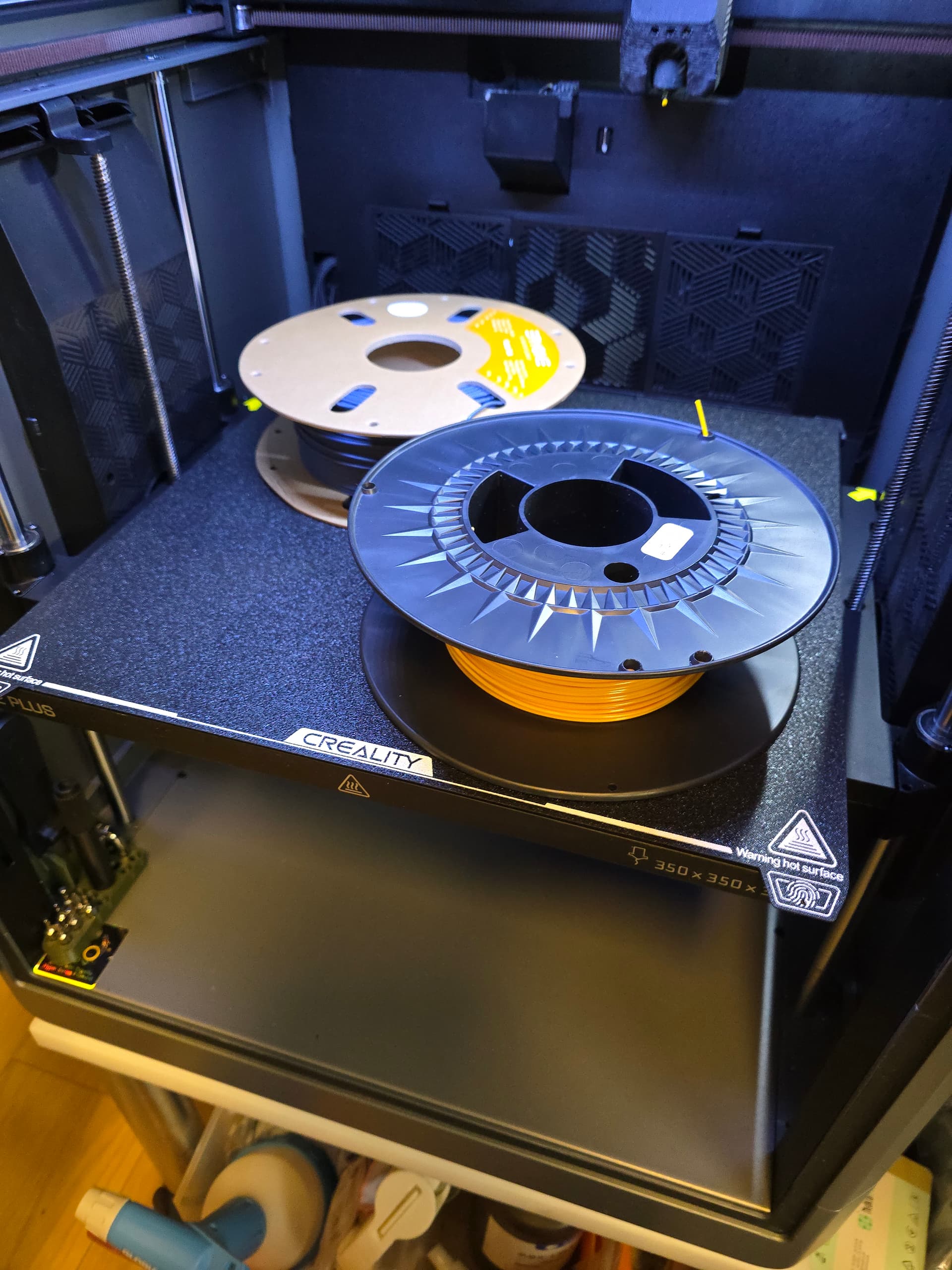

I wanted to share some other method I use to dry filament or the silica packs overnight: With my K2+ on the heated bed!
The bed fits up to 2 rolls of (1kg) filament and can heat up to 100°C which is enough for me.

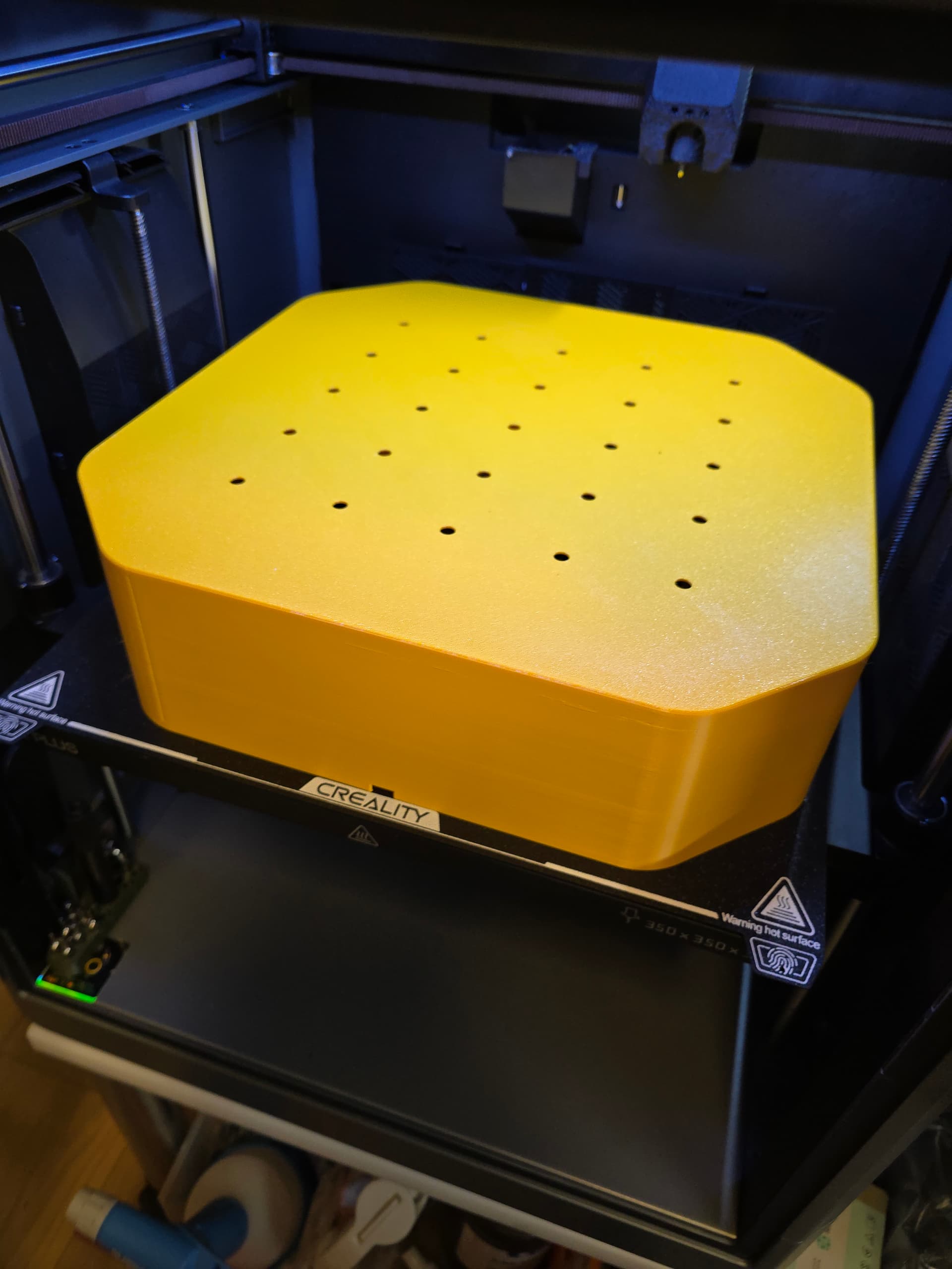

Originally I used an empty filament box where I made some holes on the top to cover the filament roll and then I just set heat bed temp.
Then I created covers (you can download from Creality Cloud) and printed them in PETG which works for me up to 80°C bed temp.

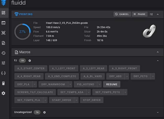

I saw that Qidi offered drying in the printer new menu and adapted similar macros to be used in K2+ for fluidd interface:

You may enter this in printer.cfg or write it in your own file like I do with all my macros my_macros.cfg and then add only the include statement to the printer.cfg:
[include my_macros.cfg]
This way I have to just upload my macro file and add the include into printer config after any firmware upgrade when my macros are deleted.
I also created a macro section (FJ) in fluidd and moved all my macros in there.
I can simply click on the macro and the heating starts with defaults and counts down time in fluidd console.
Or you can click on the down arrow of the macro and change time/temperature from default.
Before I put filament in I switch off motors (issuing M84 fluidd code in console) which let the bed go down and reduce power drawn by other components.
I leave the top lid open a bit but close the door of the printer.
In this way the printer will stop automatically after the hours you specify.
I do have my printer connected via a wireless plug (shelly) which switches printer off when it consumes less than 30W for at least 20 minutes and that’s why my printer is shut down completely after drying ended (or after a long nightly print ended).
p.s.: The energy consumption is very efficient with the covers, better than in oven or microwave.

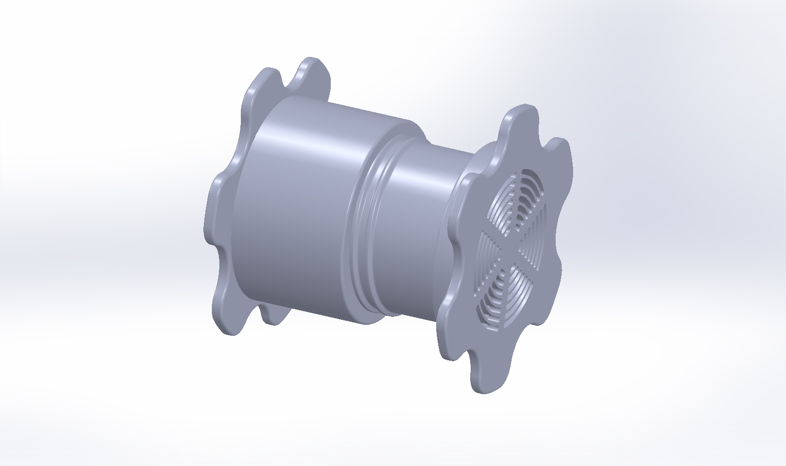

I do exact same! For card spools I use a different type and for some plastic spools from extrudr or Ziro I use self created ones but created a bit smaller version as well for smaller spools.
fj-silica+in+spool-os.3mf (7,3 MB)
For cardboard spools I use some which are just rolling inside but all print with less filament.
fj-silica+in+spool-cb.3mf (9,3 MB)
I also created my own in two sizes for plastic spools mainly from Ziro and some others.
fj-silica+in+spool-my.3mf (9,8 MB)
