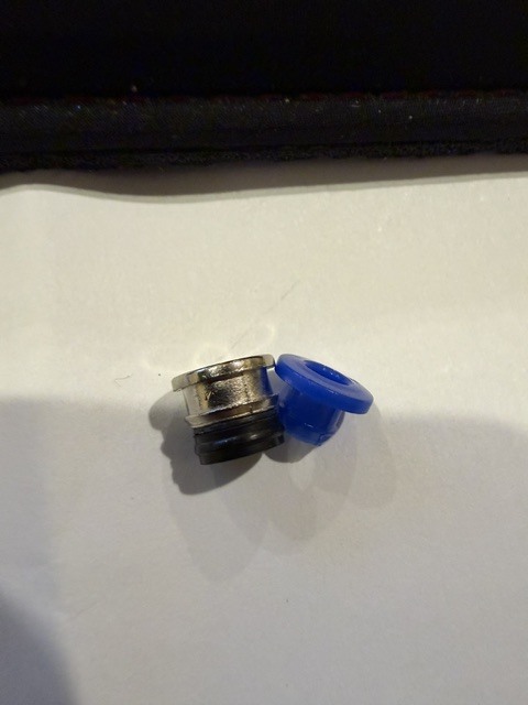

I was going to print up the cable riser bowden tube workarounds, but then I looked at the connector I had removed. I ordered this bowden push-in connector from Amazon, which looks pretty standard so far as push-in connectors go:
Amazon.com: 50 Pcs PTFE Pneumatic Valve Connector Heads ECAS04 Air Control Valve Fittings for 3D Printer Extruder Replacement with Industrial-grade Sealing Performance : Industrial & Scientific

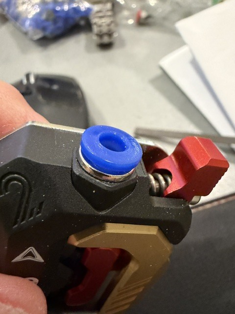

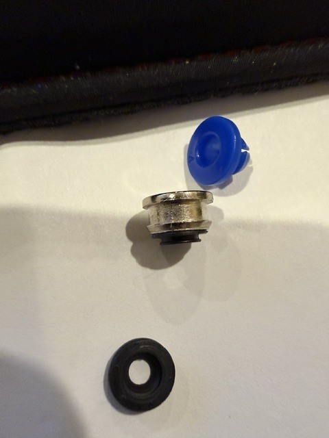

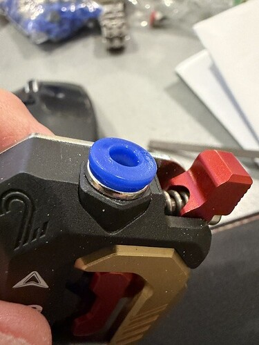

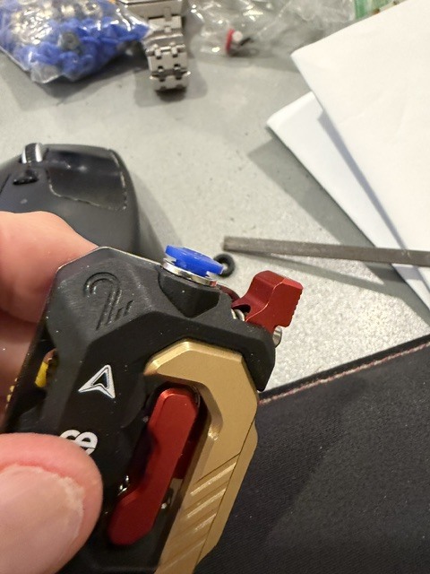

It has a rubber piece on the bottom, which did not tightly wedge the connector in place, and it was too tall. I removed the rubber piece, and ended up filing the metal ridge on the bottom to the points where I was able to push it in: flush fit (actually took some force inverting it on my table and pushing). It holds the PTFE tube just great (first try anyway) and looks good. And I have 49 more of them if/when this one fails :grinning_face_with_smiling_eyes: . Of course, I have the actual replacements coming from China as well due to very fast tech support.
