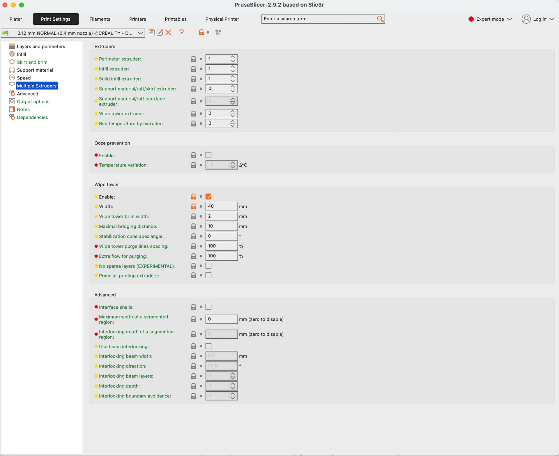

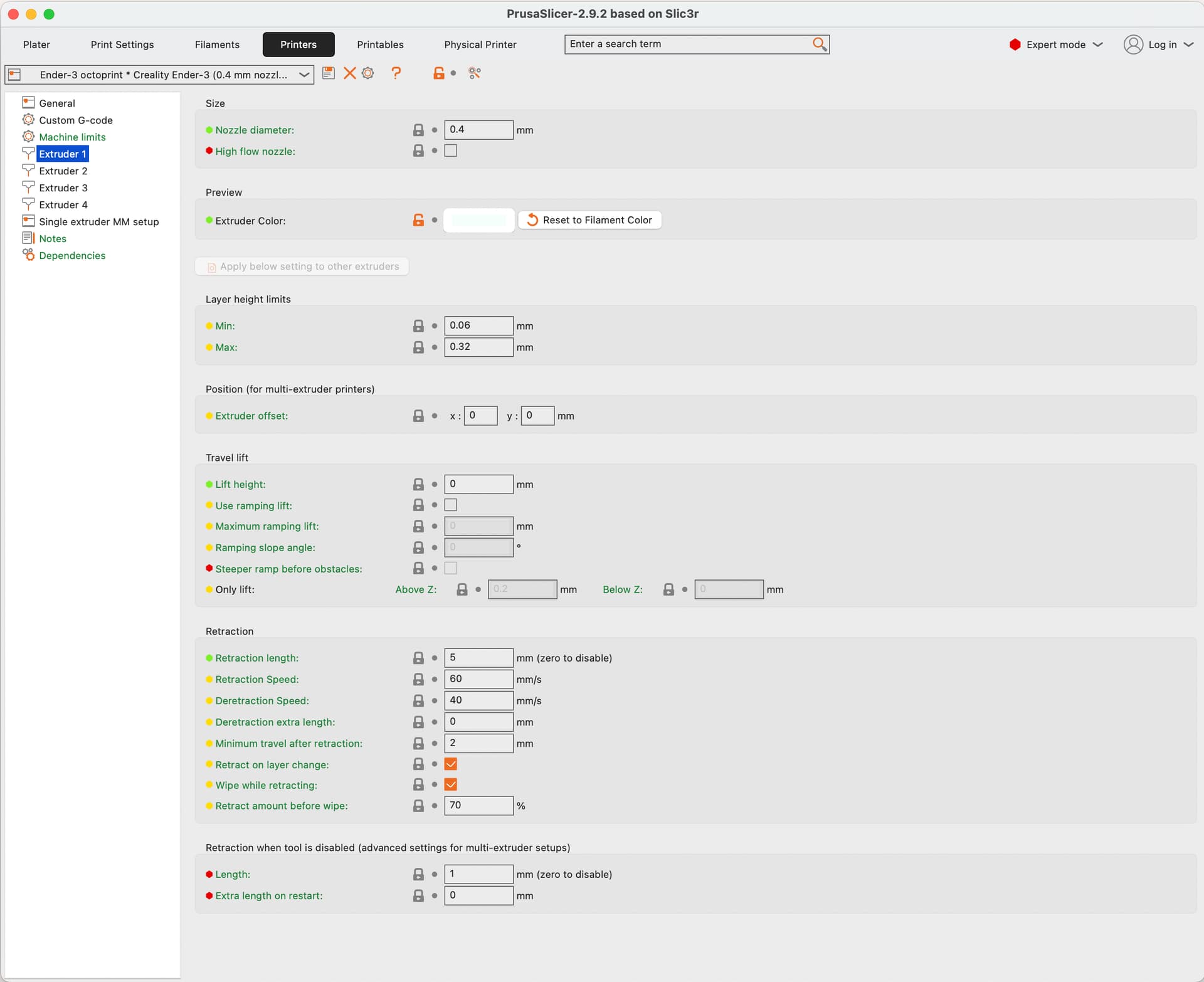

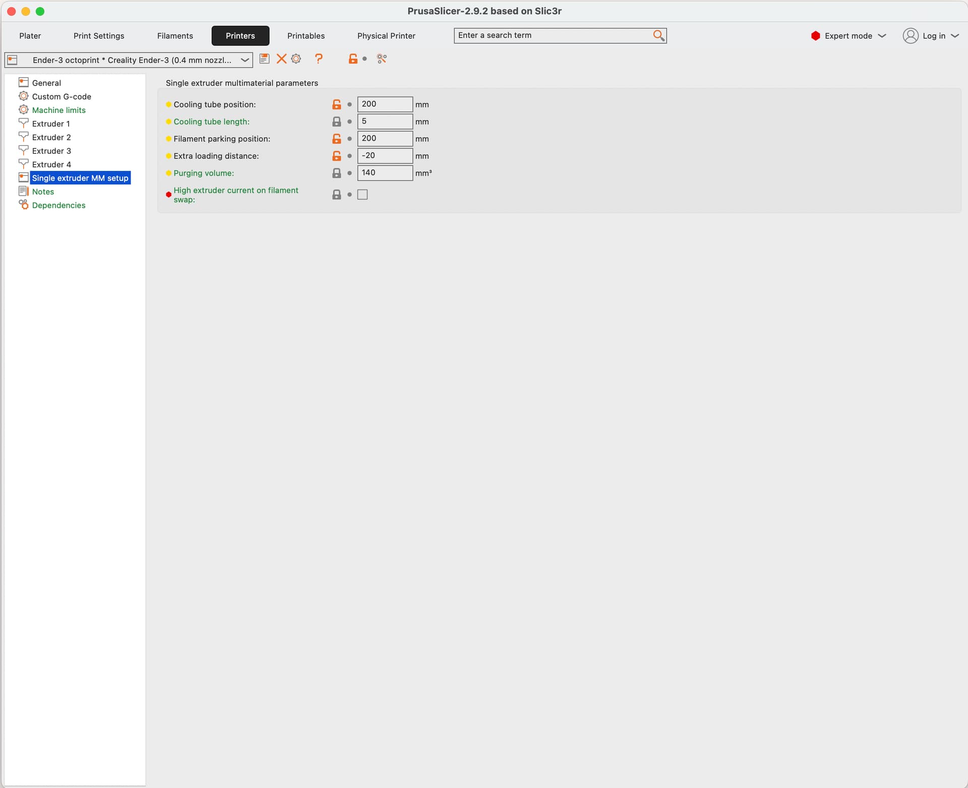

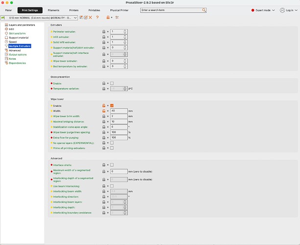

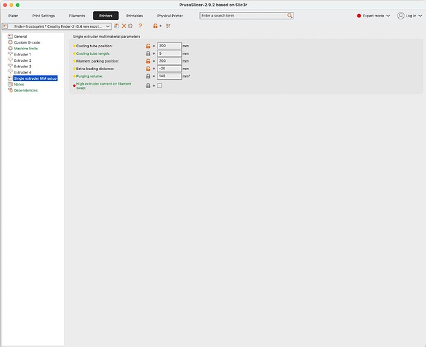

Here is my PrusaSlicer config:
From the PrusaSlicer config, few snapshots that might be interesting:

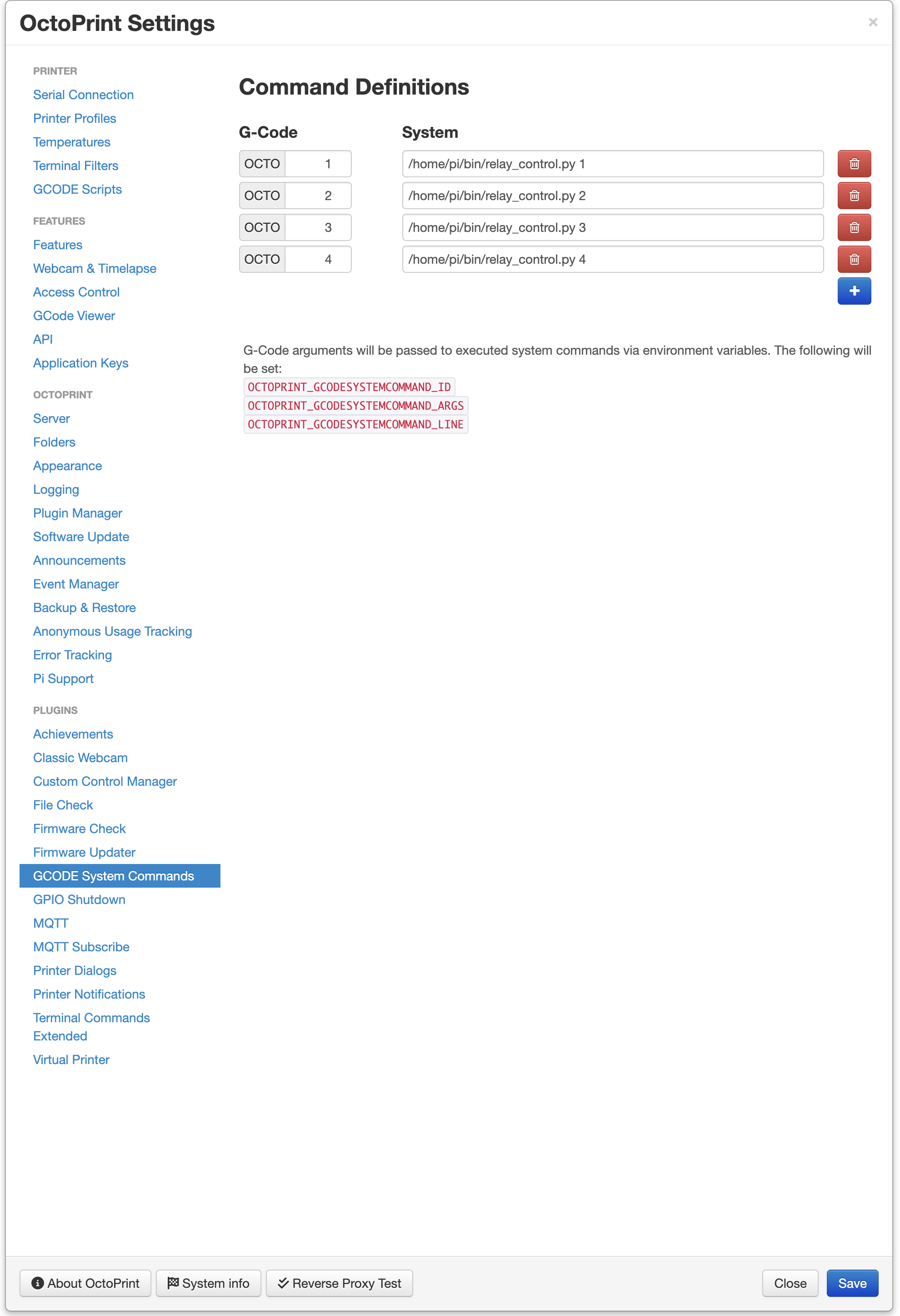

Regarding Octoprint config, here is a snapshot of the plugin I use for custom G-codes:
And here the content of the “relay_control.py” script for 3 relays as described before assuming “HIGH” is configured to OFF on the relays and “LOW” is ON:
#!/usr/bin/env python3
import RPi.GPIO as GPIO
import sys
import time
# Pin definitions
RELAY_PINS = [2, 3, 4]  # GPIO numbers
MAIN_RELAY = 2  # GPIO number
RELAY1 = 4  # GPIO number
RELAY2 = 3  # GPIO number
# Ensure a valid argument is provided
if len(sys.argv) != 2 or sys.argv[1] not in ["1", "2", "3", "4"]:
    print("Usage: python3 relay_control.py <1|2|3|4>")
    sys.exit(1)
# Setup GPIO
GPIO.setmode(GPIO.BCM)
GPIO.setup(RELAY_PINS, GPIO.OUT)
# Main
if sys.argv[1] == "1":
    ### everything off for 1
    GPIO.output(MAIN_RELAY, GPIO.HIGH)
    GPIO.output(RELAY1, GPIO.HIGH)
    GPIO.output(RELAY2, GPIO.HIGH)
elif sys.argv[1] == "2":
    ### only RELAY1 for 2
    GPIO.output(RELAY1, GPIO.LOW)
elif sys.argv[1] == "3":
    ### MAIN ON for 3
    GPIO.output(MAIN_RELAY, GPIO.LOW)
elif sys.argv[1] == "4":
    ### MAIN ON for 3
    time.sleep(0.3) ## this is to give a break to the power supply
    GPIO.output(RELAY2, GPIO.LOW)
