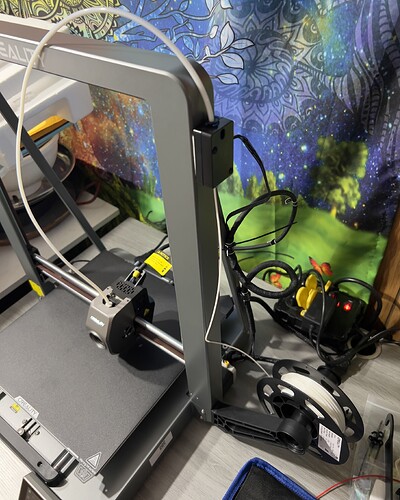

I am struggling to get the extruder to feed tpu filament without jamming in my new e3+ v3. It kinks and stops extruding. I have stopped using the pfte tube, moved the feed to top loading with zero friction , reduced retraction and speed but still the extruder jams after multiple attempts. Other filaments print absolutely perfect and fast. Any tips as I don’t think others have this issue with the new V3 or the K1 series extruders. I actually was more successful printing with much tweaking with my OG E3 from years ago. Is there a way to reduce the tension on the new sprite extruder?

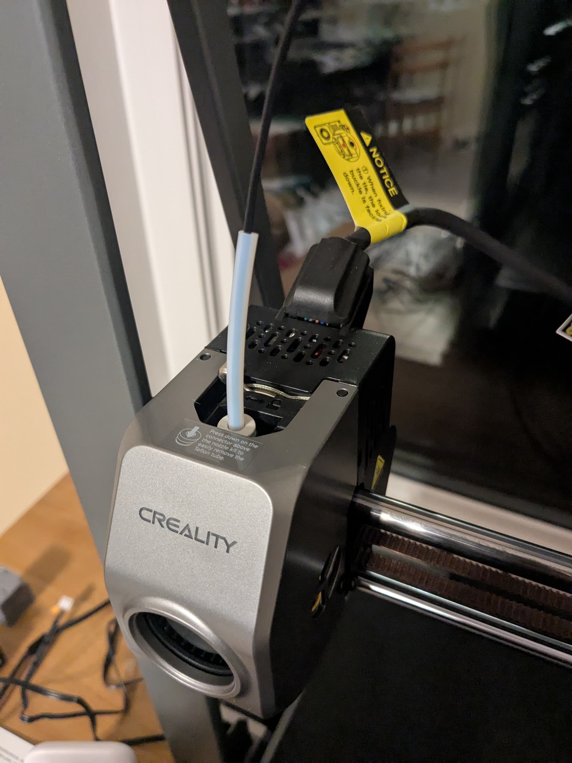

I don’t use the long PTFE tube. Rather, I cut a 4" (ish) piece that goes into the top of the extruder.
With this setup, it reduces most of the drag that having the spool on the side and going through the longer tube causes.
So far, TPU has printed just fine.

Same. I actually bought a second one. Luckily this one doesn’t have that awful noise the first one does. I’ll probably exchange that one. But the same issue occurs with the new one, the extruder gets stuck and won’t print tpu and it just clogs up everything. Here’s the new printer and when it got clogged. First one is just showing how I have it set up.
I’ve gone one step further, eliminated the pfte tube and direct feed from the top to try to resolve the TPU issues (possible stretching leading to extruder fail) but still can’t get the print to keep feeding for a print. THis printer was a major upgrade in every way from the OG E-3 but this is the only struggle I am having. Not sure how I can adjust the extruder tension in my research anywhere.
Thanks for the suggestion of adding the short PTFE tube for TPU, it stopped the clicking and jamming right away.

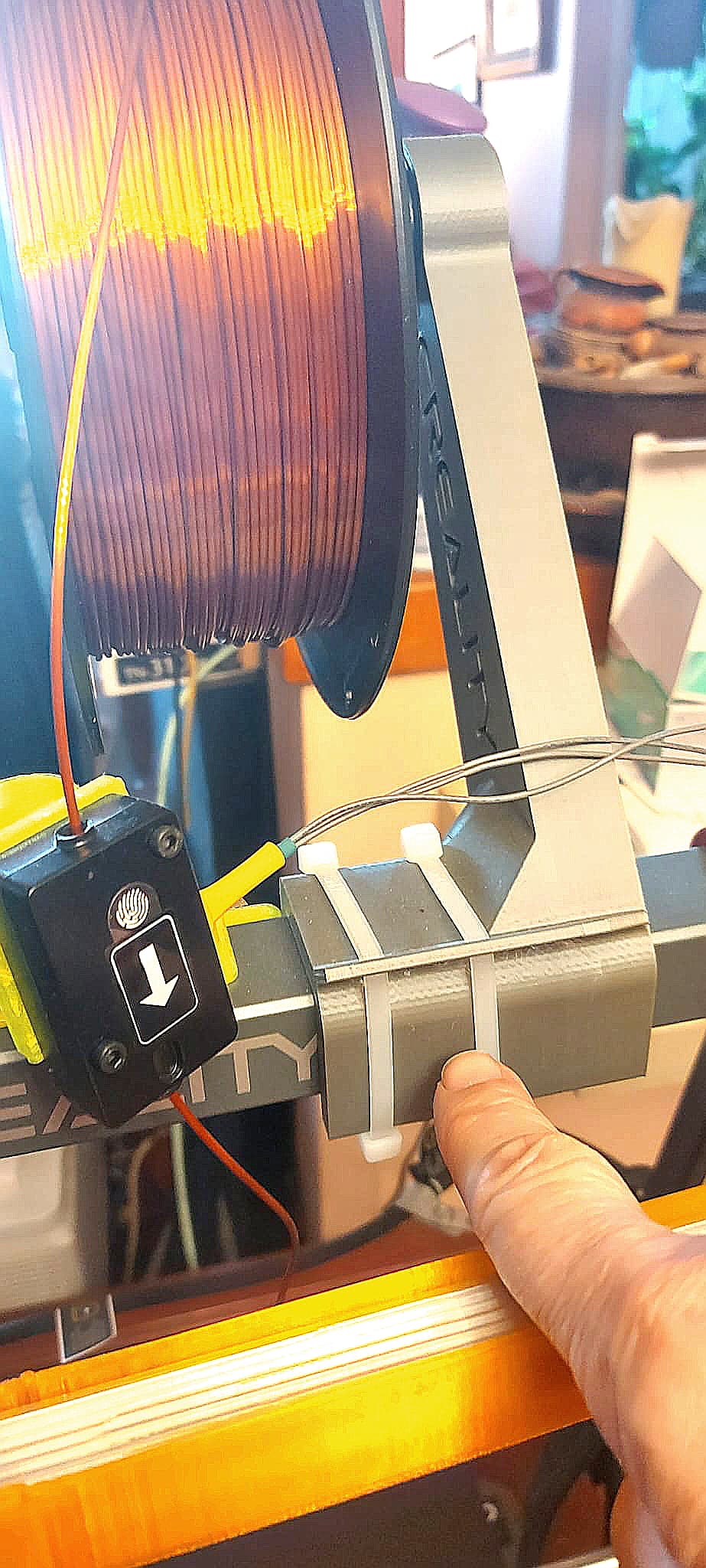

One question, did you mount the spool on top or “above” the top rail somehow?
If you did and if you printed out that top-rail spool holder that is on the USB (or on the machine’s folder), I have to also suggest that you add one or two of those plastic
Zip Ties.
Wrap it/them around the plastic part that clamps onto the top rail so that it keeps the plastic “C” shape from opening up and letting the spool fall.
BEEN THERE, DONE THAT!
The spool holder let loose and it all fell. I was lucky that nothing got damaged.
Hope that helps.

I added the short PTFE tube at the extruder feed (because I top mounted the spool), the tube must either align the TPU as it enters the gearing in the nozzle, or keep the TPU from bending in there somehow. I’ve done many TPU prints with this tube, and all have been perfect, without the tube about 75% of TPU failed from jamming. I don’t use the tube with PLA or PTEG.

Thank you so much. I completed my first tpu print finally with your tip. Looking forward to many successful prints in the future. What made you think to try this?
I’m not sure who you are asking there as I mentioned the 4" PTFE tube, directly into the extruder only, on 13Feb. LOL
I’m glad that you got it going. What I found too, is that there as to be as little drag as possible.
