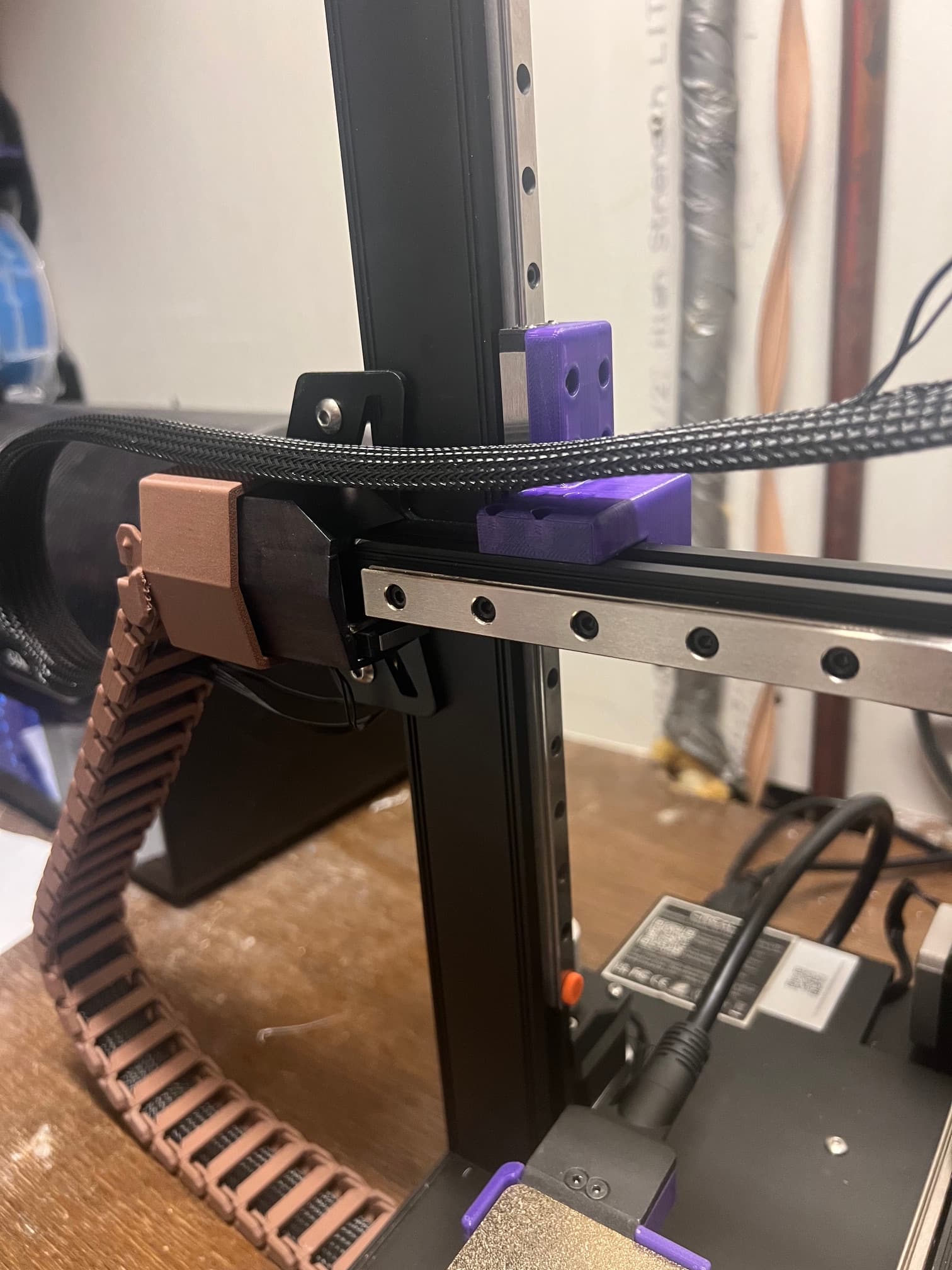

X-AXIS CONVERSION
The X-axis extrusion on my Ender-3 S1 has T-slots on only two sides. The face where the linear rail needed to mount is solid, so the rail could not be installed with T-nuts. I positioned the rail, laid out the mounting holes, then drilled and tapped the extrusion so the rail could be bolted directly to it.
This actually worked out in my favor because the T-nuts supplied for the X-axis rail were then available to use on the Z-axis conversion.

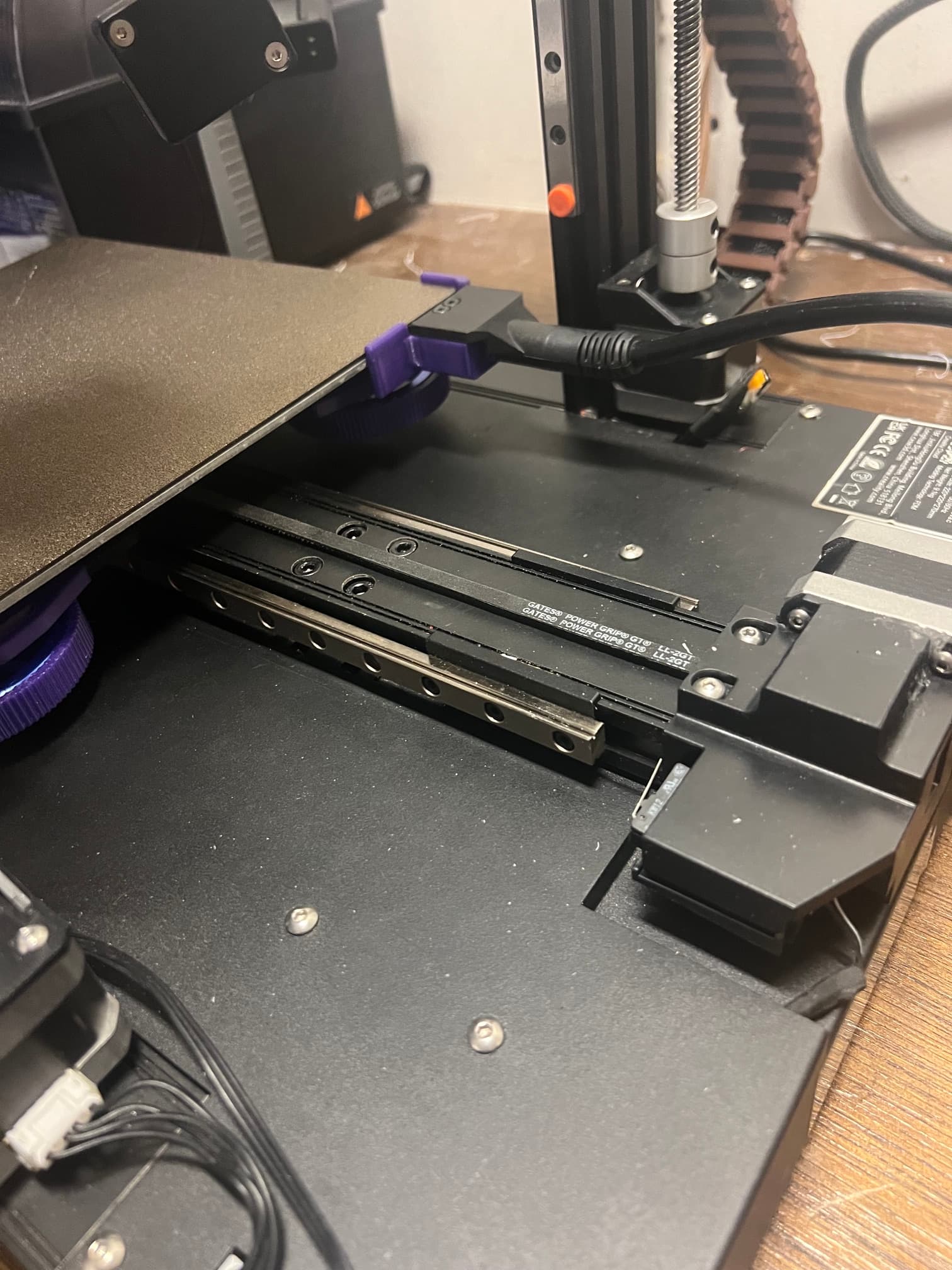

Y-AXIS CONVERSION
I made two simple spacers from 1/8-inch aluminum flat stock. I cut the material to size and milled it so the finished spacers were no wider than the linear rail.
With the rail positioned where it needed to be, I used transfer punches through the existing mounting holes to mark the hole locations on the aluminum spacers, then drilled the plates. One spacer has four mounting holes and the other has two. If transfer punches aren’t available, the hole centers could also be carefully transferred using a drill that closely fits the existing holes.
The mounting screws pass through the linear rail and the 2040 extrusion and through the aluminum spacers underneath. The 1/8-inch spacers raise the complete Y-axis rail assembly enough to provide the clearance needed inside the S1 base.

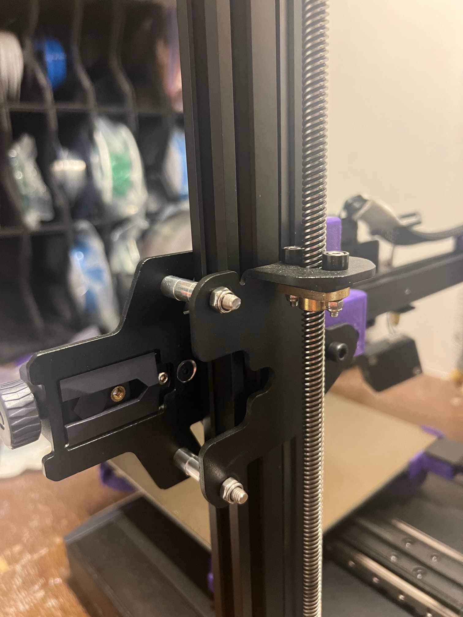

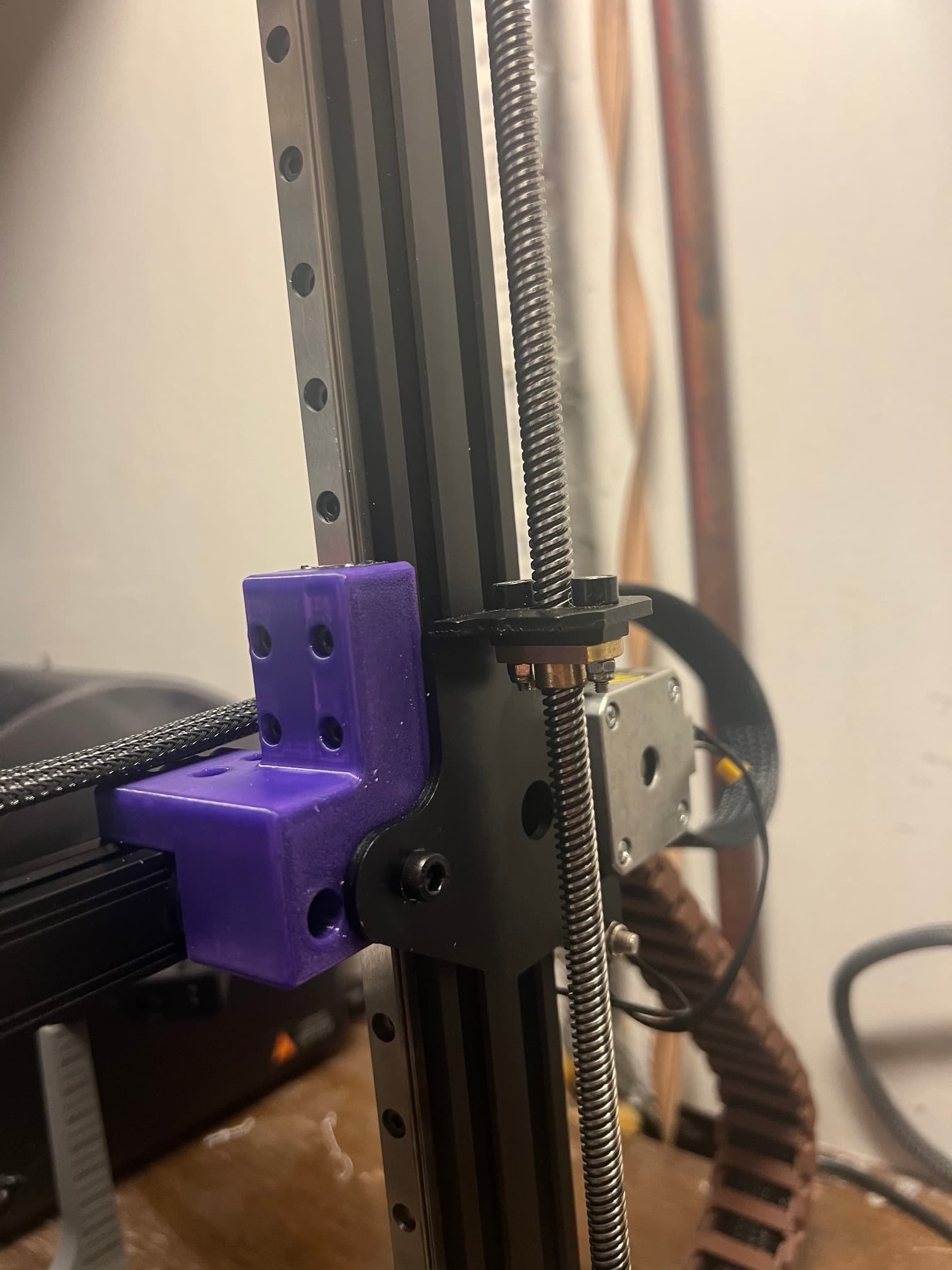

Z-AXIS CONVERSION

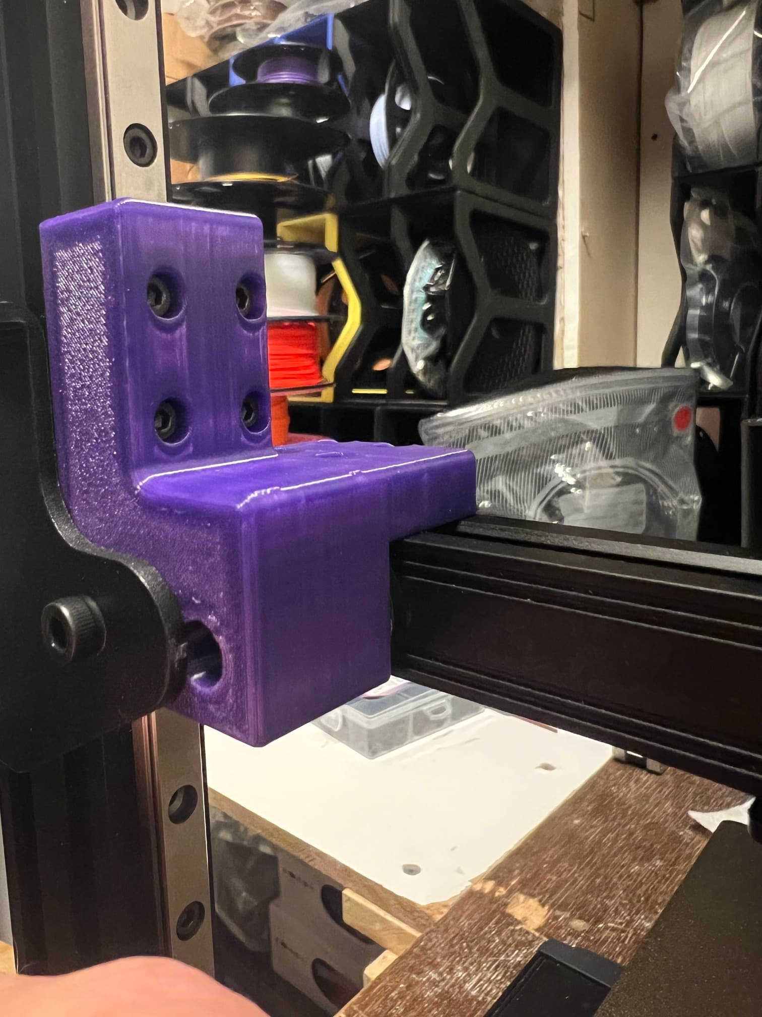

Both sides of the Z axis were converted to linear rails, replacing the original V-wheel guidance. The rails mount vertically to the existing Z extrusions, with one linear rail on each side of the gantry.
Because I drilled and tapped the X-axis extrusion instead of using the supplied T-nuts there, I was able to reuse those T-nuts for mounting the Z-axis rails.
For the gantry mounting, I was also able to reuse the original V-wheel hardware and spacers. Rather than discarding those parts when the wheels were removed, I reused them on the original gantry plates to provide the spacing needed for the printed adapter brackets and linear-rail blocks.
The original dual Z lead screws are retained. The lead screws provide the vertical drive, while the two linear rails now provide the guidance and support for the gantry.

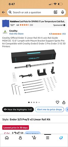

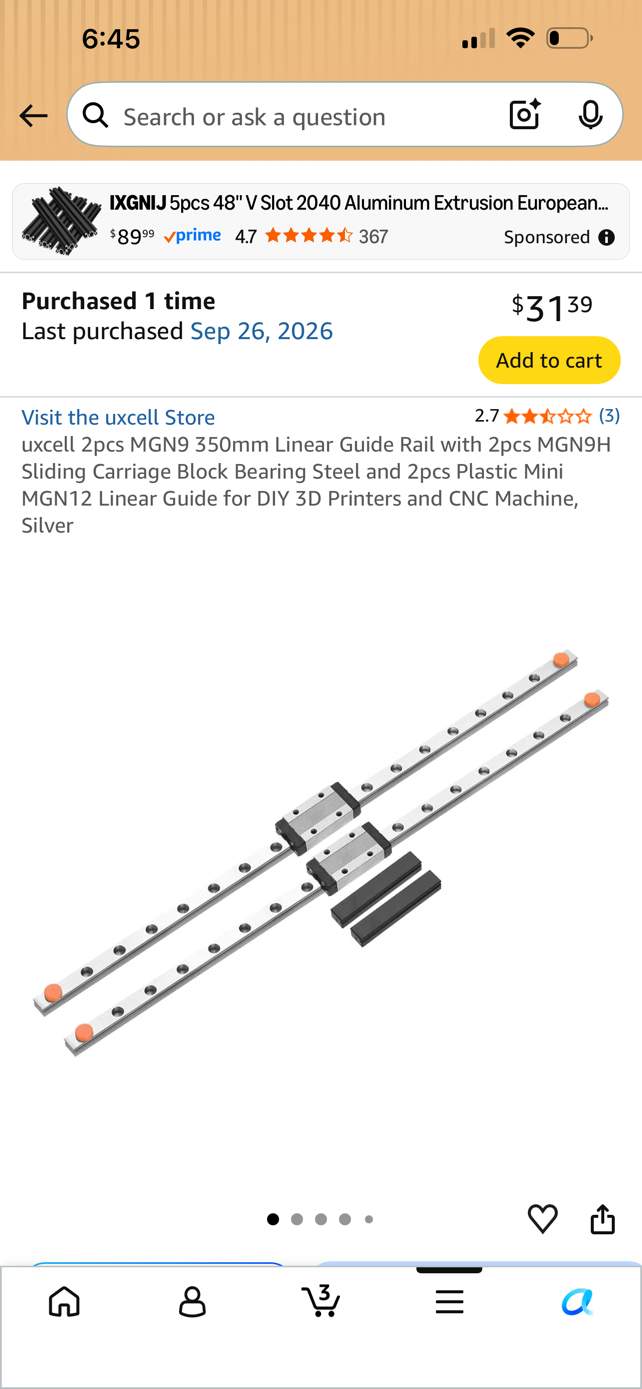

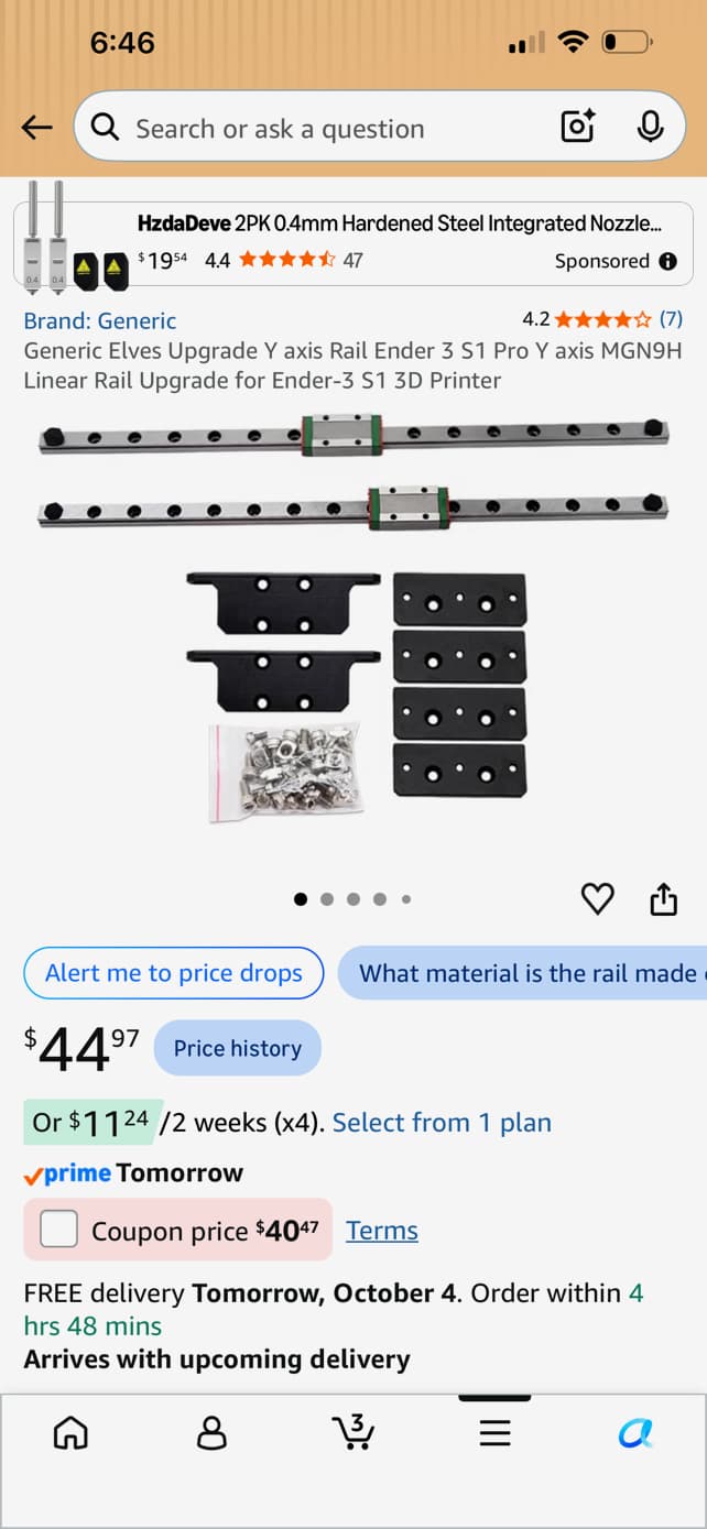

PARTS USED

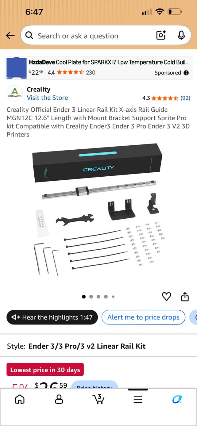

The linear-rail hardware for this conversion was purchased separately rather than as a complete Ender-3 S1 conversion kit. The following are the parts I used for the X, Y, and Z axes. I’m including screenshots of the original Amazon listings so the rail sizes, blocks, and hardware can be identified.

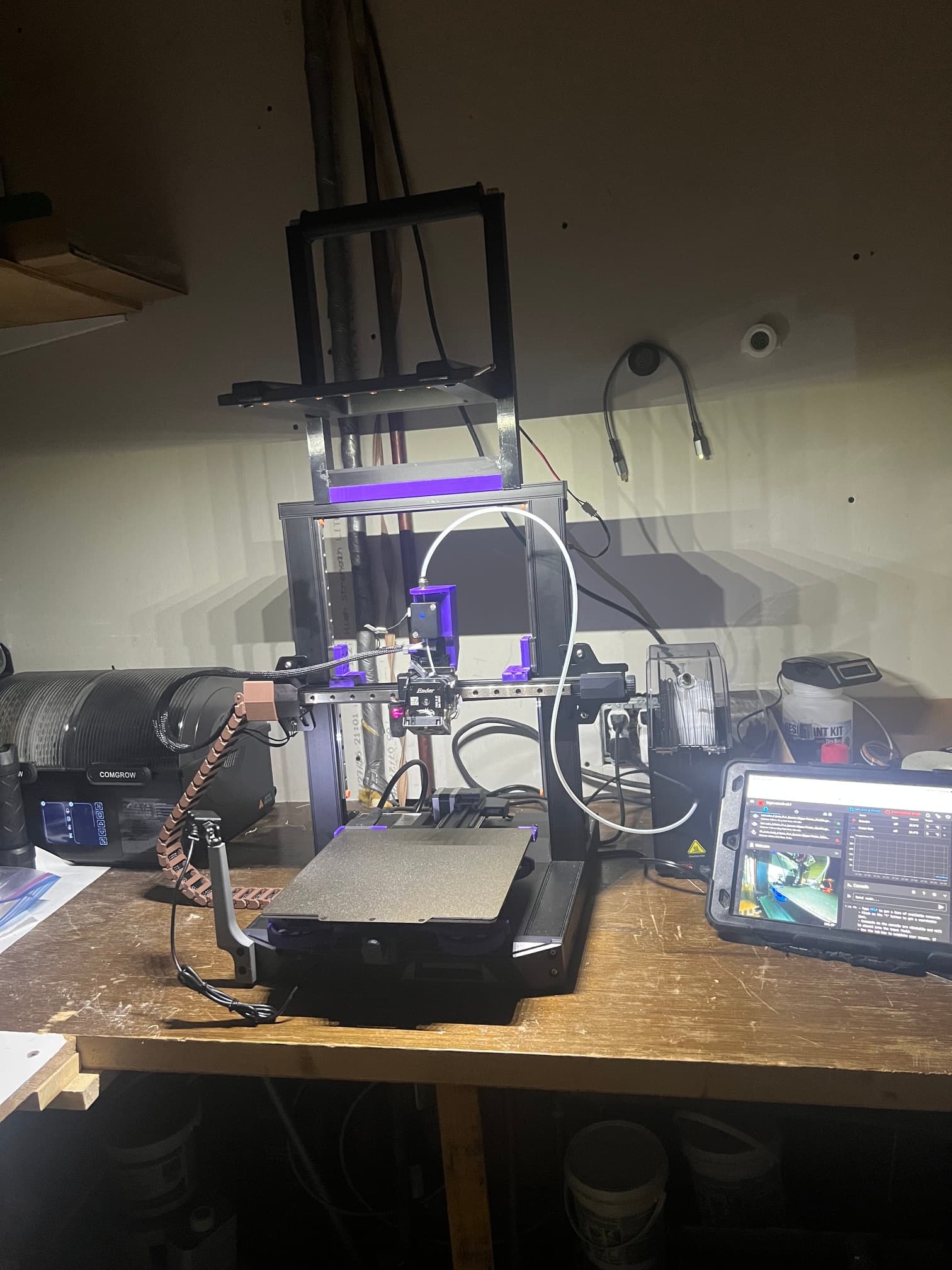

RESULT / FINAL NOTES
The conversion is now complete, with linear rails on all three axes while retaining the original dual Z lead screws.
This was not a bolt-on conversion kit. A few modifications were necessary to make the parts work on the Ender-3 S1, including drilling and tapping the X-axis extrusion, making the 1/8-inch aluminum spacers for the Y-axis assembly, and making the two printed Z-axis adapter blocks.
Overall, I was able to reuse quite a bit of the original S1 hardware, including the V-wheel hardware and spacers where they were useful. The temporary printed guides I made for the X axis also made it much easier to keep the rail centered while laying out and drilling the mounting holes.
The finished machine now has linear guidance on X, Y, and Z, and everything is installed and operating.

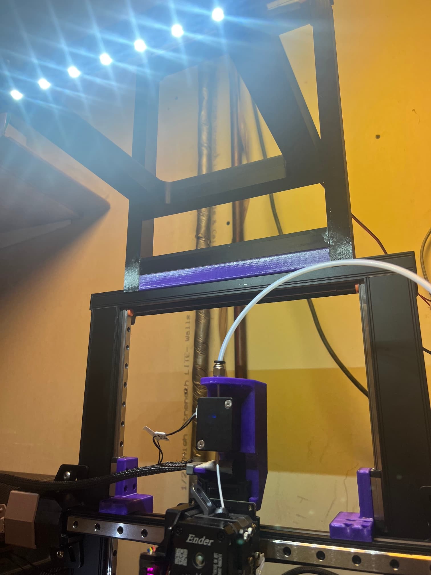

I also designed and printed the toolhead bracket shown in the finished photos. Its purpose was to relocate the filament sensor and provide mounting for the filament guide and cable support so I could feed the printer directly from the filament dryer I bought for this machine. The bracket went through several revisions before I got the position and geometry where I wanted them. This modification isn’t necessary for the linear-rail conversion itself, but for anyone wanting a similar dryer-fed setup, the bracket provides a way to make that arrangement work.
And this is where the Ender-3 S1 ended up after the conversion.
