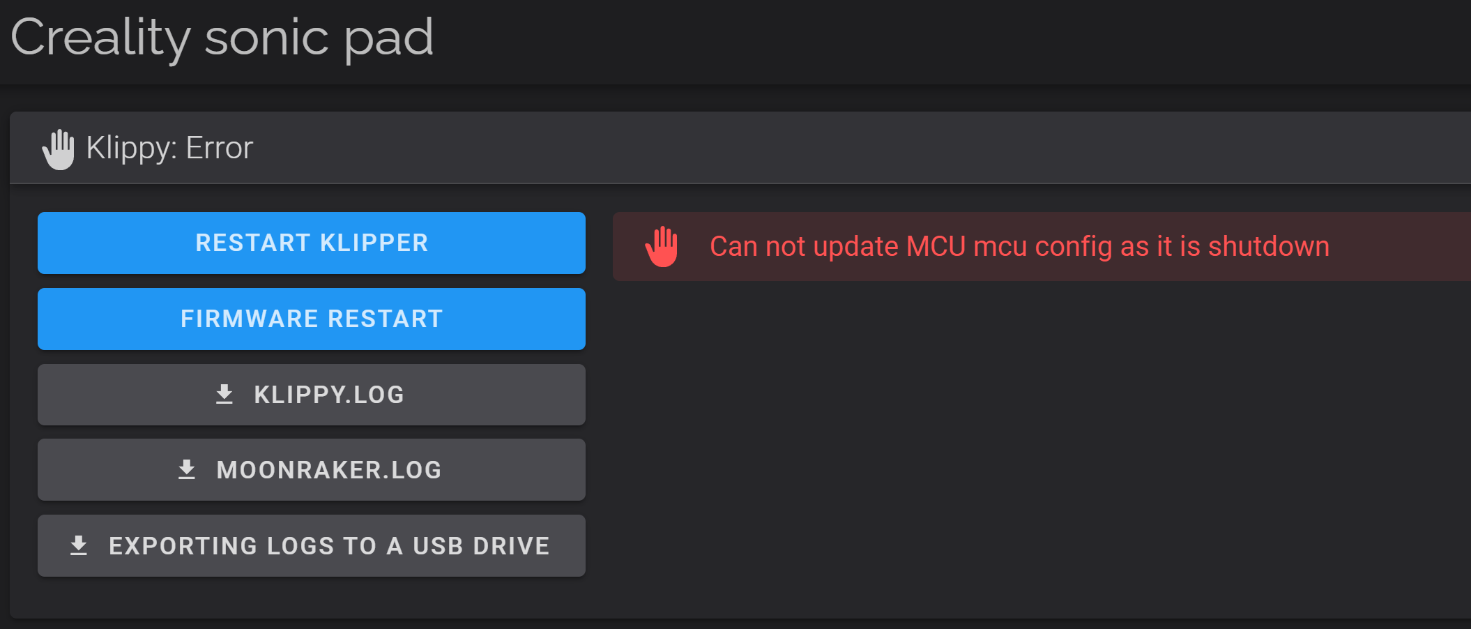

I have had some great success with my Ender 3 S1 Pro with a Sonic Pad attached. I started a long print and it got half way through and the print head just stopped, the Sonic Pad screen turned white and I would not connect to web UI. I turned it off and back on and it appeared to come back and I was able to start the print again. This time, part way through the warm up it froze again and I saw this on the console:
21:54:27 // Klipper state: Shutdown
21:54:27 // {"code":"key1", "msg":"Heater extruder not heating at expected rate
// See the 'verify_heater' section in docs/Config_Reference.md
// for the parameters that control this check.
Once the underlying issue is corrected, use the
FIRMWARE_RESTART command to reset the firmware, reload the
config, and restart the host software.
Printer is shutdown
It kind of seemed like the “heater extruder not heating…” happened to be what it was doing when it locked up, rather than the root cause but that is just a guess.
The screen is white and the web UI does reconnect but I see this:
Every minute or two the web interface reconnects but the Sonic Pad screen stays white.
No recent changes. I have just been printing lots of stuff and it failed mid-print. I was able to “preheat” for PETG and after a minute it was at 235C/60C.
After preheating, I started the print again and got a different error but the same shutdown.
Unhandled exception during run
Printer is shutdown
Not sure if it’s important but I looked somewhere after the failure and saw that memory (not disk) was at 99%. Not sure where I saw it.
