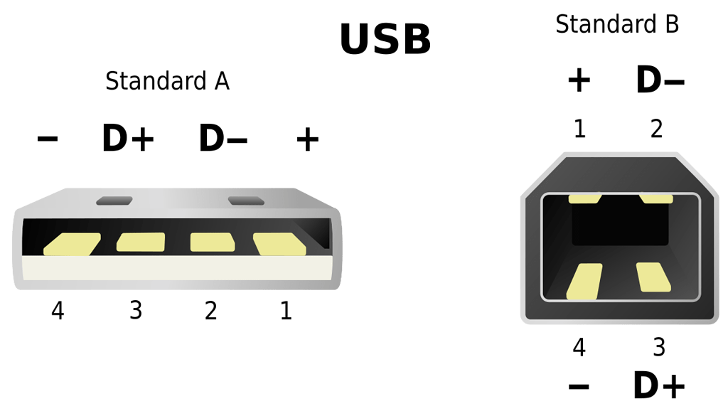

shot in the dark, based on a post elsewhere, but taping over the 5V pin, presumably on the serial end
Pins 1, 3 and 4 only should be connected. I think I have a better diagram somewhere. So tape over pin 6.
it was on Reddit
Or a USB power blocker dongle find them on Amazon too probably.
