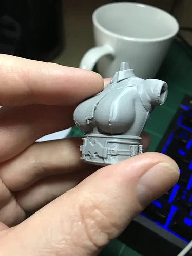

I’ve had the printer for approx a week.
Printed out a couple of benchies and they looked great.
I use crealitys CR-PLA filament

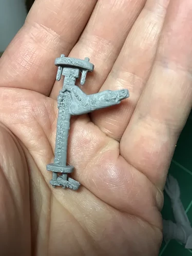

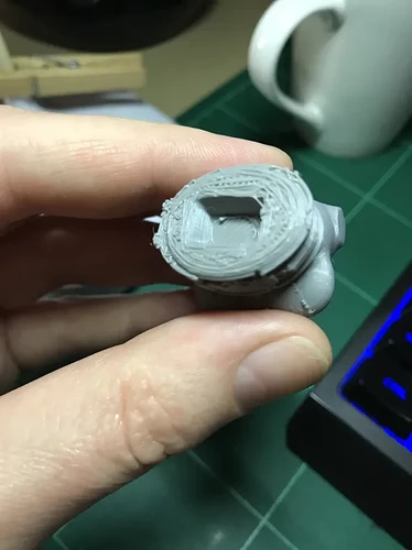

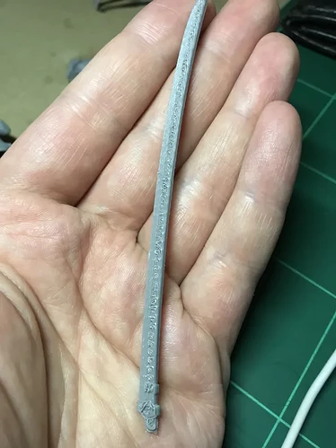

I’ve printed out a couple of pieces for a figure but the prints will always have the start of them messed up while the rest looks great.
I’ve updated the printers firmware, tried different slice-programs (cura and crealitys) but the prints remain the same. I’ve attached some pictures to show what i am talking about; Hope someone can help :slight_smile:

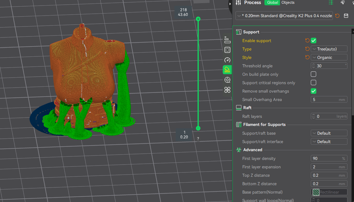

Maybe you can provide a 3mf file? thus i can better help you analyze the cause.
Hello Jeef and thanks for replying. I am still very new in 3D printing so i hope i attached the file you need. I made the 3mf file in Cura with the print settings i used for all attached pictures in my post.

You should adjust the placement angle of the parts. It would be best to place them upright.like this:
I also gave that a try, it did the same thing; i did notice though it messes up the print where support structures are; like the tie on the bust in 1 of the pictures in this post. But at the very bottom of the bust print, there were no support structures.
