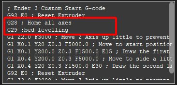

Hi. I upgraded my old ender3 v2 similar to yours I also added duel z drives and sprite pro direct drive extruder. Also I added the BTT tft 35 display.
If you require bed leveling before each print add G29 after the G28 in the machine start print section in your slicer.
cura;-
There is a much later version of marlin available from the marlin website but you would need to learn how to setup the config files for your printer and control board.

Thanks for the tip with the leveling g-code! I will implement for sure in slicer.
