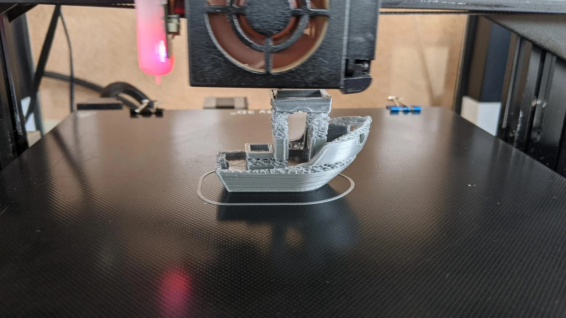

Hello everyone,
So i’m having a few problems with my ender 3 V2. Everytime I print something, The model gets all strage, like this:
I level the bed all the time, since every time I finish a print, the hot bed threads become loopy. I believe this happens during the printing process;
  • Plus the printing models get all like this:
How can I fixe this?
I would try a new print nozzle or try to clean it if you don’t have another.
It would help to know what filament you are using.
Some things to look at:
The spool is in a bind and dragging. The extruder is slipping on the filament, unable to pull enough filament.
The filament is going into the extruder at too much of an angle and causing drag.
Bowden tube is at too much of an angle, at the extruder or hot end, and the extruder can’t push the filament around the sharp bend.
Extruder drive wheels are dirty and can’t get a bite on the filament.
Filament needs to be dried. If moisture gets in the hot end, it flashes to steam and pushes filament out quickly.
