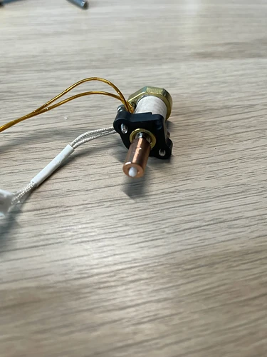

I need help to fix my printer. It started since some weeks doing this. At some point the filament is not extruding anymore. Disassembled hot end reveals that there is a broken piece of filament in it that I can get out only ripping apart the entire hot end. What I have tried:

This is condition. It seems that the plug is melted. Not sure if you can see but during printing the fan is off.

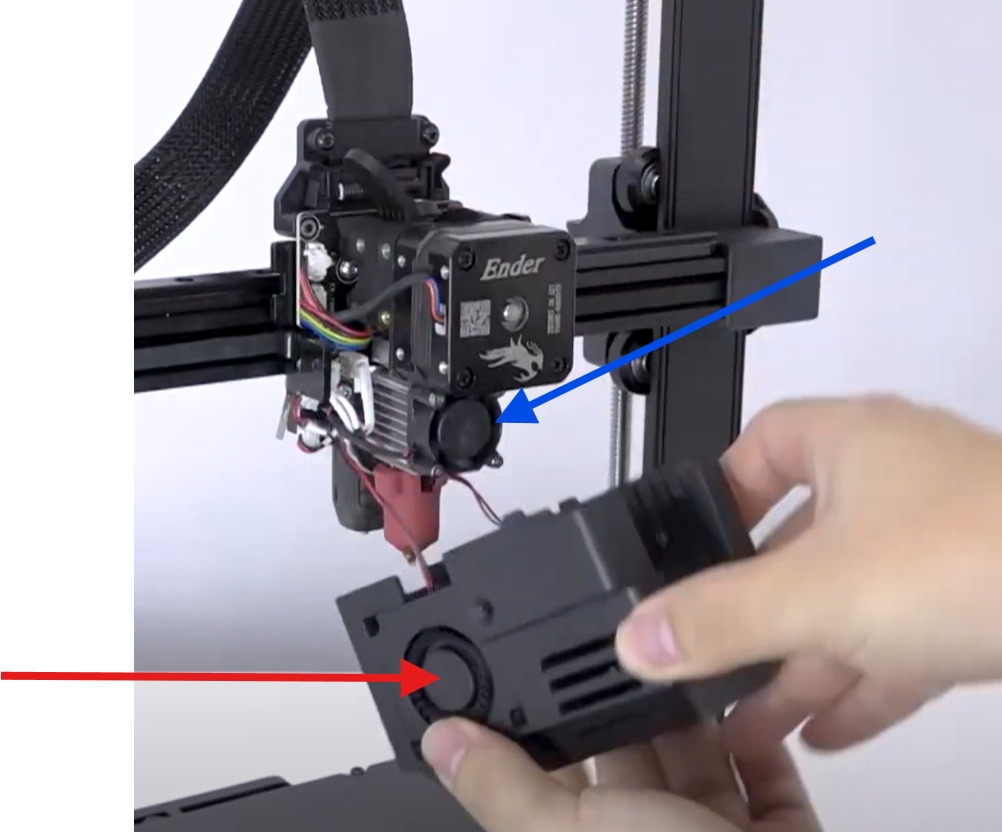

Sorry for my late answer. I think you’re confusing the part/model fan and the heatsink fan.
The Part/model fan is the one you can control thanks to the screen or the slicer. Its job is to cool the filament leaving the nozzle. It’s generally off during the first layers (to avoid warping)
The Heatsink fan is the one that you can’t control. It actives as soon as the hotend is hot. Its job is to make sure the heat of the hotend doesn’t go up. It only stops once the hotend is cold so it’s always on during printing.
Currently searching for a photo. Give me 10-15minutes (EDIT : OK, maybe more . Waiting for my contact, owner of a KE
Sorry for the late response. Actually you are right, the setting about the fan you were referring to was about the two fans on the cover.
