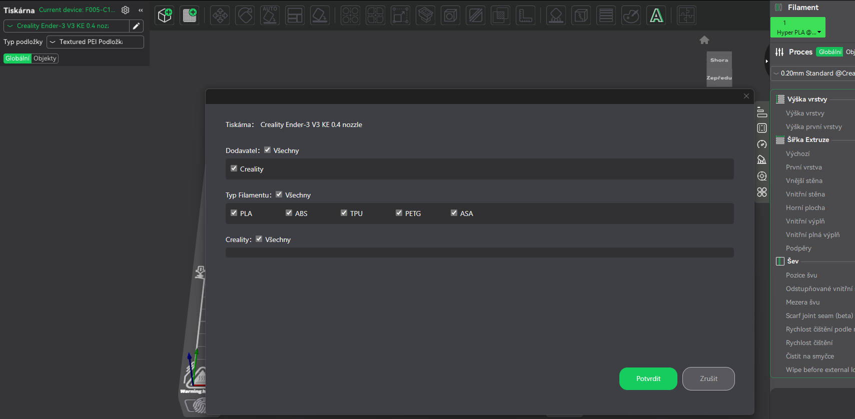

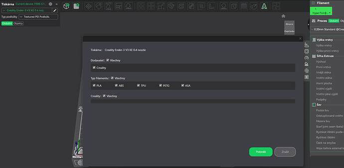

Hello everyone. Does anyone have a problem after installing Creality Print 6 with not being able to add new print material. I can’t seem to do it. I only have the option to add the 6 basic ones from Creality and nothing more. When I click on add I have no option. If I change the printer to K2 for example, it’s OK. But for Ender 3 KE it disappeared. I also tried going back to Creality Print 5.1, which I seem to have uninstalled in a hurry, but it’s the same there. I used to be able to use about 30 different materials with this printer. Can anyone tell me where the problem is?

You go to filament under the basic ones there stands add filament. Like e-pa nylon filament.
If you add and go back.
But you still dont see the filament or own setup one.
Go back click on the custom filament then you see your filament. to youse click again and there you have to click/add it…
go back and you see your filament.
