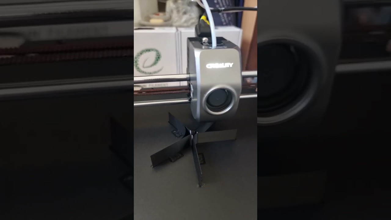

I don’t think the bushings are defective, as it is a problem that many users have. Something misaligned or something loose I think is an option. I haven’t found a way to fix it yet.
Is the same sound. If you have time can you try to increase speed of first layer and check again?
Does anyone know which screws Kochlewsky was talking about?
Removing the front casing, below in the nozzle area you can see 2 screws holding the bushing. I also loosened them but the noise persists. I tested removing the XZ belt and moving the head by hand at different speeds, the noise disappeared, which gives me the impression that the bushing is not a problem. I reassembled the belt, I made it looser, more tense and the noise is there again. Could it be that the motors reflect this noise on the X axis? It’s a mystery.
Ok, thanks. The screws were very tight, too tight in my opinion. When I loosened them and left them like that the sound became softer. I wonder if something was damaged by this. The bearings themselves or their mounting.

For the issue, I noticed that the sound goes away if I squeeze the rods together by hand so the sound is generated from bushings. The why is the question, is it defected bushings or rods or if there is play between them or some other gap out of tolerance.

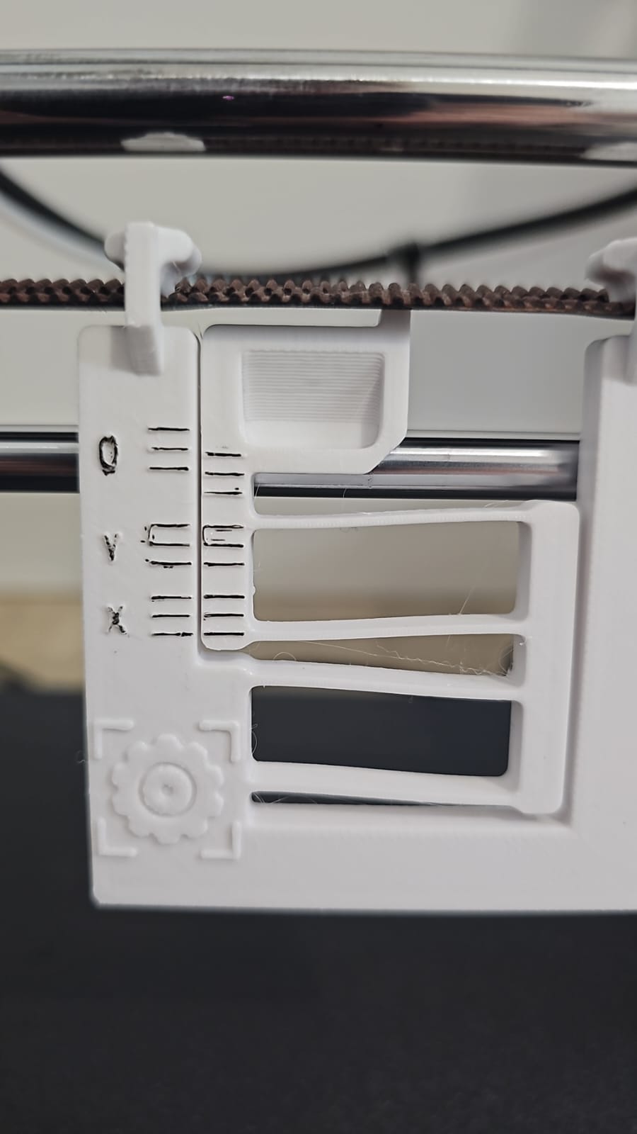

I had the same issue with one of my two E3 v3 plus. I noticed that the belts on the one that was working perfectly were MUCH looser than the one with the ugly noise. Also, the first layer on the one with the noise was not exactly great, either. I manually loosened the belts (disregarding Creality instructons) to match the tension of my “good one.” This fixed the issue for me.

Loosen the belt, I’ll solve it! On the internet there is a tool that tensions the belt, use it to adjust the belt.
Link below this tool
[quote=“Lucas_Claus, post:57, topic:15719”]
VFA
[/quote]I understand, it is apparently correct, you can try to loosen it a little further than the tool reference and test to see if it generates the VFA, if it does not generate the problem is something else.
I loosened the belt a little more but the VFAs persists, its making me crazy
