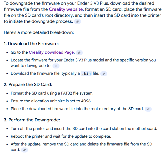

Note: If your printer is working without any issues it is not recommended to update firmware.
For a motherboard version # CR4CU220812S12 try to go down to version 1.2.3.8 and see how that works otherwise I’m not sure what else to try.
Firmware download. Get 1.2.3.8
I haven’t done this myself but these are some basic instructions:
Hey! @jimandyen
I just did what you mentioned here, and it worked perfectly! Now, suddenly, the Network tab is here. Pretty sure the problem is in version 1.2.3.90!
I used the USB drive that comes with the printer and formatted it as mentioned.
