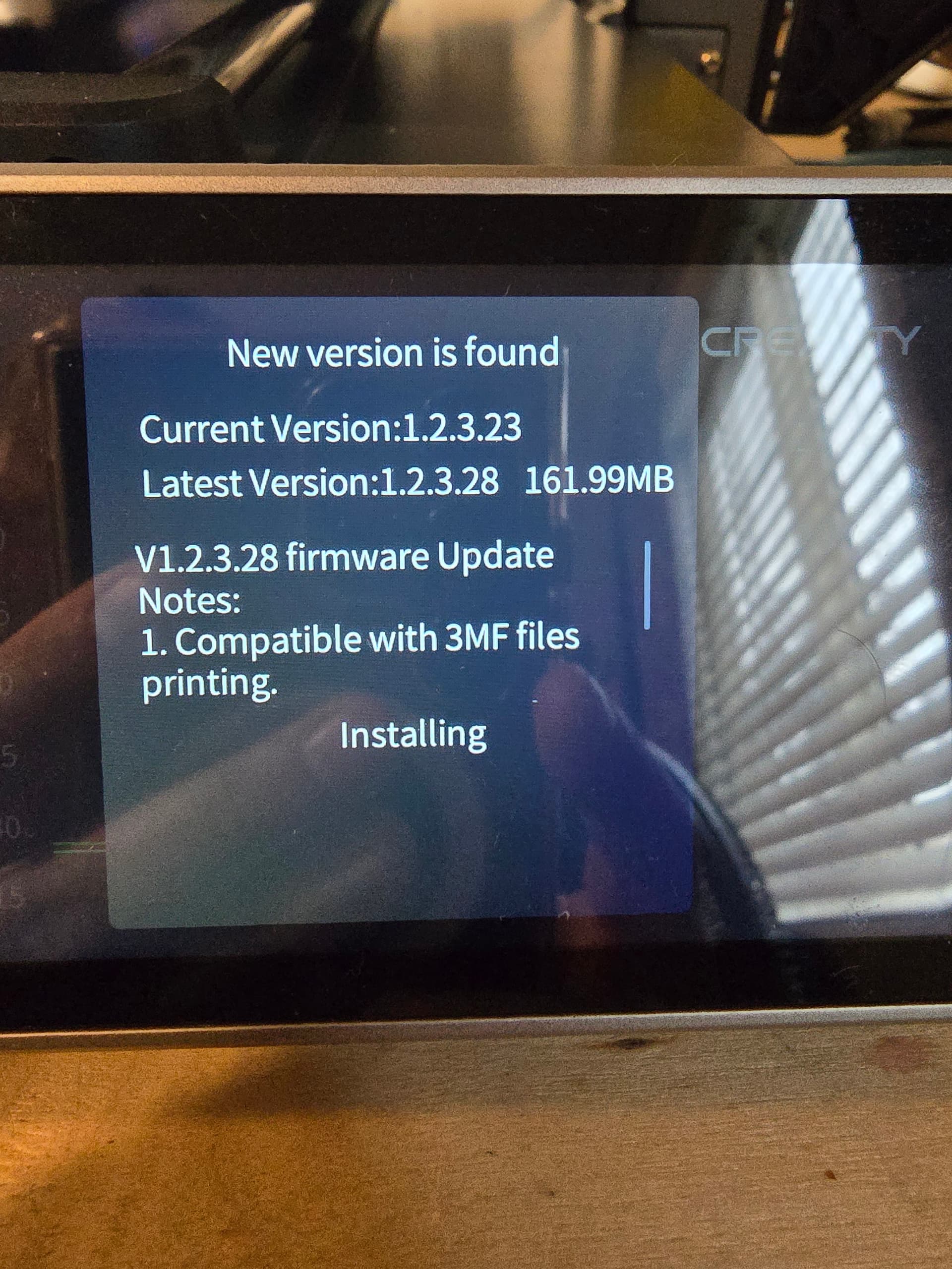

Try updating the firmware once, or if it’s already on version 23, downgrade it to version 21.
Then do a factory reset on the machine and run the auto-test again.

Looks like im on this version

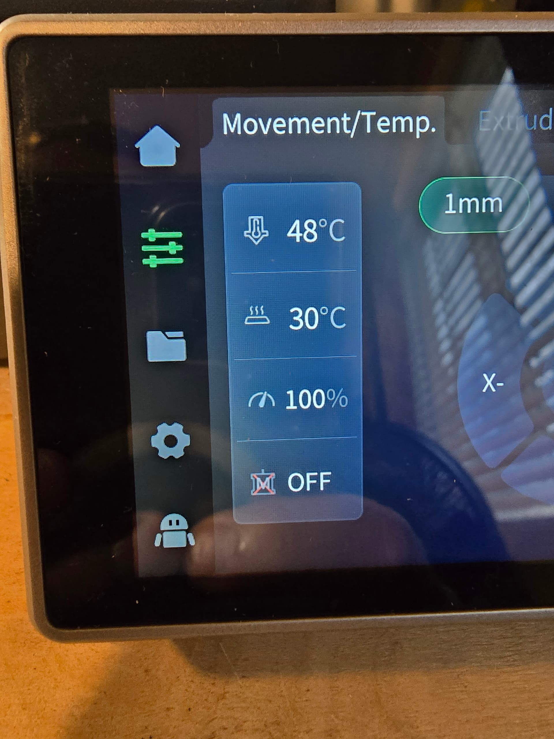

Also there is this red X over the M on movement and temp? What does that mean?

The red “M” icon is to put turn the motors off so you can move the printhead easier.

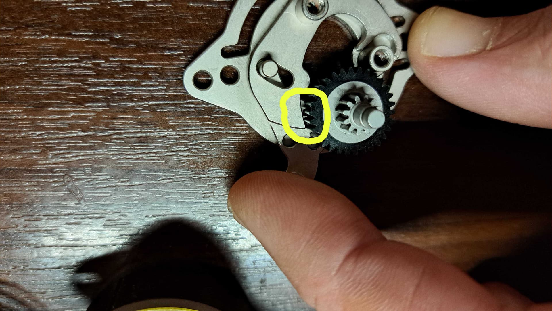

I have the same problem. I found some factory defect.
In this place gear stuck on metal part. And sound like on Your video (I had the same sound,). To solve this problem I made metal part bit thiner (for 0.5 mm in my case). And it fix my problem.
