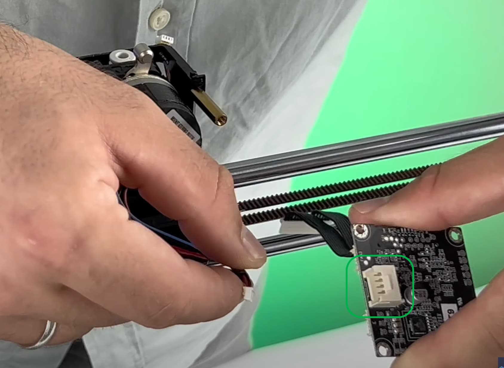

  3. This image only highlights 3 of the 4 connectors that need to be removed: https://github.com/coprint/Wiki/blob/main/Wiki%20Images/tumkabcik.png?raw=true
  4. This image highlights the wrong connector to be unplugged:
