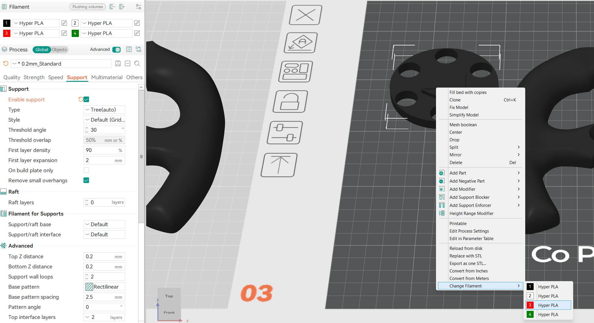

I’m not sure I understand what you are asking, but do you have firmware 1.2.3.63 installed? In that case the printer is expecting FILAMENT_CHANGE LAYER_NUM=[layer_num] NEXT_EXTRUDER=[next_extruder] for filament changes.
if you set your filament types and set each part to use the proper filament, the gcode does the rest
Or you can also use Orca Slicer paint options

So next up printing so installed OrcaSlicer and to be fair Creality did include it on the flash drive that came with the kit set up all the necessary parameters painted my test peace with 4 colours sent it to the printer using fluid and hooray success printed my 4 colour test block.
