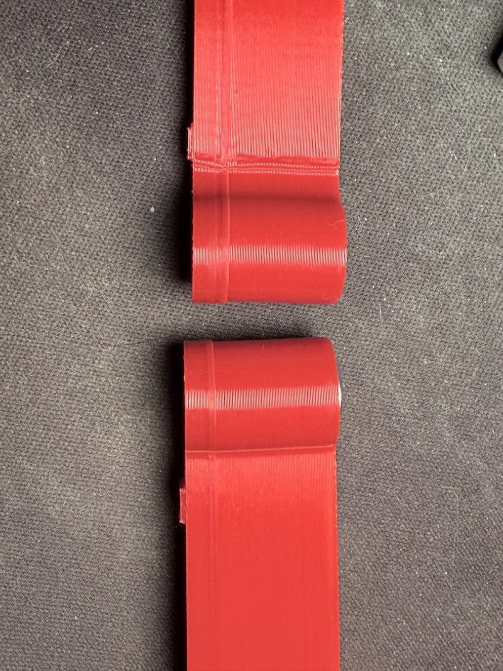

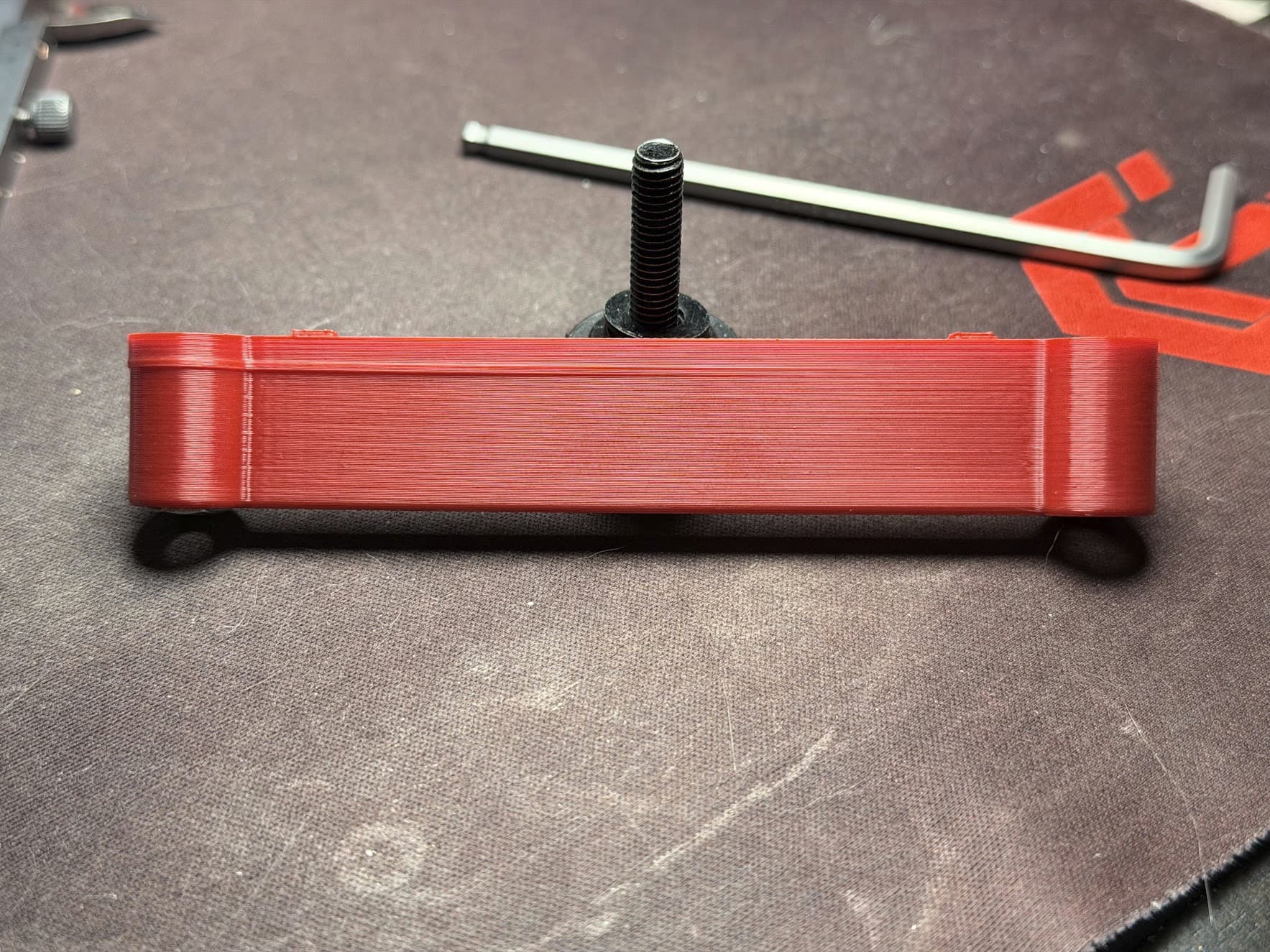

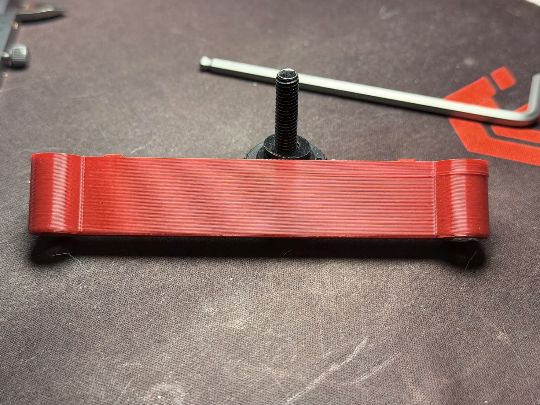

I noticed weird line in my prints around 16mm mark and it only appears on one end of a long thin part.
Looking more closely it seems this is exactly around the mark where the Z-axis bottom springs disengage, so that is probably causing some issue with the Z-height either creating too thick or thin layer or layers for a moment.
Is it safe to remove the spring, would that fix the issue or are there other solutions for this issue?
