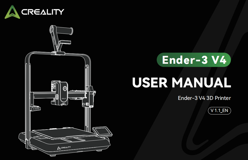

Ender-3 V4 User Manual

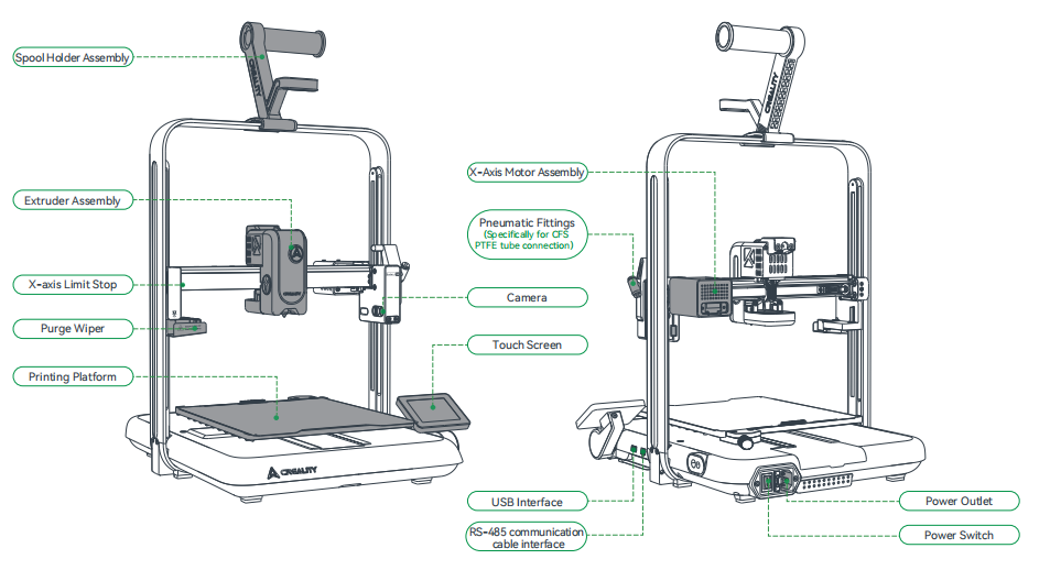

1. Printer Information

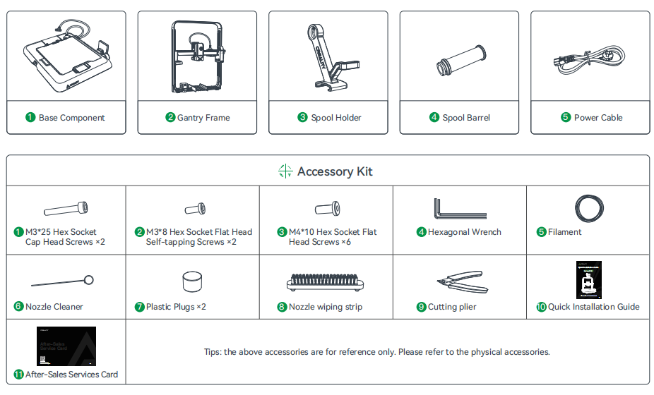

2. Parts List

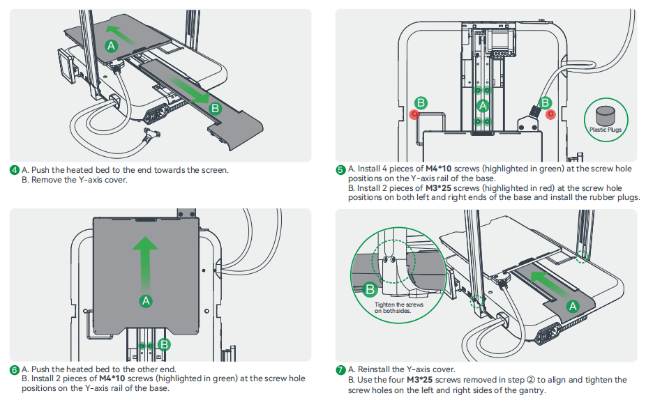

3. Assembly Procedure
3.1 Gantry Frame Installation

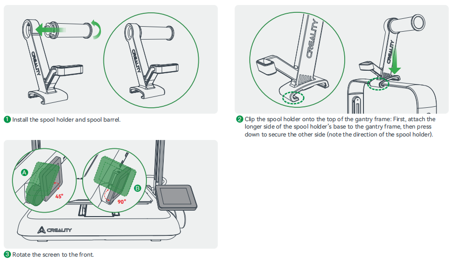

3.2 Install Spool Holder Assembly and Rotate Screen

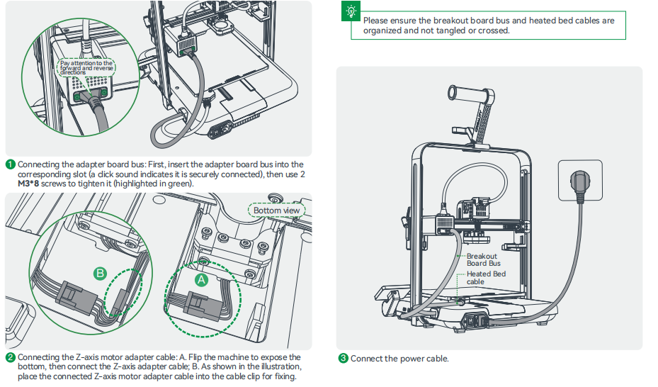

3.3 Equipment Wiring

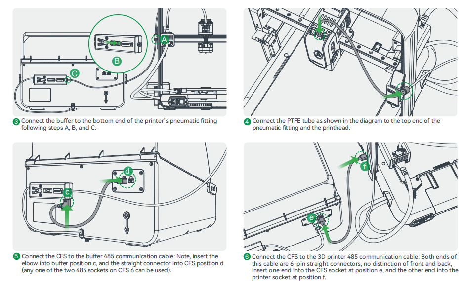

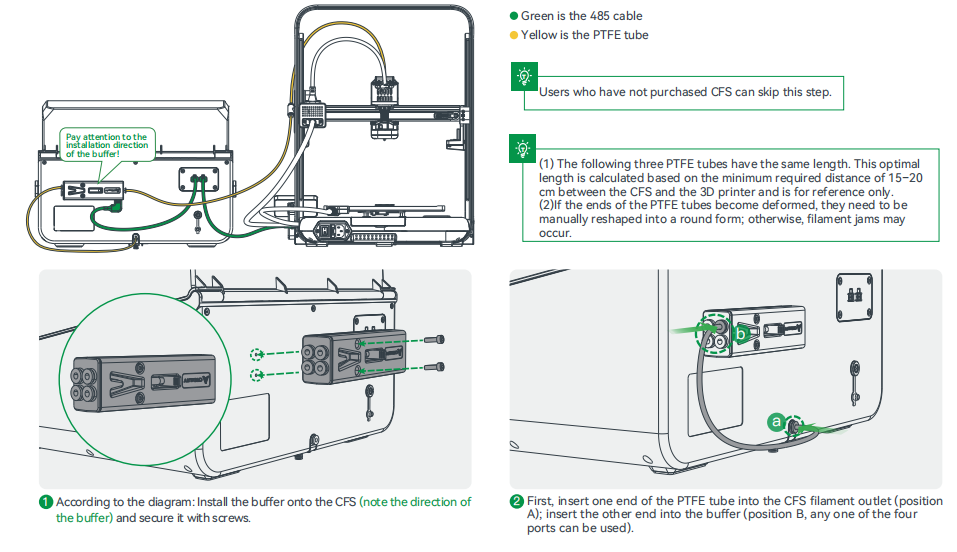

3.4 Connecting CFS

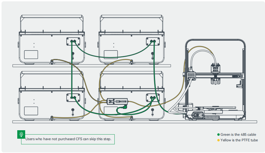

3.5 Connecting Multiple CFS

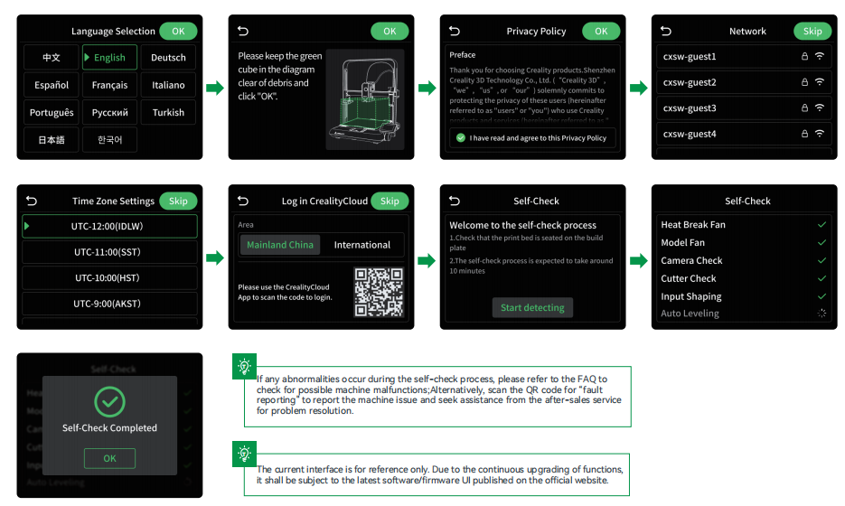

4.1 Power-on Guide

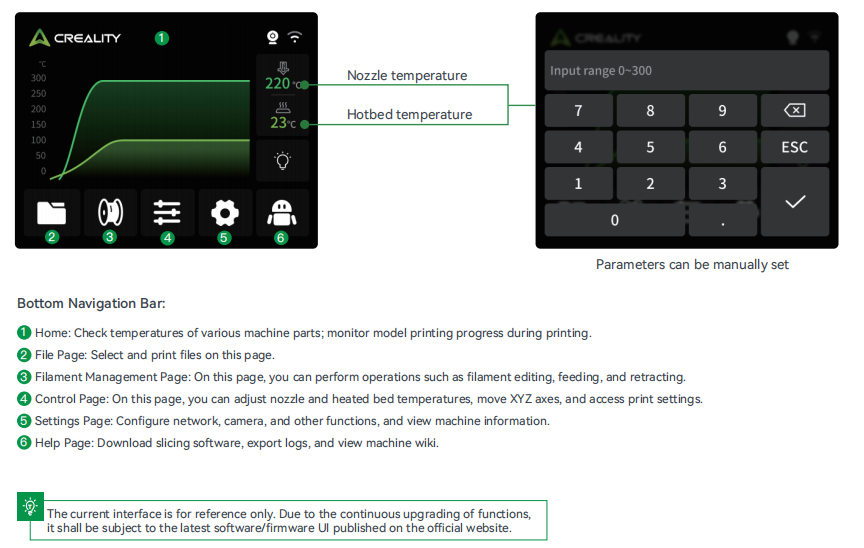

4.2 About the User Interface

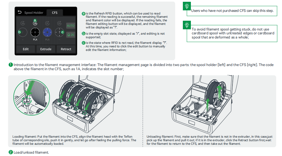

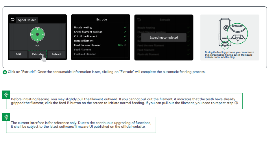

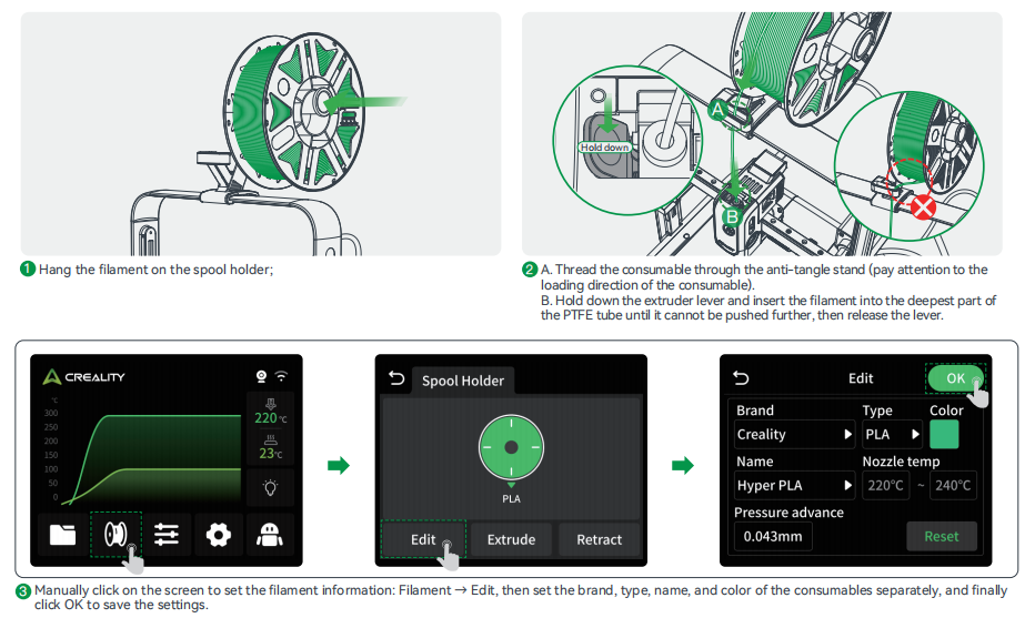

5.1 Spool Holder Filament Editing/Loading

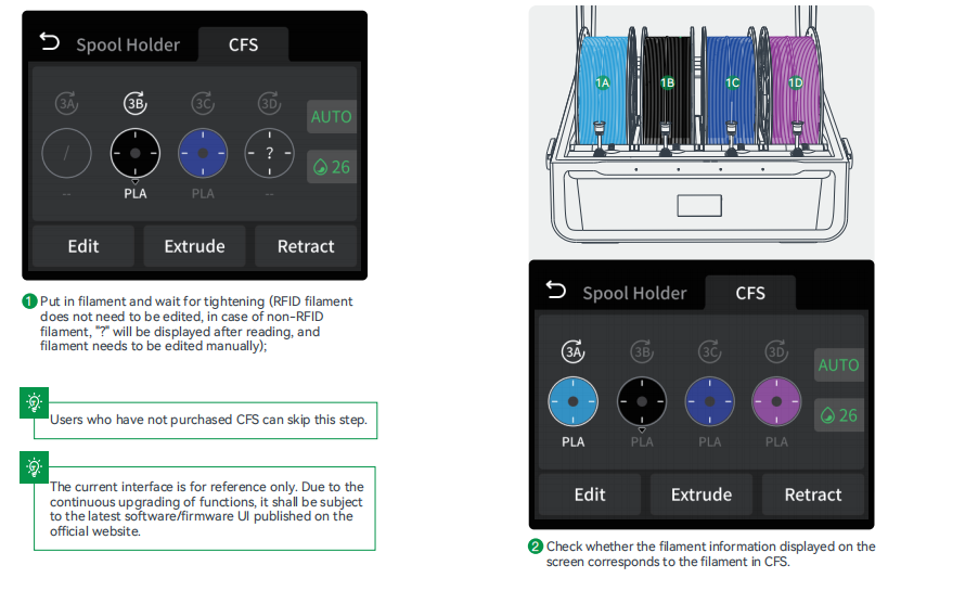

5.2 CFS Filament Editing/Loading

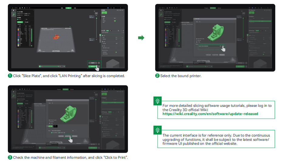

5.3 LAN Printing
5.3.1 Software Download and Installation
5.3.2 Bind Machine to LAN
5.3.3 Slice and Send to Print

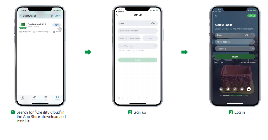

5.4 Creality Cloud Printing

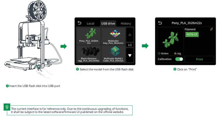

5.5 USB Flash Disk Printing

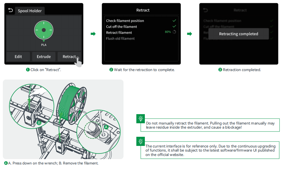

6.1 CFS Filament Management/Loading/Unloading

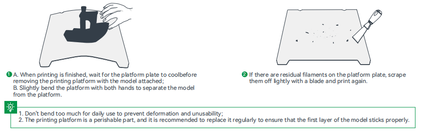

7.1 Platform Plate Removal and Maintenance

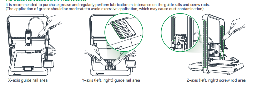

7.2 Guide Rail, Lead Screw Maintenance

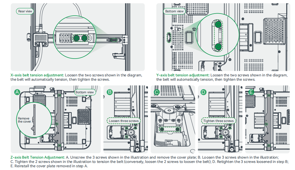

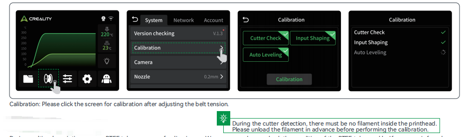

7.3 Adjustment of Belt Tension for X-Axis, Y-Axis, and Z-Axis

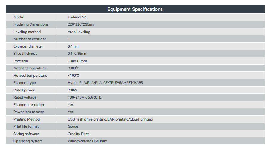

8. Equipment Specifications
