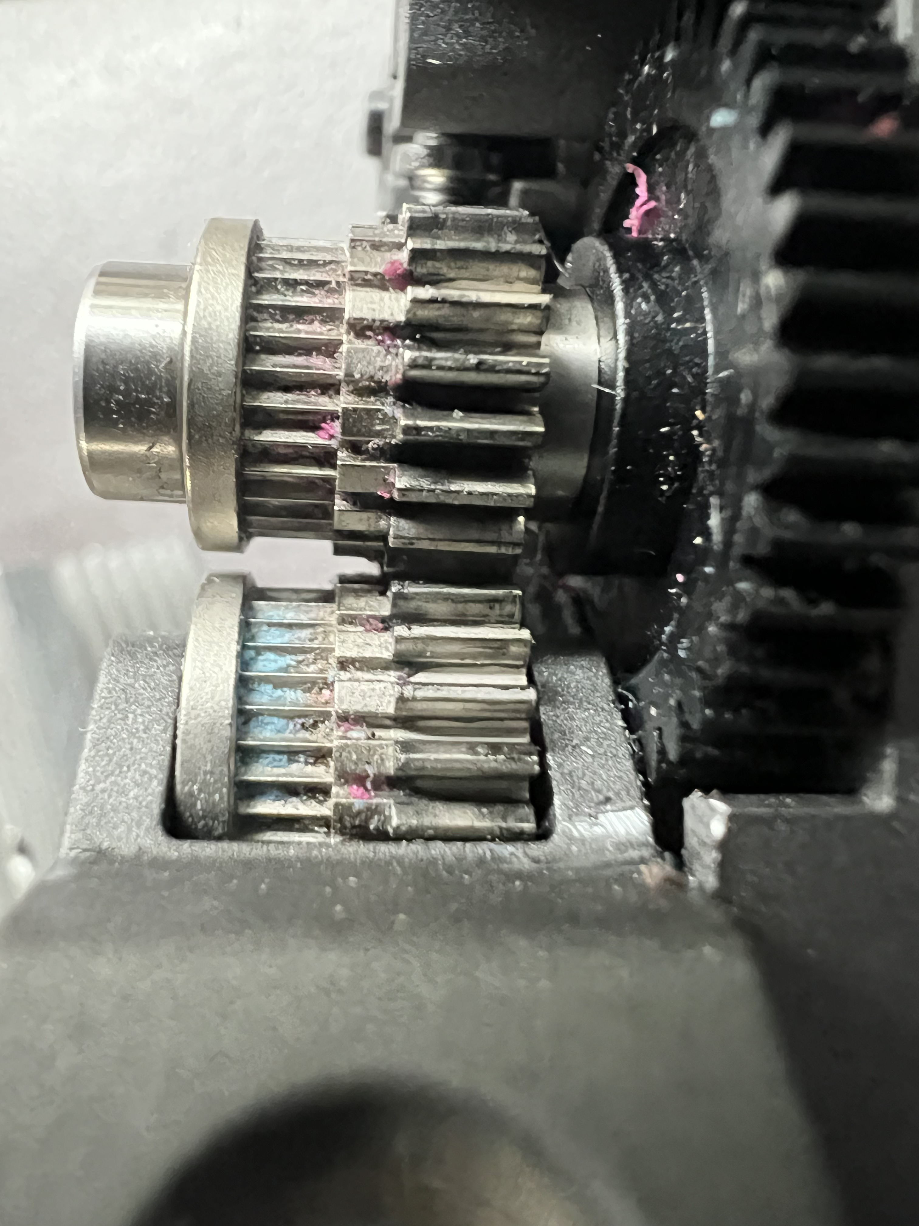

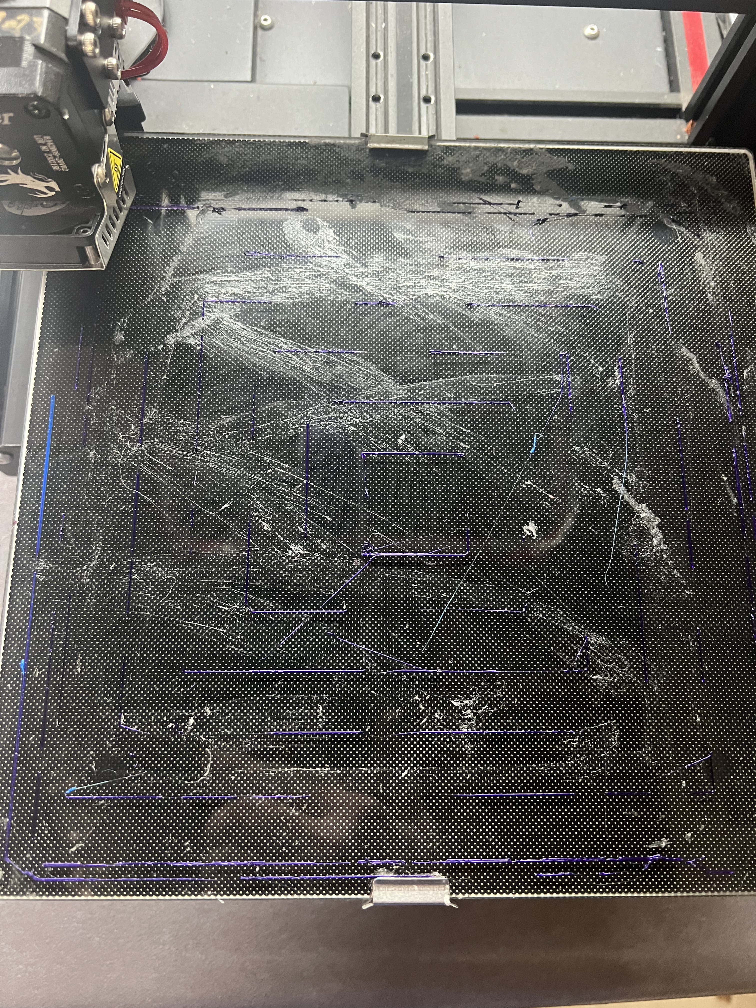

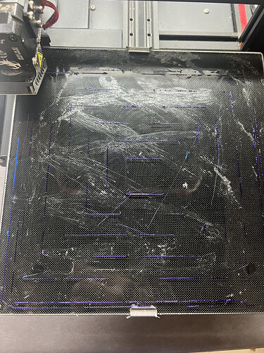

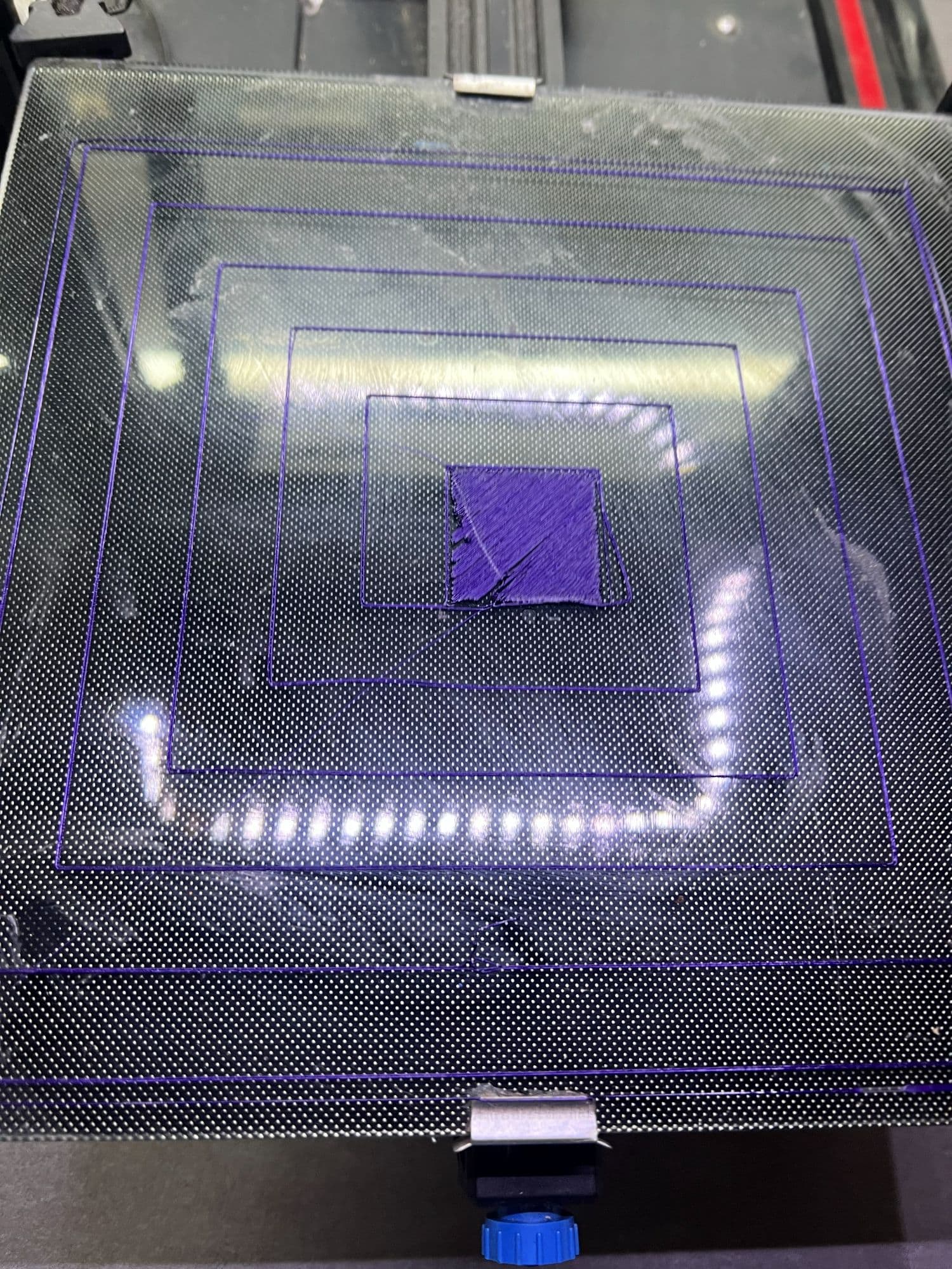

The filament extrudes in dashed lines (see image), which makes me think there is an issue with the gears in the extruder.
Running this bed test:
Rectangular Spiral Z-Offset/Bed Level Test by TankerTech | Download free STL model | Printables.com
I tried:

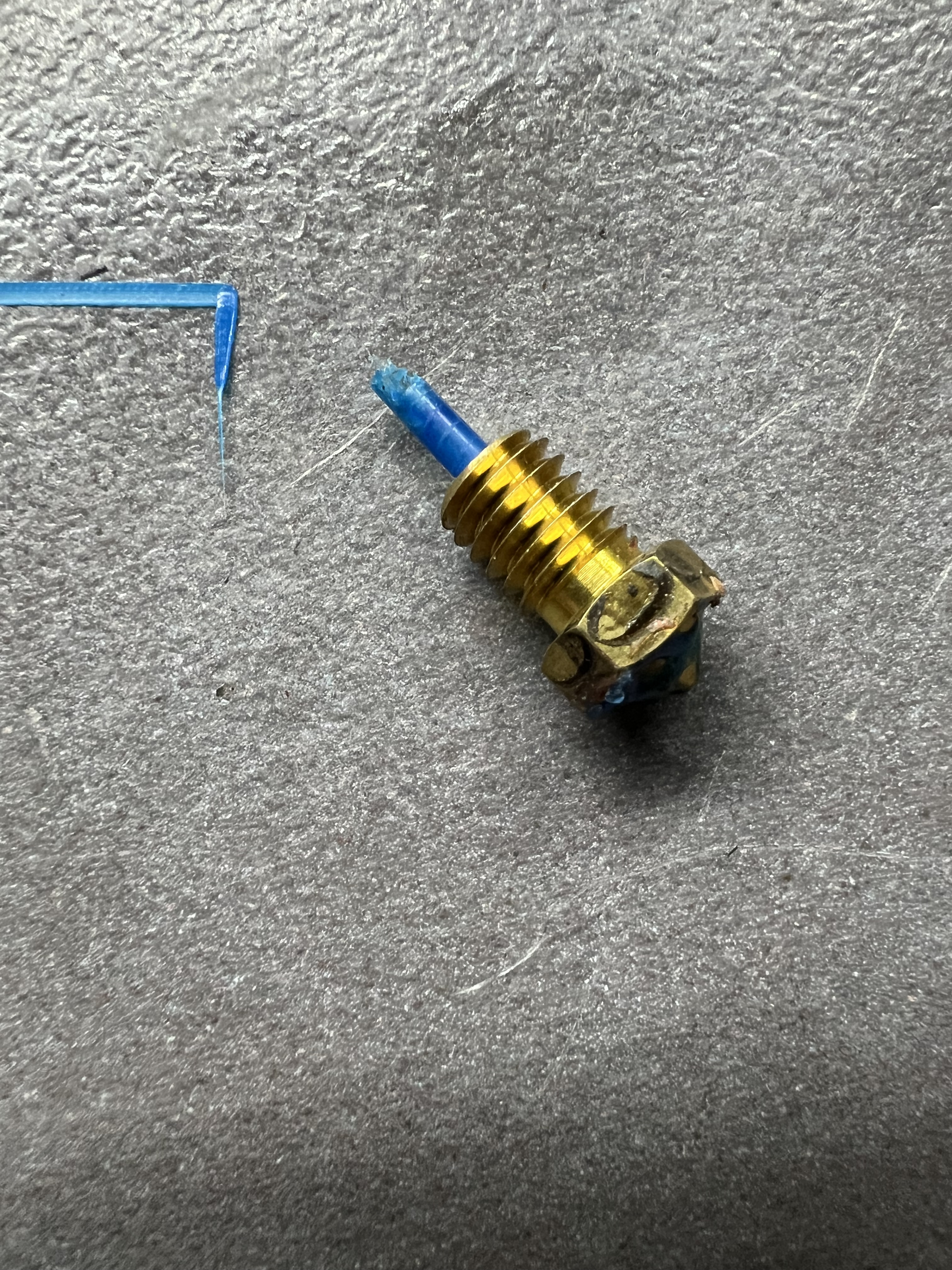

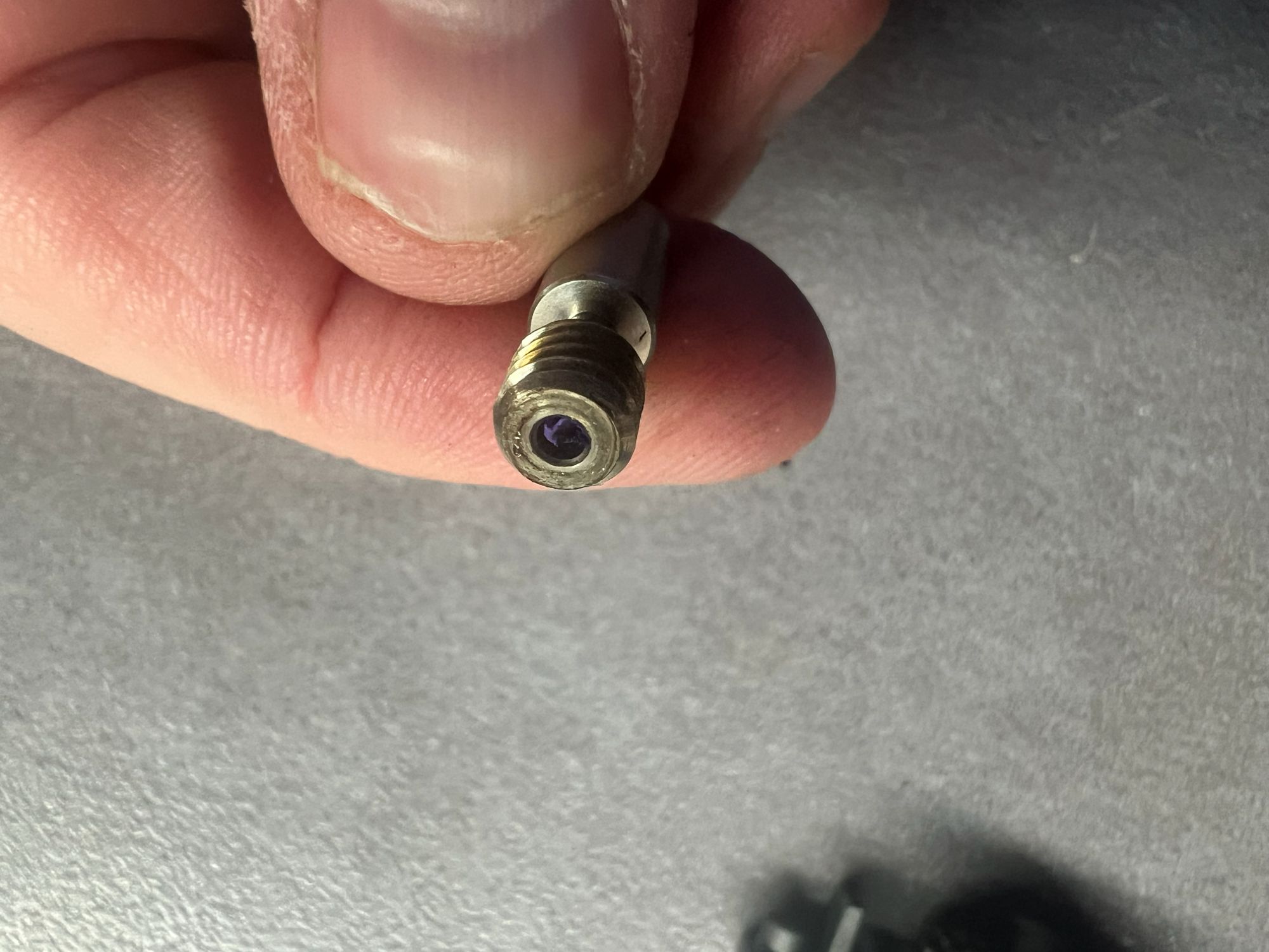

There was filament stuck in the nozzle, which I removed

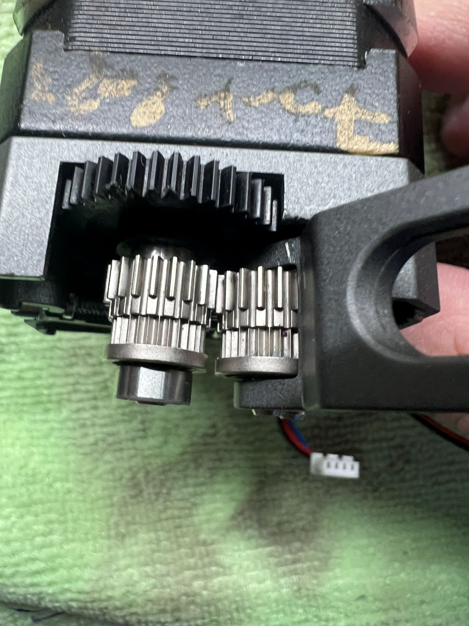

The gears on the direct drive did not look clean, but I’m not sure how to fix this :
**Is there a way to fix this? **
Or does Creality sell sprite pro gears as a spare part?

You can clean the extruder gears with a small brush, (old Toothbrush maybe).
I would replace the nozzle, just to be sure.
Did you check the nozzle height to the bed?
I would also suggest to check the tension of the extruder gears. If there’s a spring tensioner, it may need to adjust it so the gear grip well on the filament.
If you can replace the gears, give it a try. I replaced mine once, and everything is cool since then.
Then check if your printer Over- extrudes or Under Extrudes.
Where do you purchase new gears from? Please supply a link to where these can be purchased.
I will try cleaning the gears as recommended by Ben_Engelen.

I’ll also try replacing the nozzle, maybe the supplied one has failed.

Check this link for the gears

Now FIXED !

  2. Removed Sprite pro extruder and disassembled.
  3. Cleaned filament feed gears
    (Soaked in hot water with detergent - then scrubbed with old toothbrush)
  4. Replaced Nozzle (which was clogged) with hardened steel nozzle.

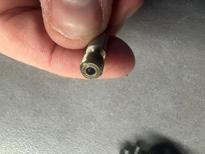

  5. Removed and cleaned heat break which was clogged with filament gunk.
    (Used kitchen butane torch to heat and melt all the clogged filament).

  6. Reset tensioner on gear pressure. Spring had buckled due to excessive tightening.

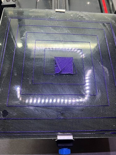

  8. Test print OK. :smiley:
