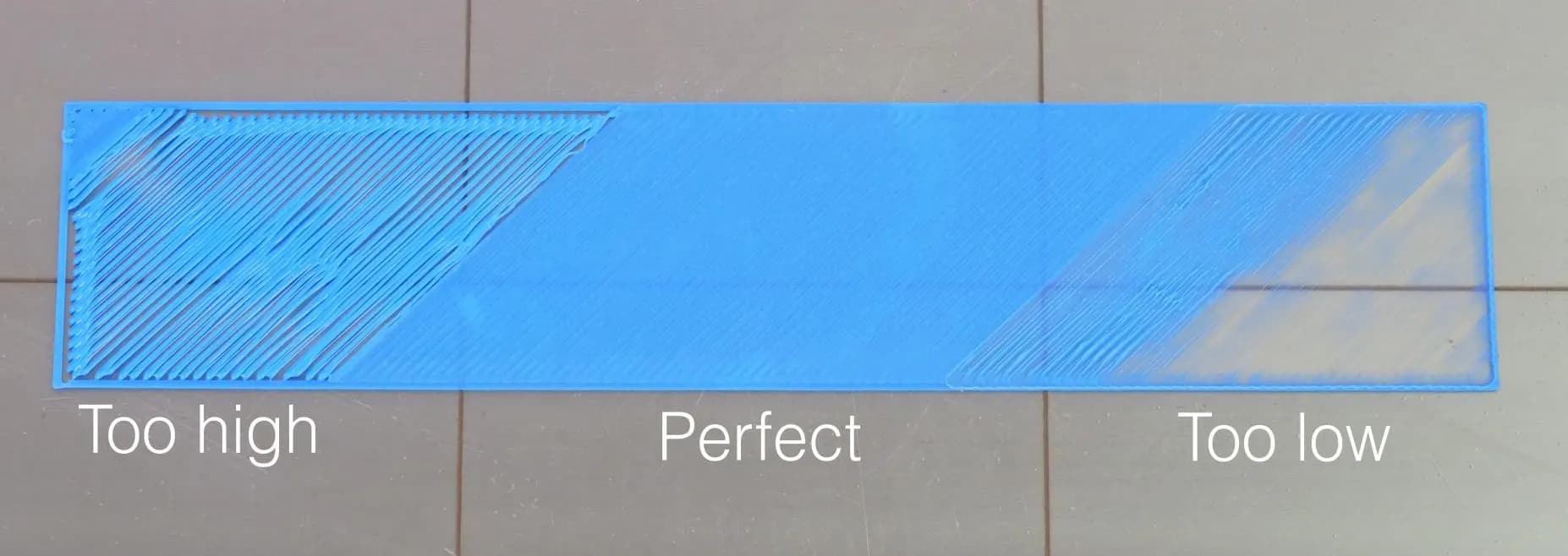

Hi!
Your printer may need some adjustments and calibration. Please check the following video:
Service Tutorial Ender 3 V3 KE First layer non stick solution
The other reason could be the z-offset is too big. You can adjust it dynamically while the printer is doing first layer. Here you can see how the good first layer should look:
You can manipulate the first layer look by adjusting z-offset as I said before.
Let me know if it works for you!
