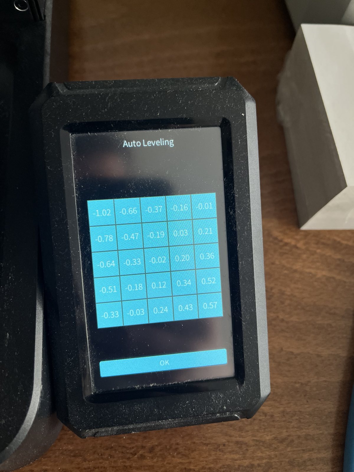

My Ender 3V3 Ke startet to work poorly. The problem is that the first leyer is not sticking to print bed, and the nest is build around the nozzle. I have tryed to: clean the bed, change the nozzle, tight the screws that hold the bed, and do automatic z level in the printer settings. After that i still have the problem. Same program was working fine month ago, and now not. Here is the picture after automatic z level offset. Can someone help me solve this problem. Many thanks.
The autolevel isn’t always quite there and you need to adjust the z-offset a little manually to get the filament to best stick to the bed. A range of 1.6 on the bed is a little high but the autolevelling software should be able to cope with that.

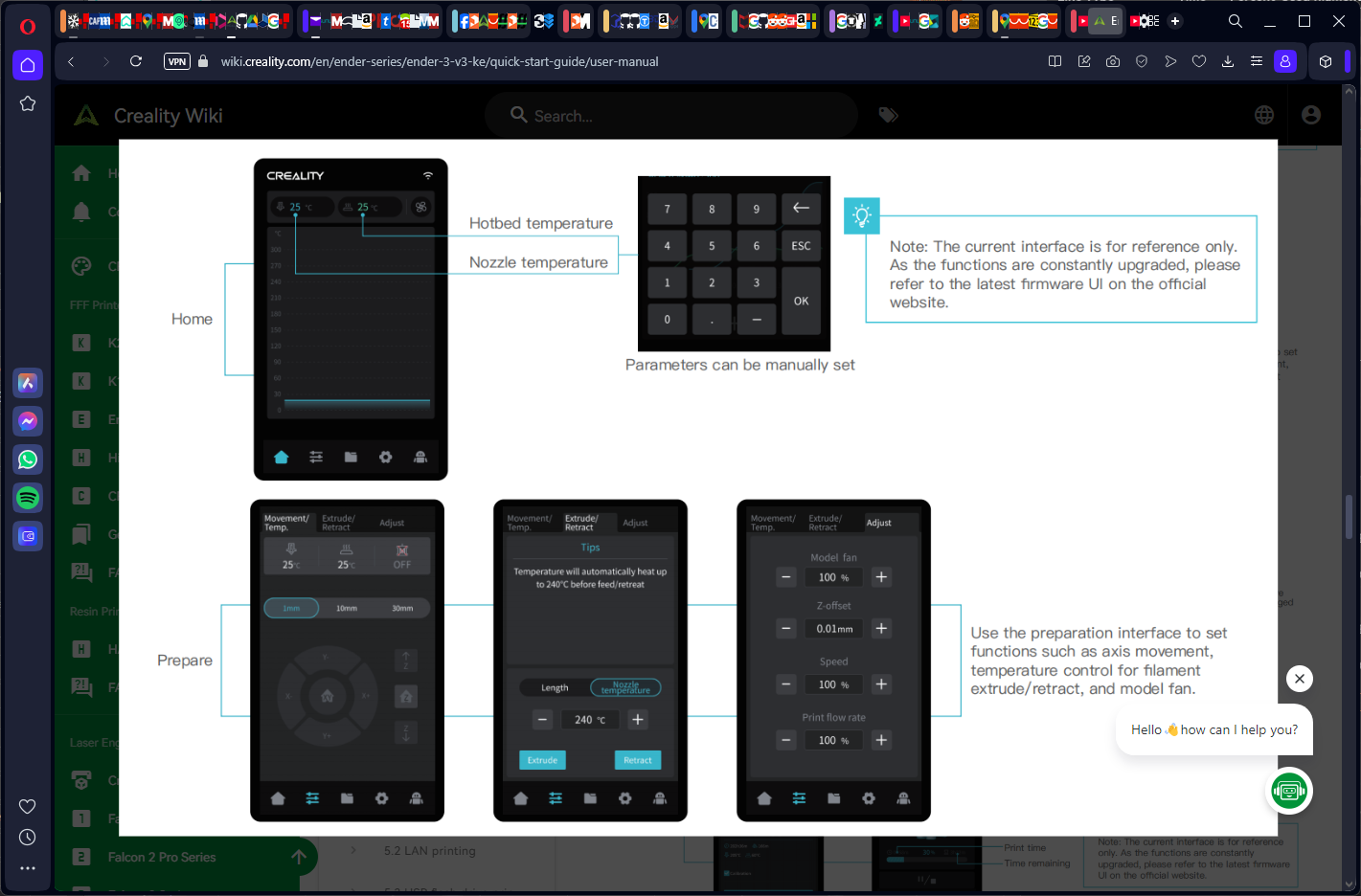

See the bottom righthand image, under the adjust menu you can adjust the z-offset until you get a good adhesion to the first layer. Once I have done this I turn off autocalibrate for every print as it resets my newly tuned z-offset. Try printing a large square area 1 layer thick and adjust the z-offset on that.
