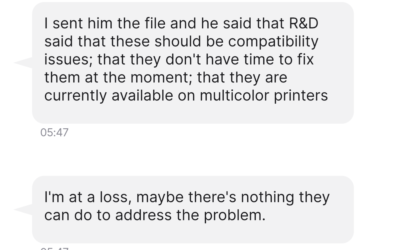

Search on github. But there is more problems. I’m trying to return printer and make a refund. Printer is too bugged, and as creality after sales manager said me, they don’t have a time right now to solve them because they are focused on multi color printers.
Isn’t THAT re assuring to customers !
Saying that they won’t fix any problems of this printer because they have more expensive printer that they have to deal with?
