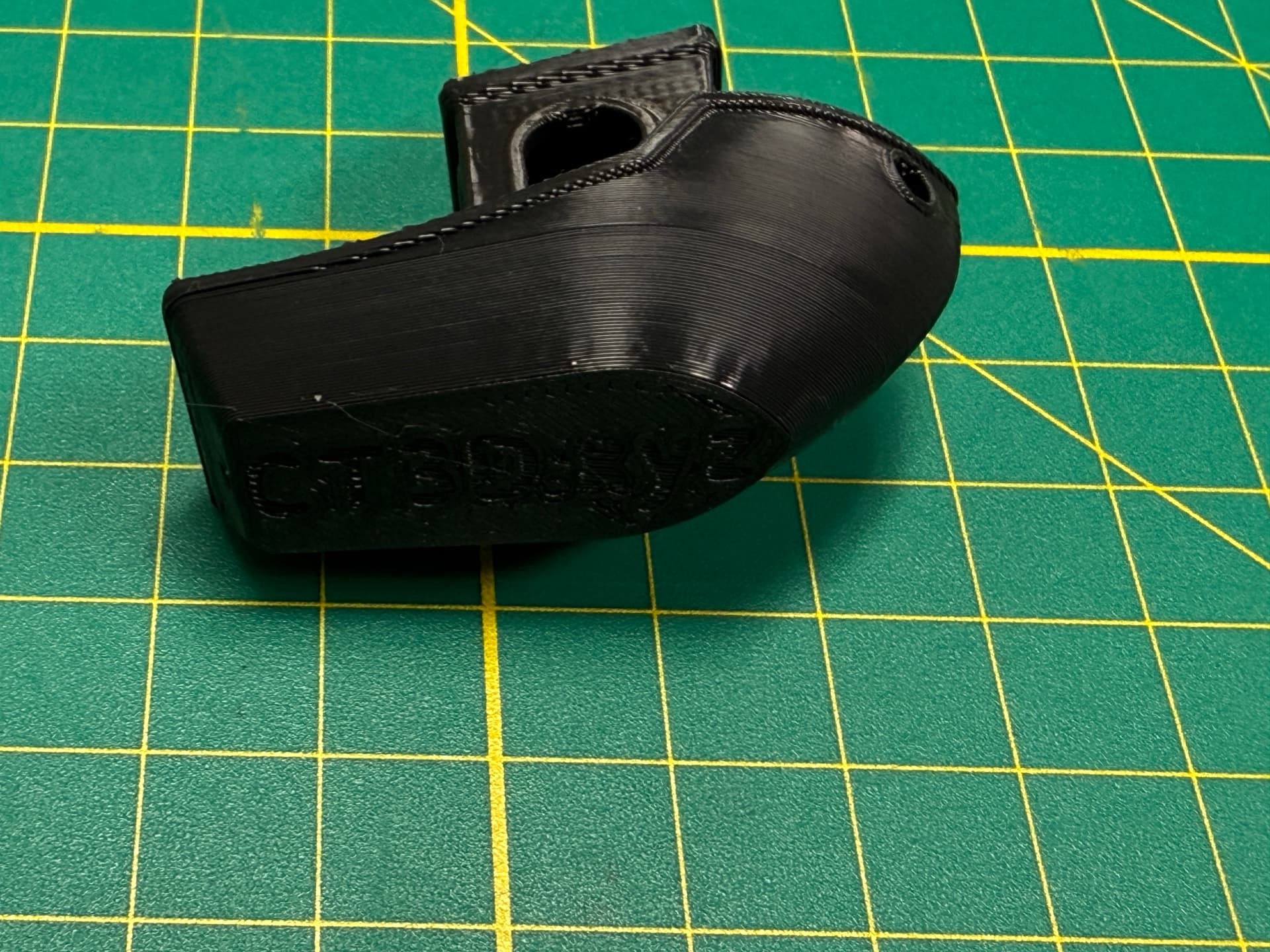

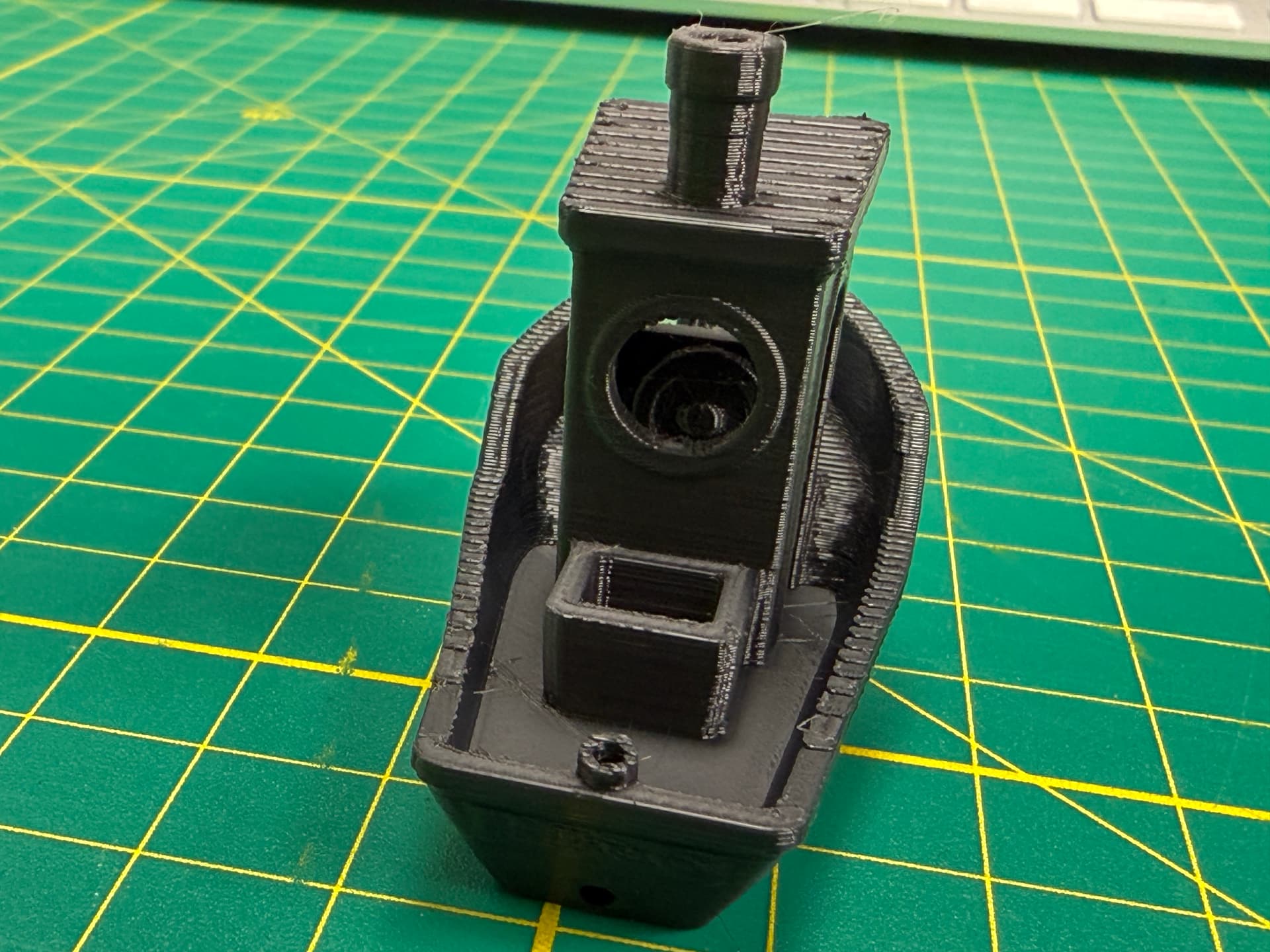

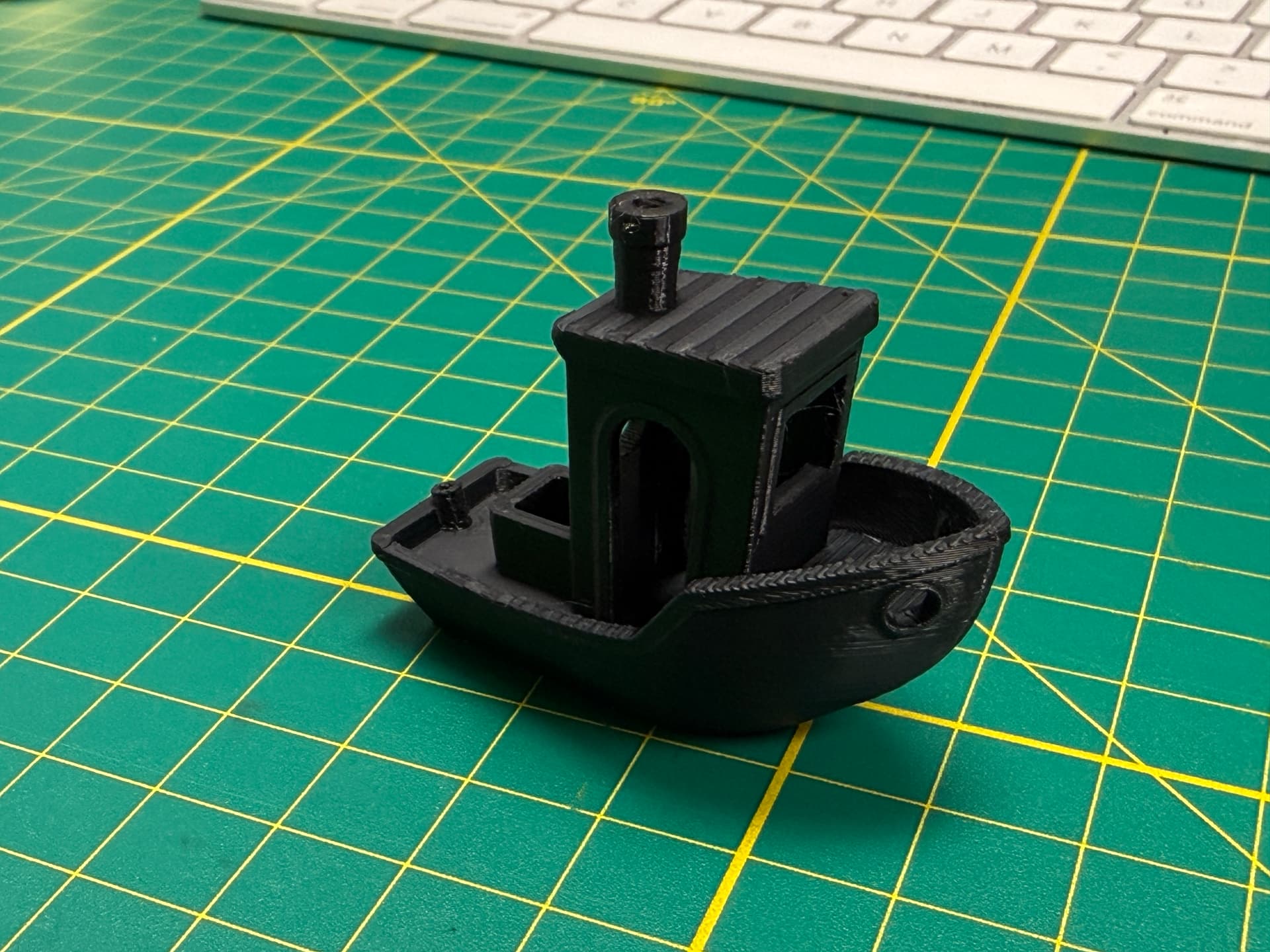

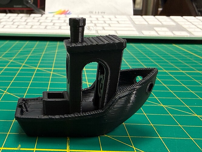

I spoke to support at MicroSwiss and they told me that the MK8 is not compatible since it’s too short. I’m going to give it a shot and just recalibrate.

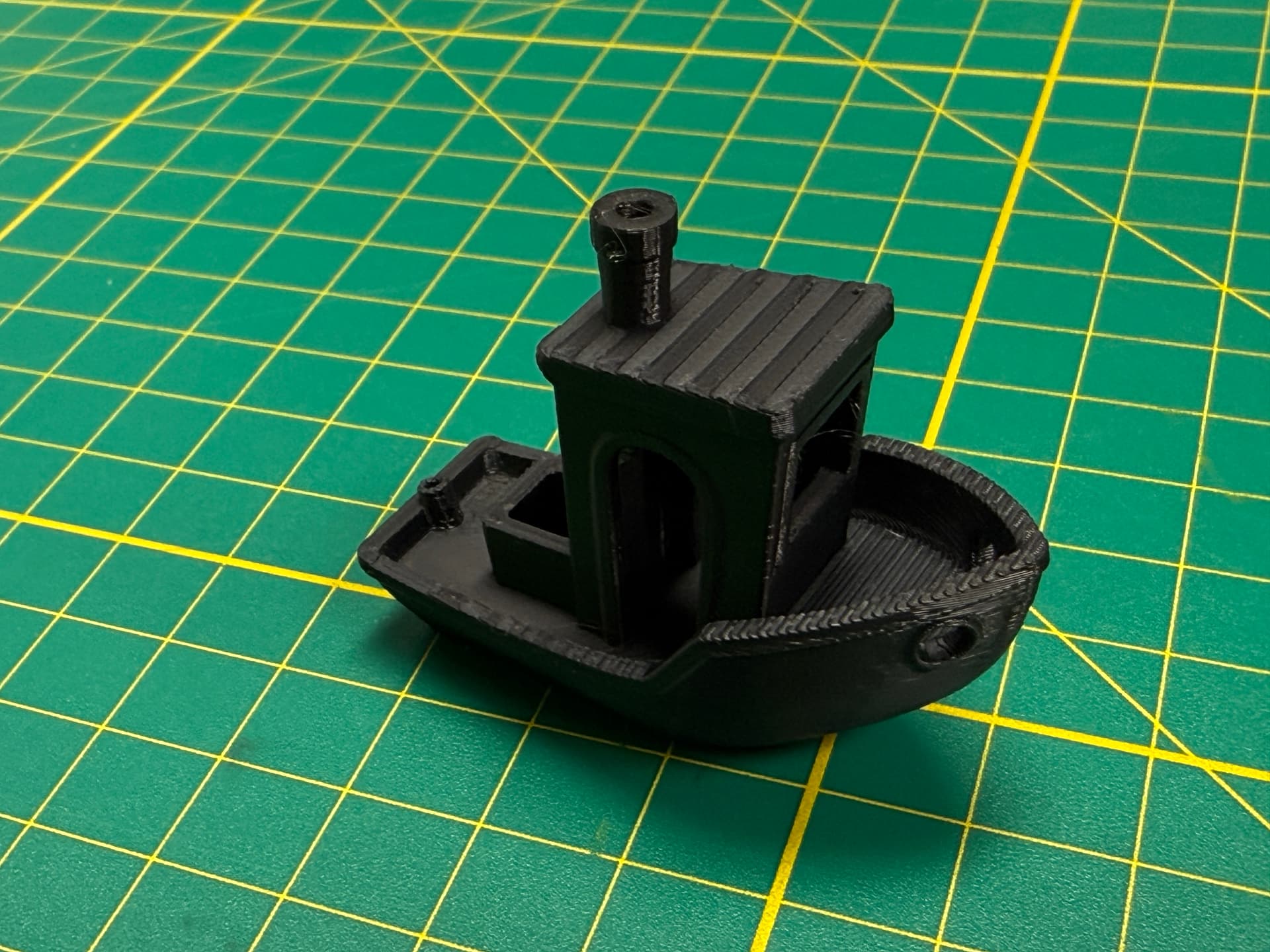

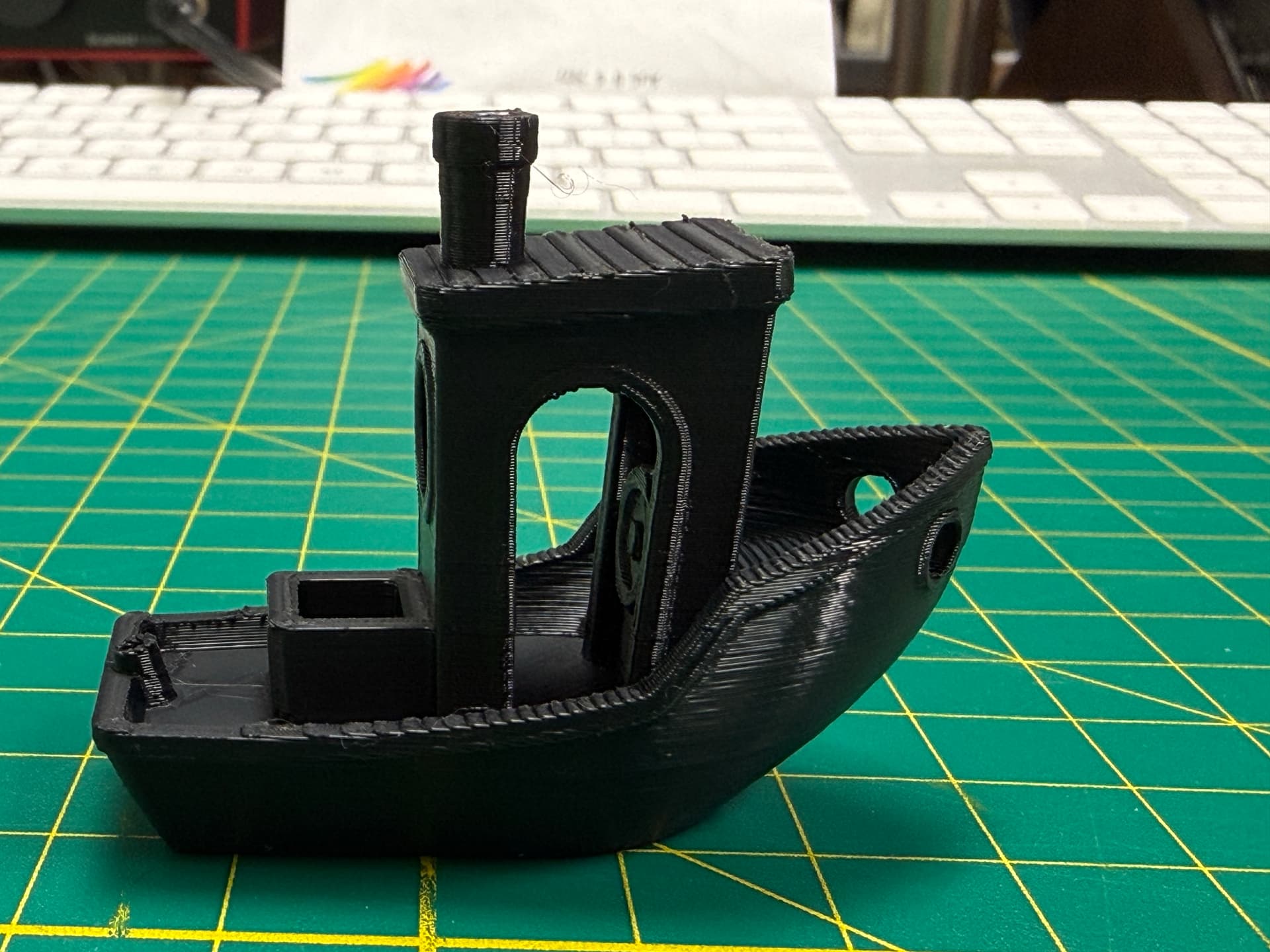

I guess I got a good one. Here is my Benchy straight off the bed
The only thing I tuned was I the Z offset since it was way off from my futzing about trying to make the HI hotend work.
