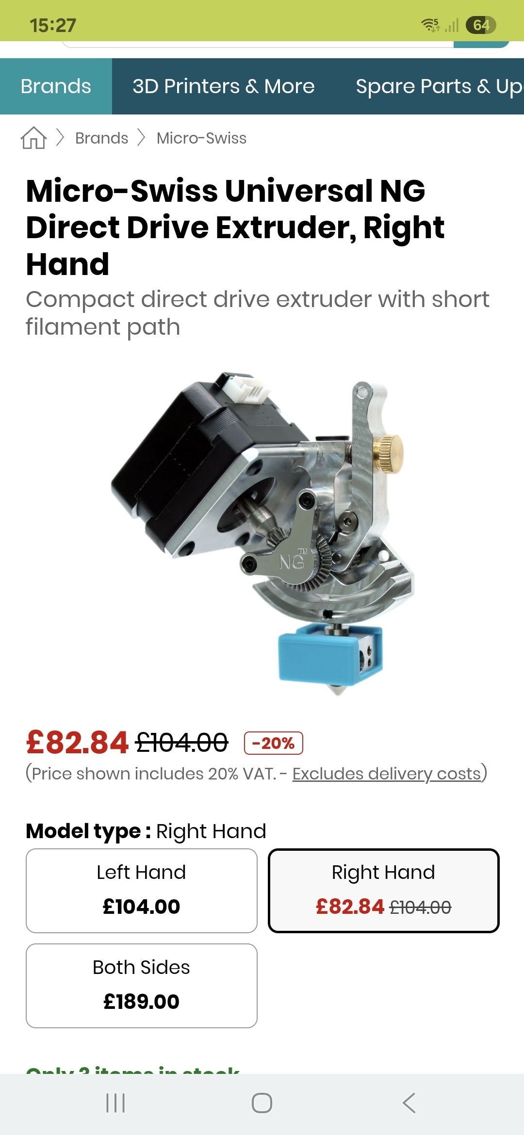

My Ender5plus has the Microswiss NG, but they seem to be marmite in the community, some love them, some hate them. Probably jinx it now but it has been mostly trouble free…I shall prepare for blob of death when I am not looking.
Sorry for all the questions. Is this the correct one?
Would i need to do anything else to the printer? Or is it just swap that parts then print?
Many thanks
That is the one I have. It is a fairly straight forward swap, decent instructions included. Have to print a couple of things first here this version reuses the heater, thermistor and fans from the existing loom. link to the esteps settings, if you are running Klipper the rotation distance is 7.53
Thats the hard part my printer wont print lol. Going to try and print them before ordering. The 3d printing gods my look down on my haha
Got a spare PETG version if you want, I have replaced mine with an ABS version. DM me, guessing we are both in the UK.
