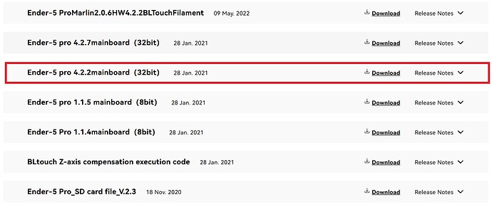

I believe that there is 2 variants of motherboard for the Ender 5 Pro. Ideally you need to access the mainboard and check the black chip near the version number on the board. The chip will have some text on it and depending on which chip you have will depend on which firmware you will need to use.
Once you have checked to see if you have a STM chip or a GD chip we will be able to point you in the right direction to the correct firmware that should work with your machine.
Hi Nikoli, I have the STM chip, already had checked that info, just forgot to specify it.
Hi @Oblikfan thanks for confirming the chip labeling.

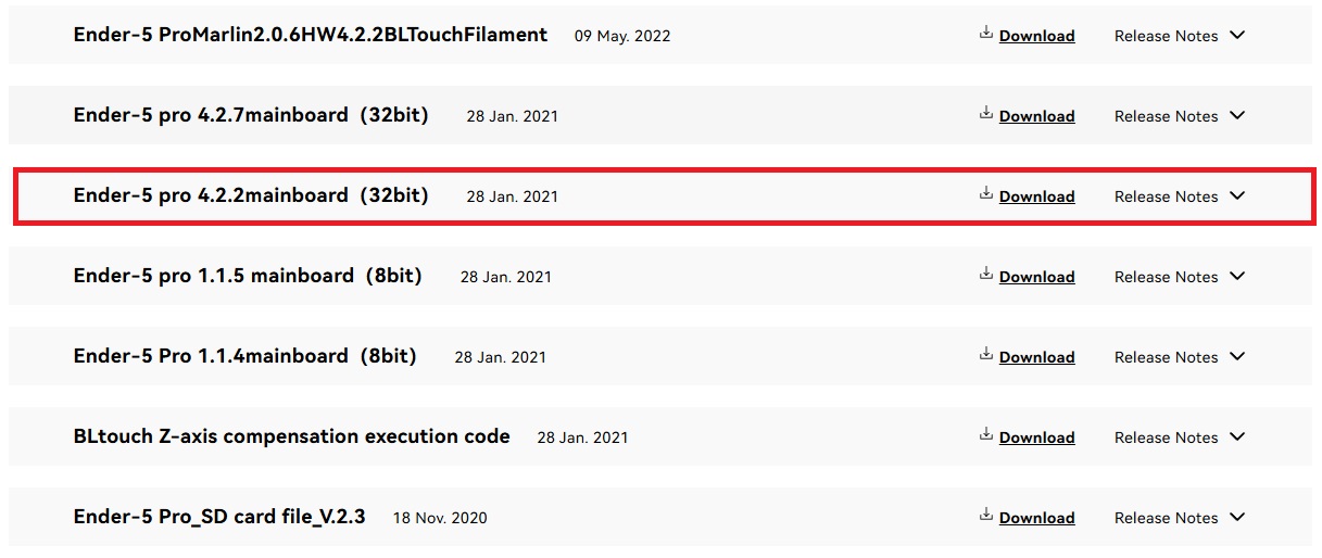

Assuming your board is a v4.2.2 variant you will want to use the Ender-5 ProMarlin2.0.6HW4.2.2BLTouch firmware dated 29 Nov. 2022. Here is a screenshot to show specifically which one that should be in the firmwares list…

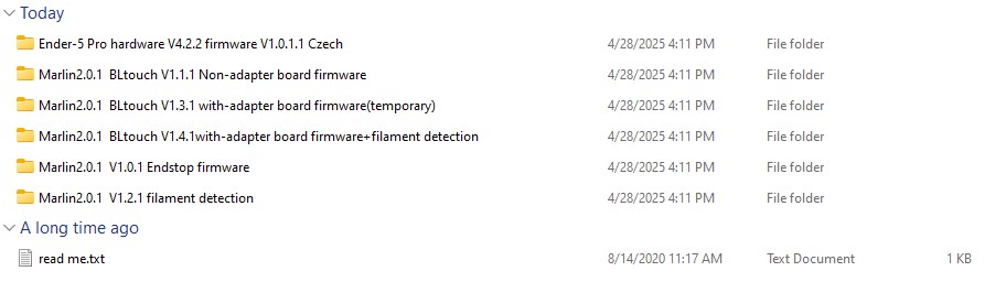

I’m Sorry if this is late, gents, but I ran into this problem, one year later, and found the solution. Yes, the Ender-5 ProMarlin2.0.1 - V1.1.1 BLTouch does work, and here is how to find it.
Unzip and download the appropriate version you need. In our case, or at least for me, it was the Marlin2.0.1 BLtouch V1.1.1 Non-adapter board firmware.
