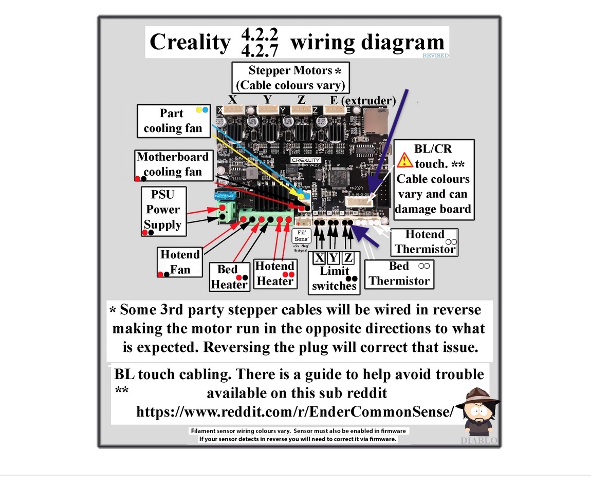

Enderr 5 plus motherboard upgrade from 2.2 to 4.2.2
I am hoping somone can assit. I received a new motherboard from Creality.. I have installed this and tired to get it to work. My questions are as follow.
  1. The BLTouch Z stop it is connected to the 5 pin on the board or the 2 pin Z limit.
  2. Which firmware should be installed?
All works, except the autolevel function. I have tried putting the BLTouch Z limit in both locations with no difference in function. I have contected Creality but the support is slow.
I have included an image where the blue arrows point to the locations of the BL Tough Z sensor location.
