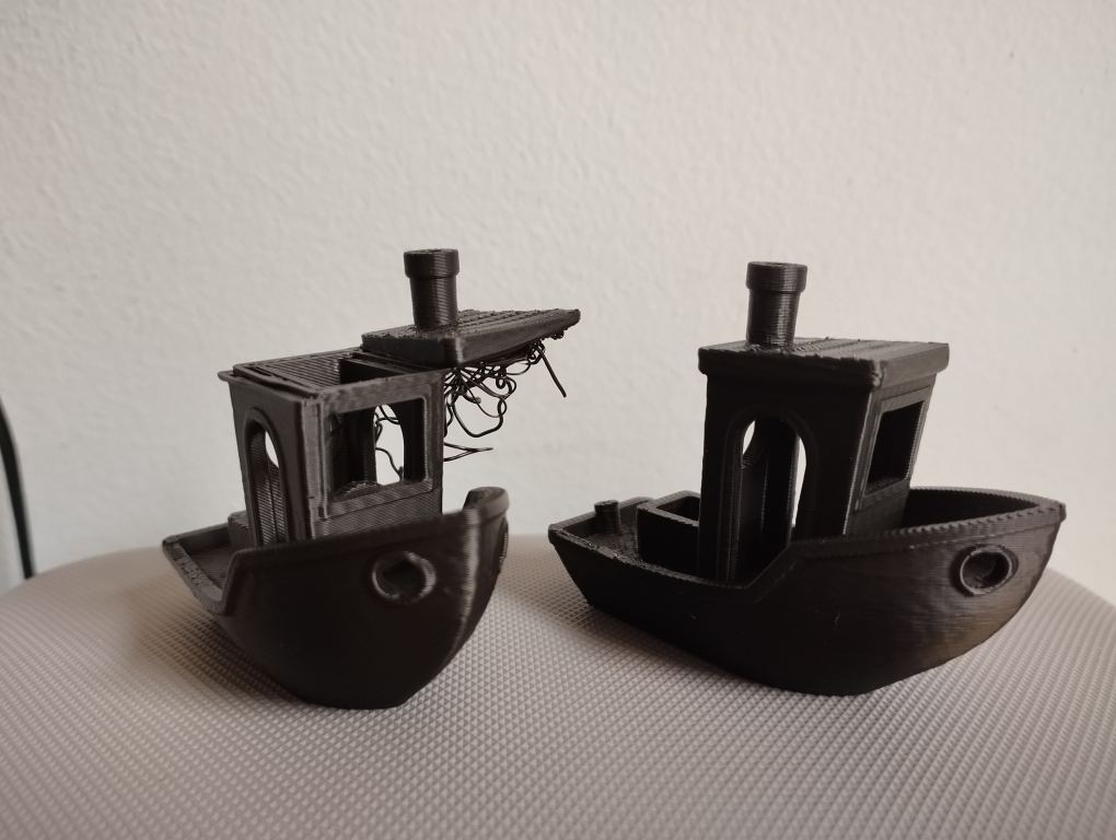

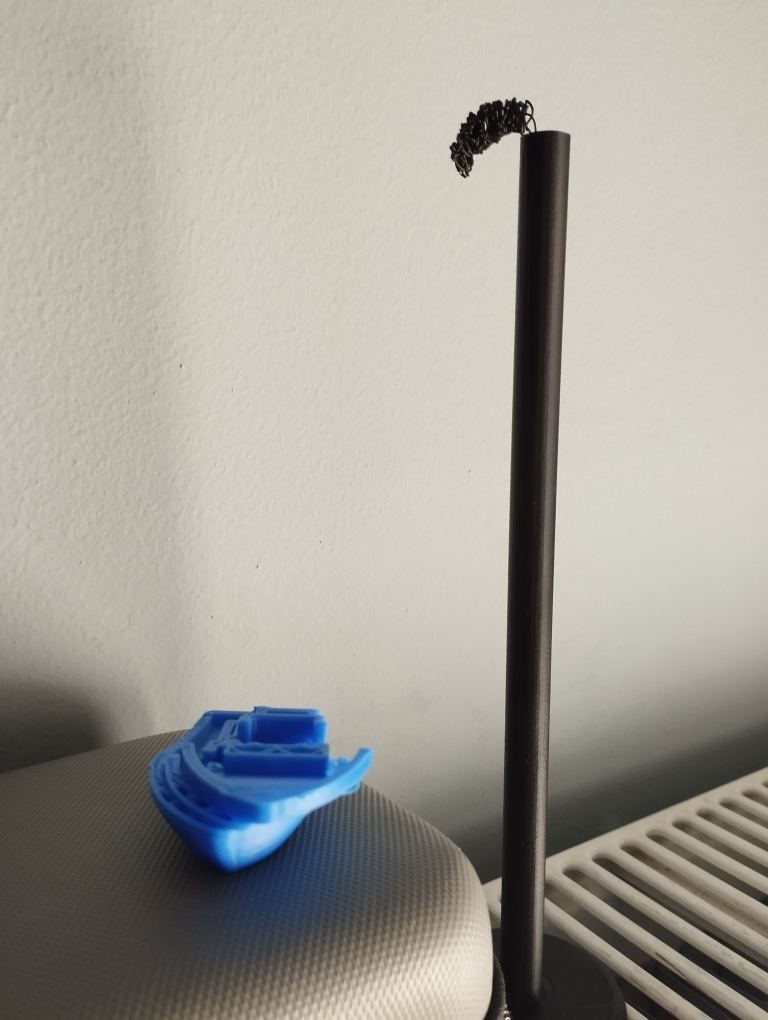

I have Creality Hi, after starting it I started printing what was on the printer by default (waste container and speed test print) everything came out ok. Then from CrealityPrint6.1 I selected a test print of the cube and the ship. Neither of them came out correctly and ended with the cm2789 error. No matter what I download and send to print, everything ends incorrectly. Only the default prints come out ok. Can anyone help?
A small update to the topic.

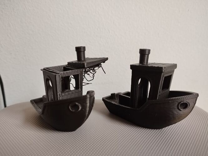

On the left, Benchy cut and sent to print on CrealityPrint v6.1 and on the right, the same project cut and sent to print on CrealityPrint v5.1.7.
When this broken print on the left ended, the hotbed moved forward rapidly until you could hear the y-axis belt jumping on the stepper motor gear, and after clicking OK, the printer screen displayed the message CM2789 Abnormal resistance in the y-axis movement direction motor released. Fix issue and restart.
In the case of print cut and send on CrealityPrint v5.1.7 , the one on the right side of the photo, there was no such strange behavior.
Also, the same project cut and sent to print by OrcaSlicer v2.3.0 ends with failure.
Default models for printing placed by Creality on the machine come out perfectly, after downloading the gcode of these prints I read in the header that they were cut in CrealityPrint v5.1.7

Have you tried to calibrate the cutter? And is the video camera cover installed properly? Calibration is in the settings, self-check. And if that doesn’t help, do a full reset. That helped me.
I tried all things from creality wiki. None of thees helped. I reset printer to factory default couple of times and even one time get axis x error when performing self test and calibration at start afters reset. Finaly still ended with axis y error. Creality tech support don’t even emailed to me after i chat with online support and make ticket request. Finaly i send back printer and get refund. Before i have Ender3 V3 SE with some tunign. I want to buy something bether, newer and multi color and Creality Hi was a total failure. I don’t have time to deal with manufacturer mistakes.
the same
looks like he didn’t see cutter sensor when executing cutter calibration and push cutter several times increasing torque, but on fifth movement it is too high and motor lost steps, then motor driver turns off, but mashine continue shaping
don’t use cutter calibration, and it work normally, may be it is firmware fail and hope it will be repaired
