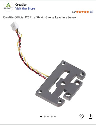

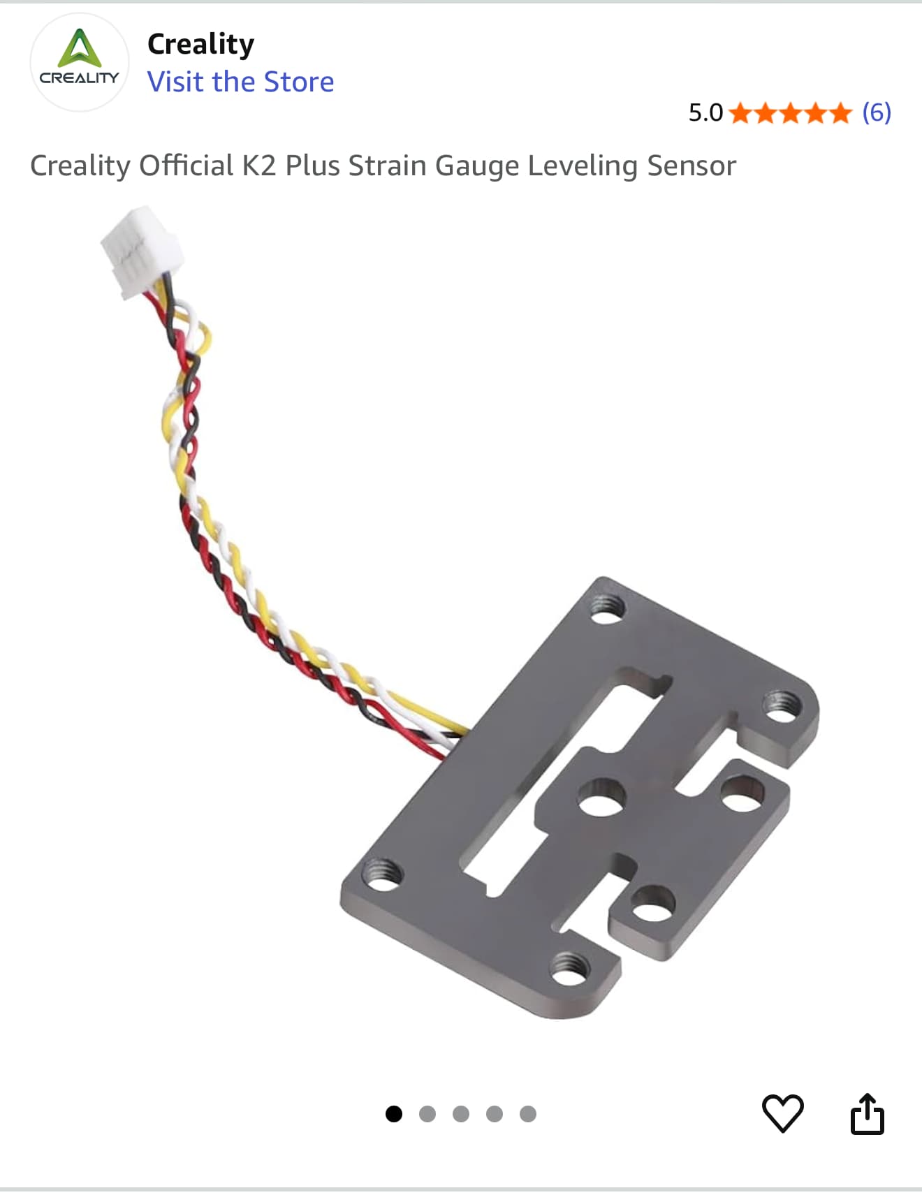

See my response below. Replaced the strain leveling sensor.
I had the CM2798. I replaced the strain leveling sensor and fixed my issue. Video link below on the procedure. It was a $10 US part on Amazon and took about 20 mins to replace.
Hope this helps.
