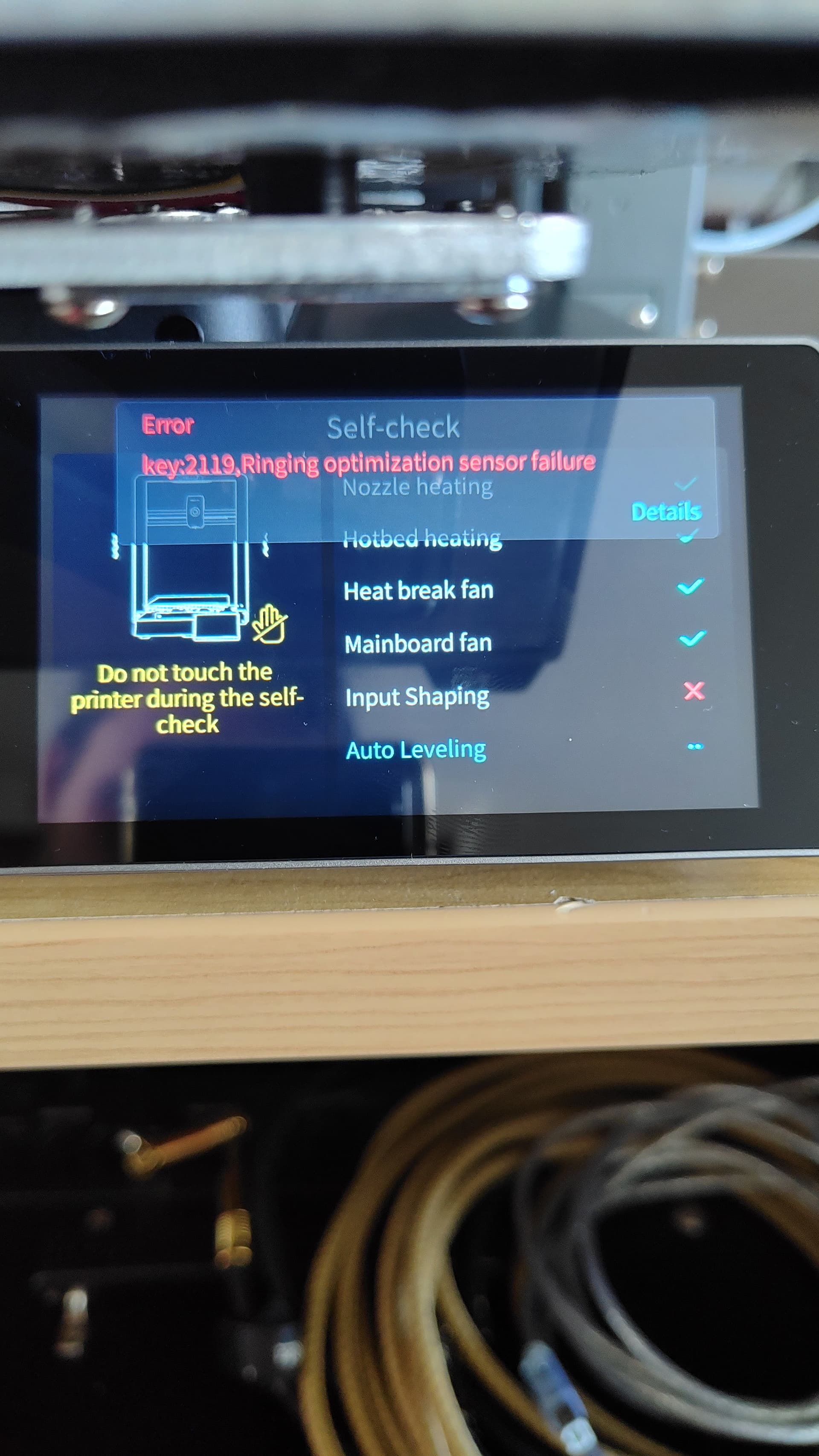

Error key:2119 l, Ringing optimisation sensor failure
Hey all, I am setting up this Ender 3 v3 plus and I keep getting this Error key:2199 everytime I try and do the input shaping I have tried factory resetting and I have check the wire harness connector that you need to connect to the print head.
I can’t seem to find any information on this anywhere, does anybody have any troubleshooting steps I can try?
Thanks,
Sound like you need new toolhead board PCB.
4004010253
Thanks for that Barry. Thankfully I think I may have just fixed it. The latest firmware available on the v3 plus is way out of date. I managed to find the latest version on the standard size printers page. After I flashed it with that version of the firmware it appears to have fixed it!
