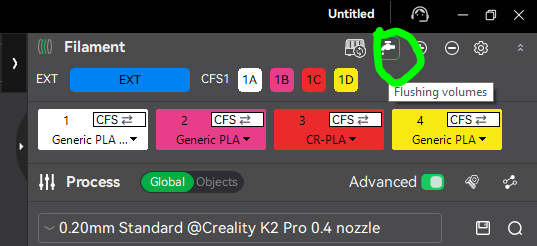

I really appreciate the tip. Where do I find this? on the printer or in the Creality Print Software?
Hello @Israel_Fernandes & @ElCid :wave:
In Creality Print:
Click on the faucet icon.

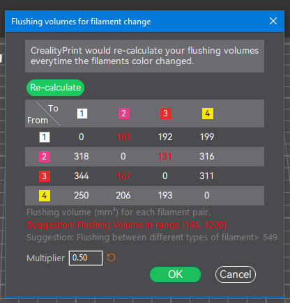

This little chart will pop up. You can change most of the numbers. Be careful, because if you don’t flush enough the colors might bleed. For example, it takes more to flush going from a darker color to a lighter one.
Thank you so much. That helped a lot!
