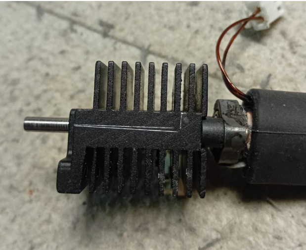

The heatsink is too small, and the fan does not cool it down enough.
Printing PETG I have to run the Model Fan at around 70% continuous, Not to cool the part down, but to cool the filament fed to the nozzle down.
If the Model Fan is not on or below 40%, heat creeps up and the filament gets soft and makes a lump just below the feeder gears and filament is not fed into the nozzle.
If the heatsink is larger and the fan blows sufficient air, this will not happen. The fan can be thicker which increase air volume.
I would also suggest the heatsink is split in two so that the heatsink physically is clamping on the copper ring of the nozzle to transfer heat more efficiently to the heatsink.
A larger heatsink consisting of a front and rear part that can split in two - there is enough space. One can always print another larger print head cover.
This will also allow a better way to apply heat paste. Heat paste dries out after a while, and is not really suitable to fill gaps between surfaces for cooling. You want physical contact between surfaces with heat paste.

The heatsink should clamp the copper ring. If you want to cool power devices they have to be mechanically pressed against the cooling surface, they cannot be simply connected thermally with thermal paste.
If the heatsink front is spit from the rear and the nozzle is clamped by the two screws, you will have to loosen these screws a few turns and then unscrew the nozzle. If you screw the nozzle back in, you will have to tighten the heatsink screws to clamp on the copper ring.
As is, there is no way to determine if the nozzle top is actually cooled and cooled enough.
The heatsink remains cold enough to the touch, but I get that the filament is melted almost to the top inside the nozzle. This can only mean the heatsink is not cooling the nozzle enough.
I have checked the play inside the heatsink with the nozzle’s copper ring, There is a little play and could be the source of the problem.
I don’t know if someone here with a waterjet cutter or laser can cut the heatsink. If cut on the silver line the bottom part can still screw in and the front part can clamp the copper ring. The short line should face the other way, ie towards the front.
