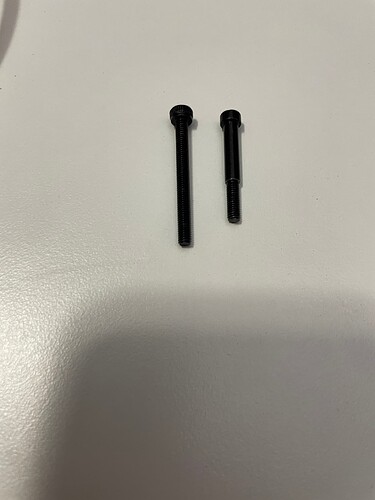

The screw on the left is the new M3-30 screw and the screw on the right is one of the original screws. All three of the original screws are different lengths, but you can use the M3-30 for the longer screws, and just use the short screw (you’ll see what I mean when you remove the extruder cover). I was concerned that the new screws would bottom out, but they didn’t and seemed to fit snugly.

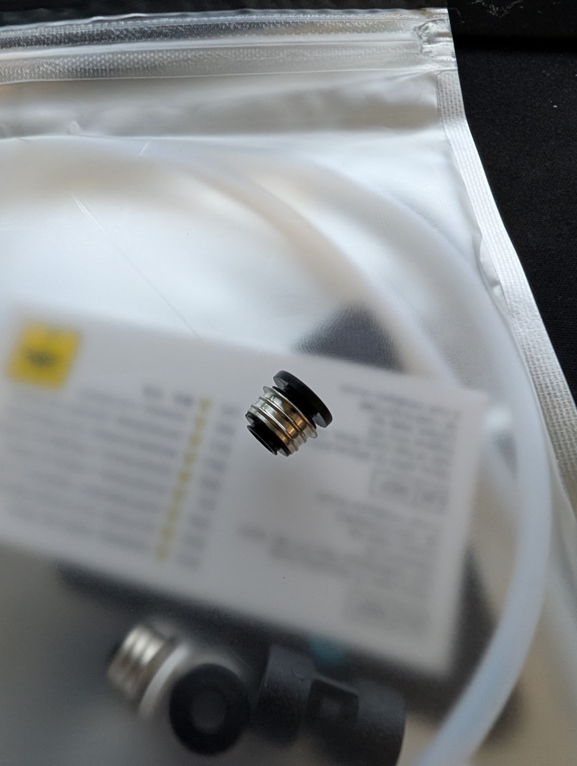

Here are the couplers I used. I picked up a 10 pack from Amazon for about $8.
The new coupler fits perfectly. It threads in tightly but with some pliers and a slight effort, it’ll thread all the way down.

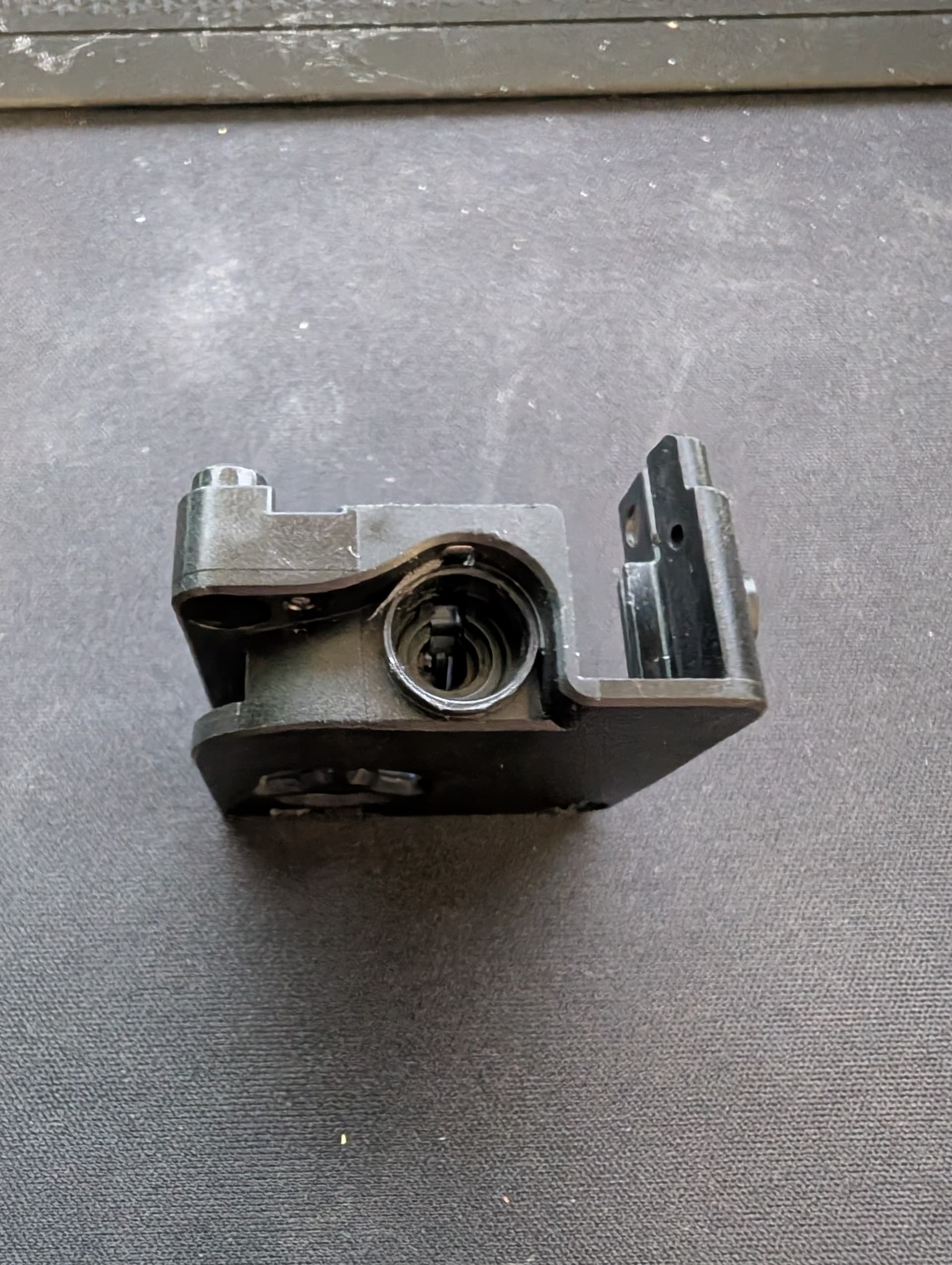

When fitting the new adapter over the extruder cover, make sure to seat the standoffs into the original screw setback holes. Also when attaching the entire assembly back onto the extruder head, double check that everything is properly seated.
When inserting the bowden tube into the new coupler, I made sure to slide it all the way down as far as possible into and past the original (broken) coupler. This amounted to about 40-45mm or perhaps even more and allows the filament to bypass all this mess when printing.
Final assembly involves threading in the M3-30 screws, and the third screw on the side.
I was concerned about this doing this at first, but after printing with it, I’m sure this is as solid a solution as any other. This keeps my printer working until the replacements arrive.

So since i have 2 broken extruder covers i decided to try and see if i could remove the broken connector from one of them , I use some needle nose pliers and was able to pull it right out
I happened to have the K2 plus connector kit that i ordered and noticed that the connectors in that kit are the same as the connector i pullled out of the extruder cover
https://store.creality.com/collections/accessories/products/k2-plus-connector-kit?spm=..collection_cc8cf8b4-3da1-49c7-bc32-dd0e246caef8.collection_custom_1.6&spm_prev=..index.header_1.1
I was able to press in a new connector into the extruder cover and its been printing just fine
